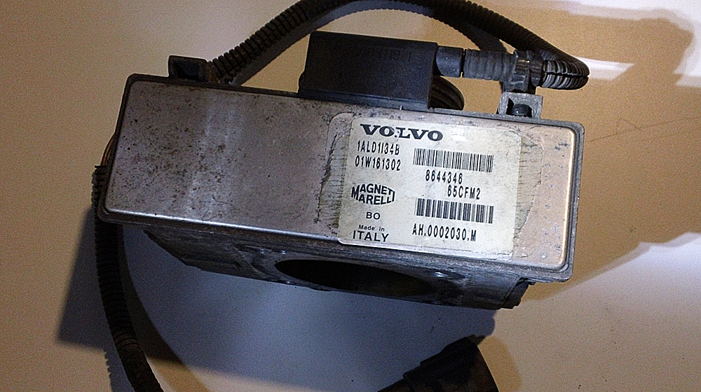

Post by xHeart »
The replacement ETM is yellow label.
The original white label was replaced a while ago with 146,000 miles on it -- but wasn't among the affected PN.

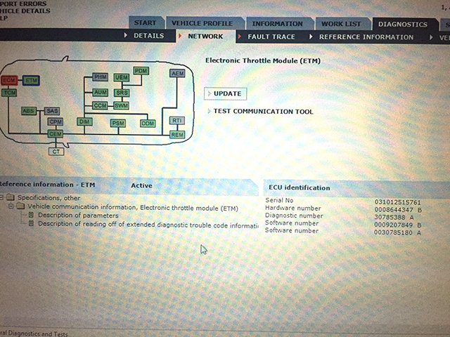

ETM profile:

That's the latest software, xHeart. Your car won't go into limp mode. Also if you need to purchase a new throttle you can go for Volvo part number 36050563 and usually (95% chance) it will have this version of software pre-installed.
You'll notice on the report that your hardware number is actually 8644347 so is amongst the affected numbers; no-Magnetti product is exempt here.
Look in Communication-ETM- Throttle angle sensor 1 and throttle angle sensor 2 to see reported angles.
Also you can do ETM sweep test in Communication-ETM-Advanced
