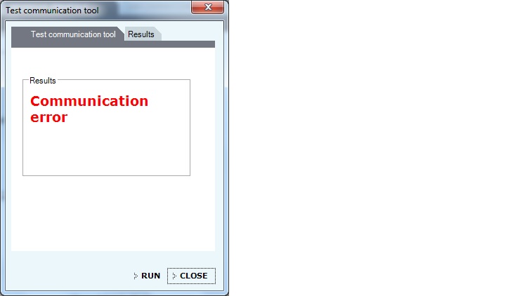

Following two comments added a boost to find a fix. cn90 says winners don't quit and quitters don't win. So there I go again.
DiCE Diagnostic and VIDA 2014D are working independent of each other.
For VIDA to read vehicle, it needs to pass communication test with DICE, log says, PassThruSupport function failed. Looking through the Registry, following feels out of order.
- HKEY_LOCAL_MACHINE\SOFTWARE\PassThruSupport.04.04 - w/o SETEK AB driver for DiCE 209510
- HKEY_LOCAL_MACHINE\SOFTWARE\Wow6432Node\PassThruSupport.04.04 - with SETEK AB driver for DiCE 209510

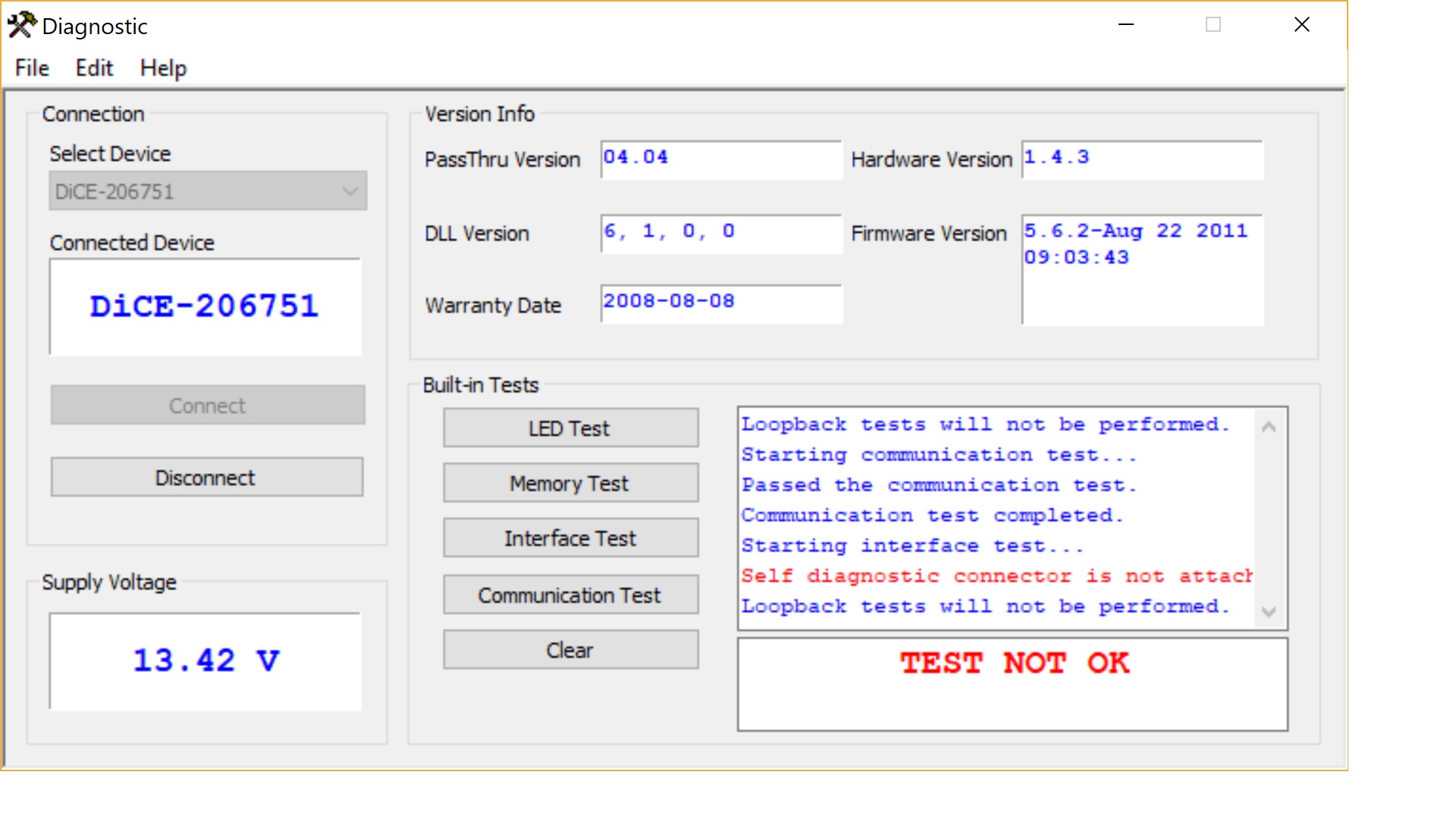

Unless otherwise said this appears to be x64 Diagnostic, please confirm?JoseBQ wrote: 10 Feb 2019, 05:41 Hello!
I followed the instructions (or so I thought), and got the following message in DICE Diagnosis when running interface test:
"Self diagnostic connector is not attached".
Does anyone know what's the matter?
I believe, Self diagnostic is small device that comes with Volvo DiCE original, not clone. If your VIDA<->DiCE communication passes "OK" than you are good to go JoseBQ.

Do you mean that dice works perfectly even if it doesn't pass the interface test?xHeart wrote: 10 Feb 2019, 09:19Unless otherwise said this appears to be x64 Diagnostic, please confirm?JoseBQ wrote: 10 Feb 2019, 05:41 Hello!
If that's the case, VIDA doesn't show any communication tool... It shows an "X" where there was supposed to be the dice unit to select.
I changed the register in Windows as supposed but it continues not working... I'm getting desperate...
