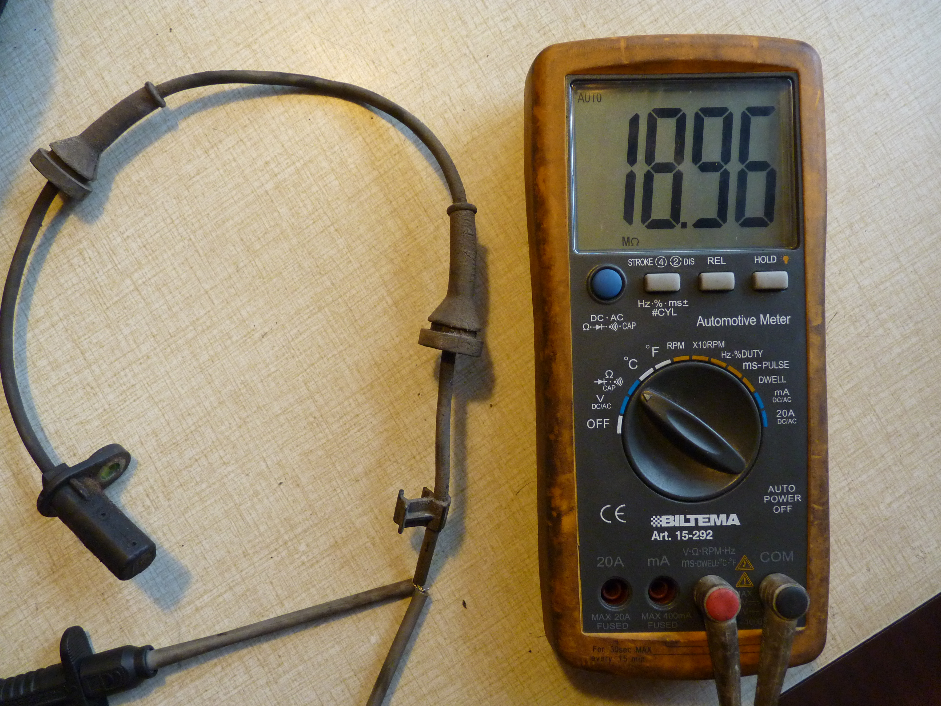

Yes - unplugged - both left and right.wizechatmgr wrote: 09 Feb 2019, 17:59 I am unsure the desired value of the ABS sensors over the harness but I'm rather sure you have a problem there. Shouldn't be in the mega ohms range. Shouldn't be more than maybe a couple more ohms than the sensors themselves are total.
These were checked with ABS module unplugged, correct?
And with a correct cabel connector (I have a whole kit with connectors so they fit properly).
He bought a new one for a later model - and when we found that out - we bought the correct sensor.
But they are both the same, it showed.
He changed the original sensor without testing it first, unfortunatelly, so here are the measurements for those two, at my kitchen table (litte wormer than out and the original cut out from the car):

Unless something is wrong with your multimeter, I believe both original sensors you just tested are bad and possibly the replacements.
I wonder if Matty Moo (Midwest ABS) can verify the sensor resistance here for your particular vehicle from what he's seen. I believe it to typically be ~900-1300 ohms.

Something is up with those OHM readings but I wouldn't concentrate on those at all.
LF always pops up with a faulty module, you'll get a faulty signal then signal missing codes, 0010 and 0011. You will never get a 0012 with a faulty module and the only time I have seen that code is with an aftermarket sensor. I have no written knowledge on why the 0012 populates or what readings cause it, only personal experience. There's no published information on it. The only reason I know that is by prodding people when they send back a core and say they still have issues, I then scan it and ask questions. The variable with that code has always been a bad/aftermarket sensor. I don't know which aftermarket sensors will work, I've just learned to avoid all of them.
At this point with the age of the cars the only reason I tell people to take an ohm reading on sensors through the length of the harness is only to show continuity since the actual sensors rarely go bad but the wiring going to them does.
