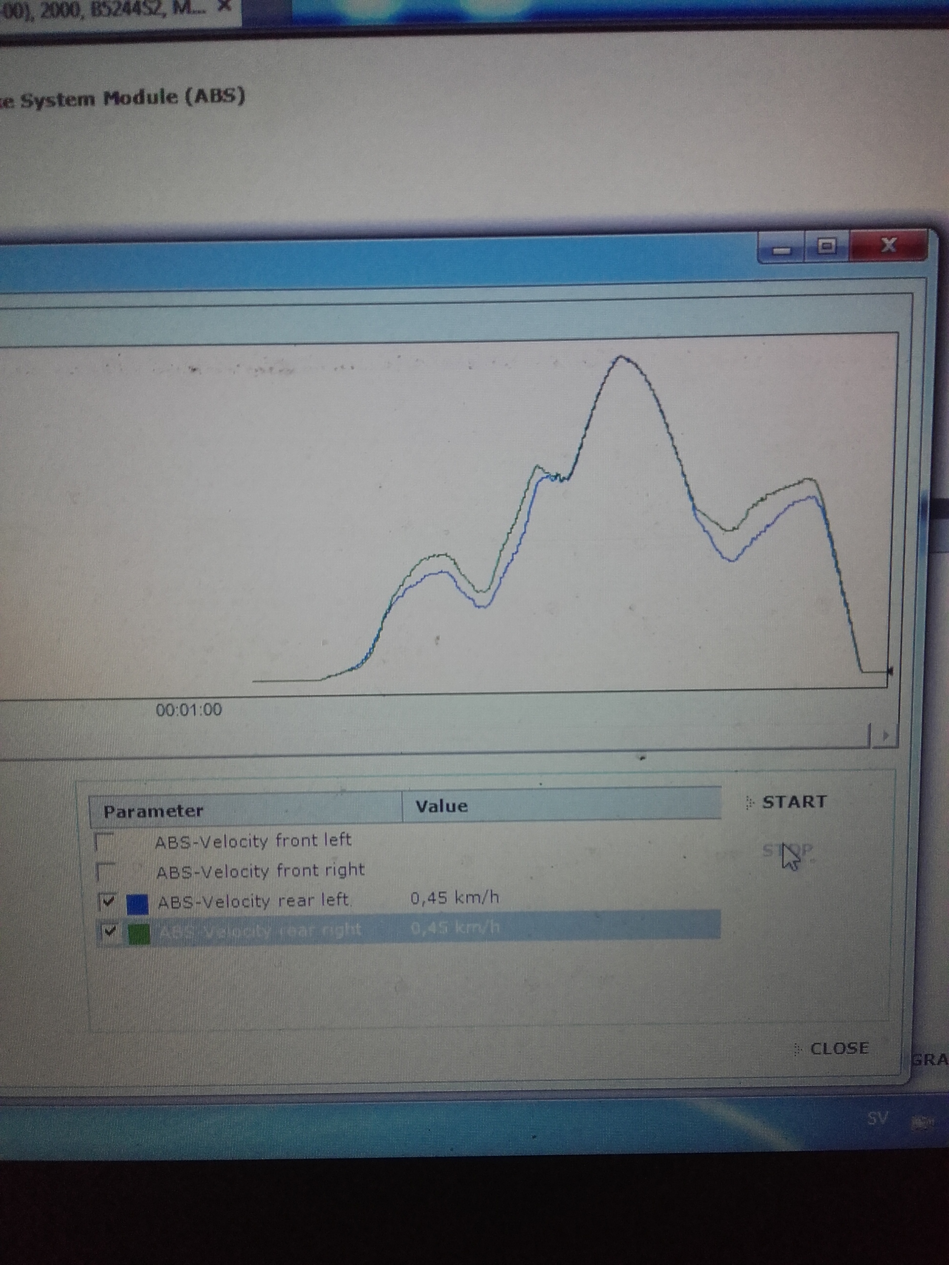

In the same time - measured Velosity with VIDA gived first time this result on left/right front sensors (he had changed the snesor first time) - scale different from the other measruing times:
Here is the same measure of front sensors "Velosity", speed, after changing also the tone ring AND the box (the repaired box from the pictures before):
Here is the rear sensors with the same box as above:
Best to take the oscilloscope out and see that the tone ring is behaving ok.

Those downward spikes are crap being stuck in these sensor or tone ring, or maybe even the ring hitting the sensor, which will kill it. Take it out and look for scuffing. You can also swap the sensor and see if the scope trace moves

But - I checked with the scope at the ABS box connector and at the left sensor connector and the results are the same as in VIDA. Exactly the same.
We jacked the front up and hubby "drove".
There is battery voltage at the connectors.
We thought to check if there was some wire loos/crack - that showed only during load.
So tomorrow Im taking the wheel and hub off to check.
Here are some readings from before.
Im not too familiar yet with the scope so you have to excuse me for the strange look for the waves =)
Measured at the ABS box:
Measured at the sensor connector:

And I notised the zigzag patern from the VIDA scope was inverted, the first time.
Below picture is from that time, with a sensor for V70 II (perhaps 0,5 mm longer than the old one) and the old tone ring that damaged the original sensor - "standing" zigzag:
Below picture is from the time with the new tone ring beeing too far in on the CV joint, so sensor (right sensor this time) and tone ring dont have proper contact - "hanging" zigzag:
Sorry for the scales beeing different above - Im learning how to use things =)
