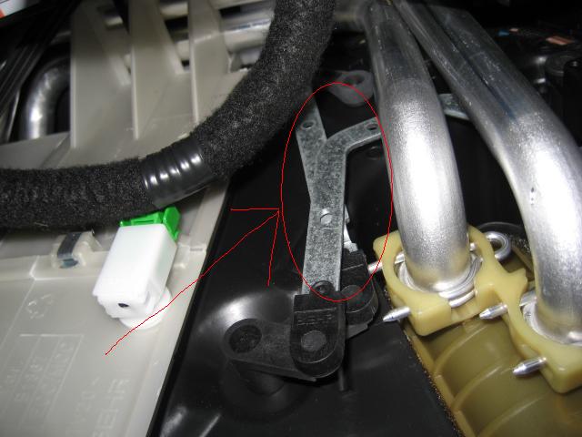

I wonder when they replaced the core if they disconnected the little linkages that open/close the blend doors and didn't get them reconnected properly. Then when you hit the pot hole one of them jarred loose???tboothe33 wrote: 13 Feb 2019, 10:34 I had the heater core replaced in 2017. Well, wouldn't you know, I hit a pothole 2 weeks ago, and the heat went out again. Since my heater core is relatively new, is there something that could have come loose when I hit the pothole? It worked fine before I hit it.
They're the two flat metal "arms" in this photo:
download/file.php?id=3384
Did you lose heat on both the driver's side AND the shotgun (passenger) side?
