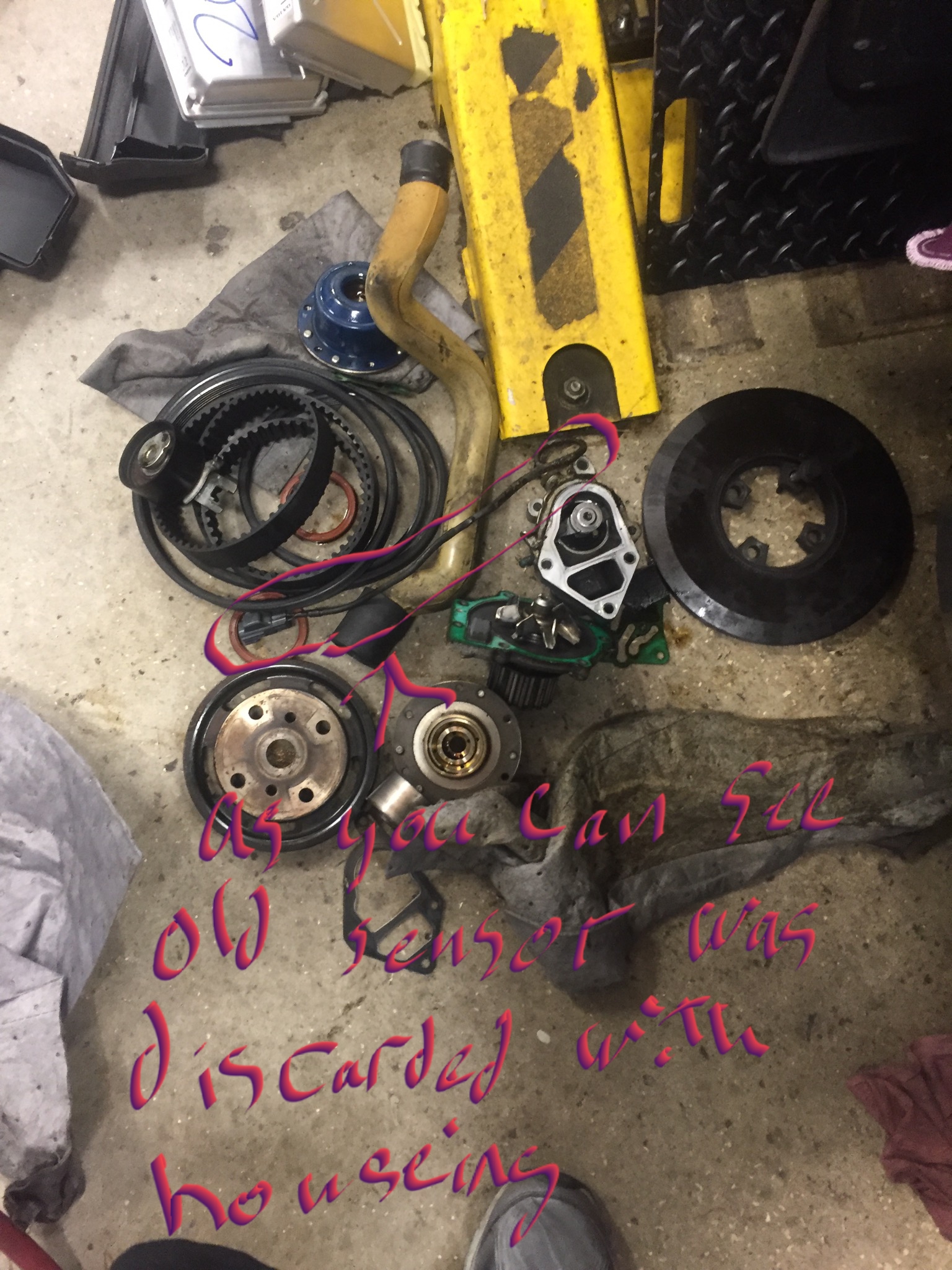

My 2004 has a temperature sensor on the thermostat housing. I understand this should be replaced every time as it can cause havoc of some kind. Is it plugged in tight? Just a thought. June

Yes it came with a new temperature sensor on the new thermostat housing, it registered temperature this morning, you could see the car was warming up. I just went out and disconnected and reconnected the temperature sensor, same thing happens.
