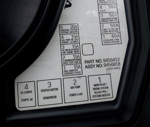

"So, after replacing that main ECU relay that looked burnt, nothing changed. However, I noticed that the Emissions Systems fuse (20A) was blown. Replaced the fuse, and instantly the car was running MUCH better (it was stumbling a bit, noticeable breakup in the exhaust). Within minutes, the CEL turned itself off."
Assume this is what you are referring to. Will check that out. Will have to do some research to know where that fuse is...
Looks like #5

I'll look at the fuse and clean the O2 connectors, then maybe look for vacuum leaks. That #2 sensor looks pretty hard to get at.
