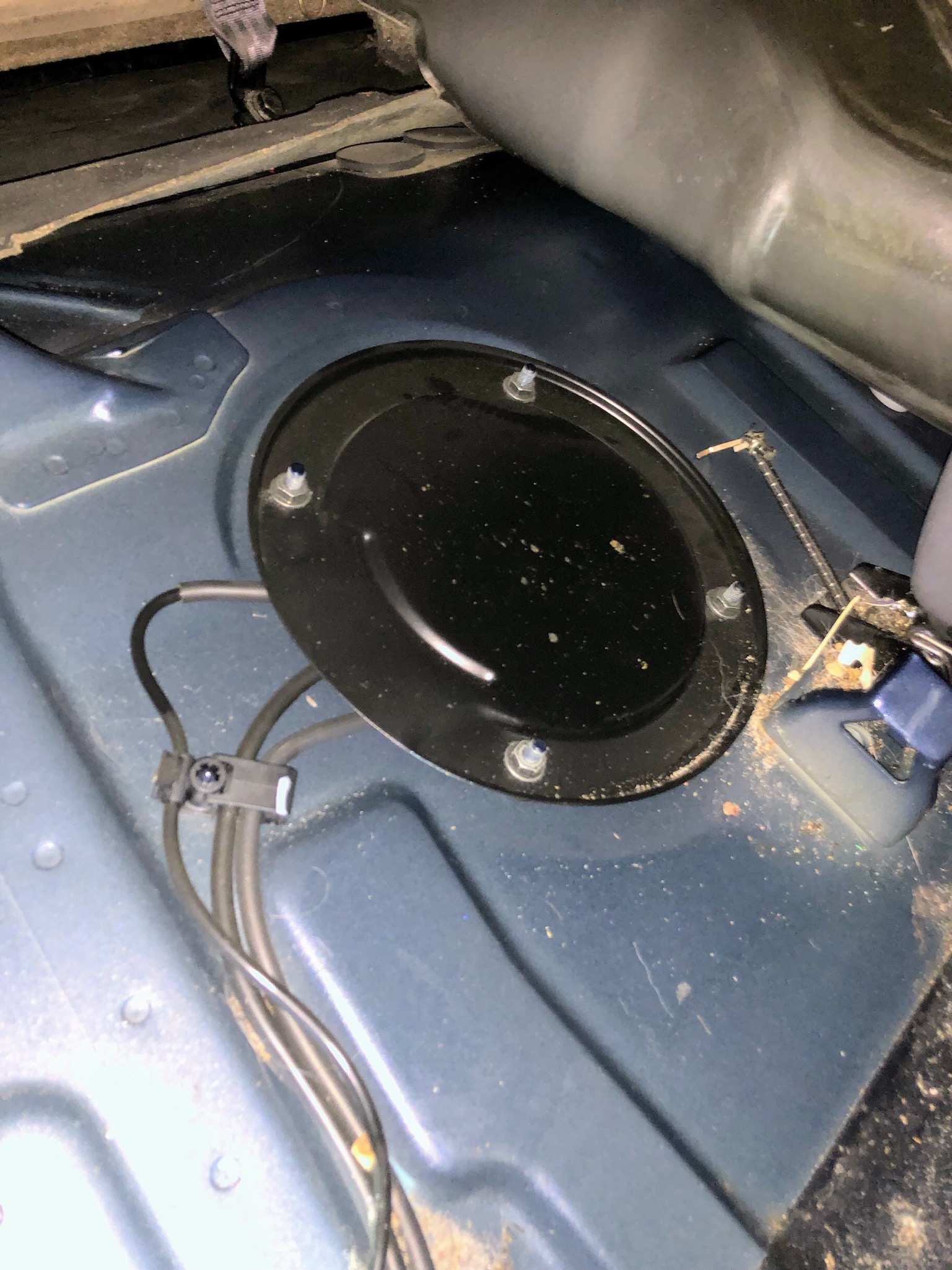

It turned out not to be too bad to remove the backrest. Disconnected battery, removed side cushion, disconnected SRS cable, removed three bolts. Pulled seat hard sideways so that the post slid out of the other seat, and moved the backrest into the cargo area.

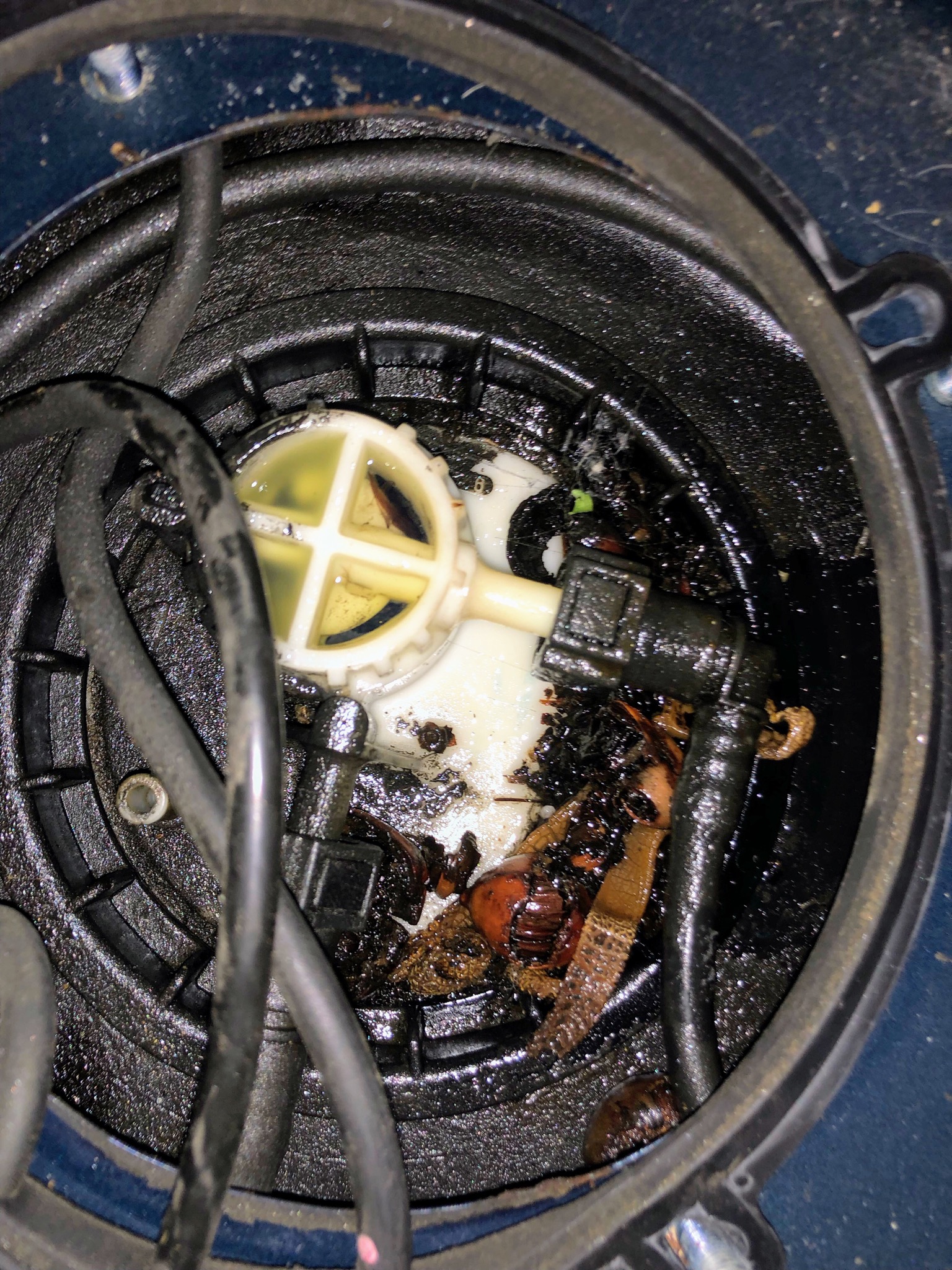

The fuel pump looks like an animal has been using it as a storage place for nuts. I can’t see any cracks, but it looks like the leak was coming from the cross/circle section. From what I’ve read, the cracks are mostly invisible and the solution as someone mentioned earlier is to just slather the whole area with epoxy.

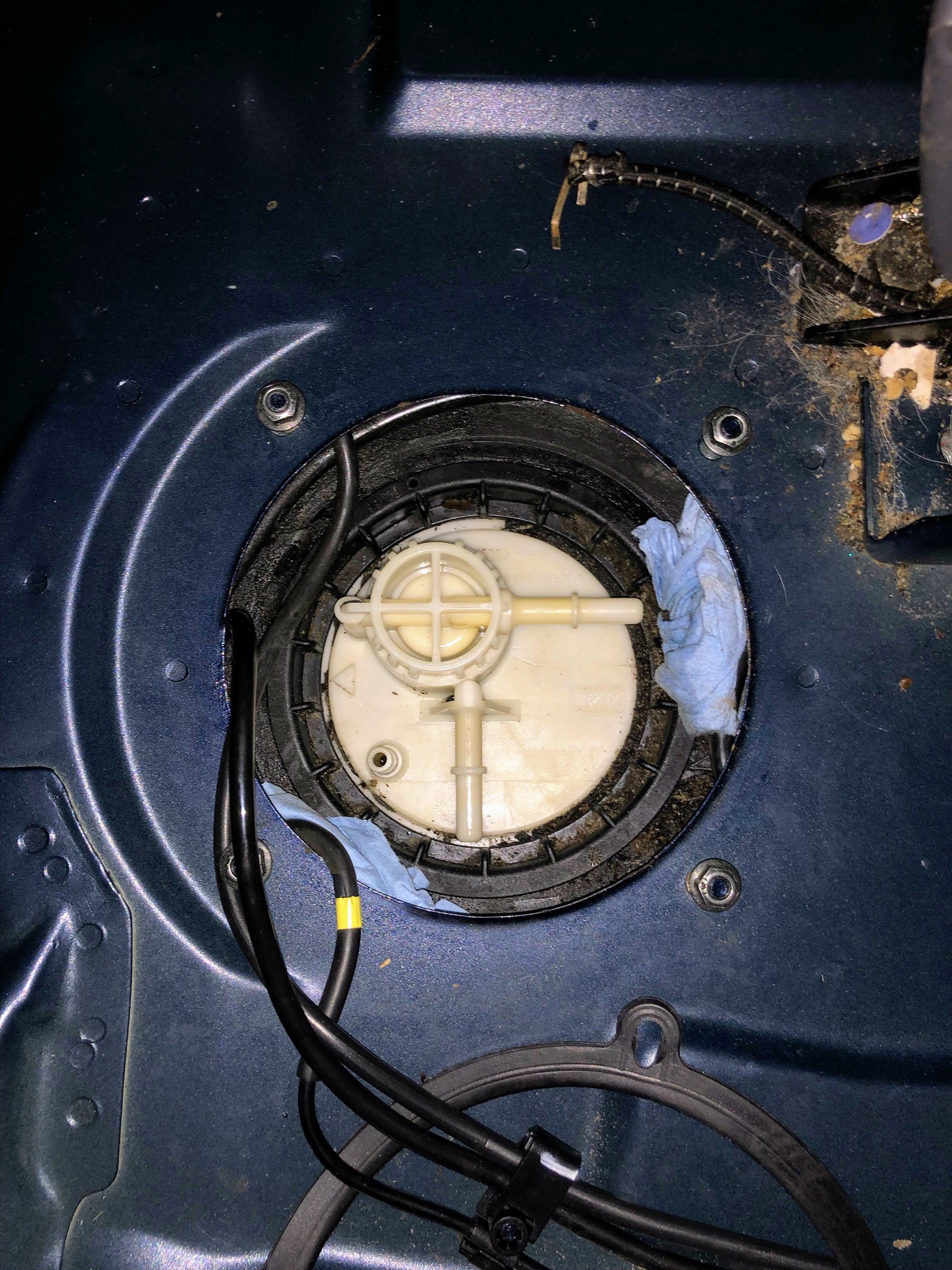

I cleaned everything with brake cleaner and dried it off the best I could. I’m going to give it overnight to dry out and then try the epoxy in the morning. Not sure how I’m going to fit sandpaper in all the deeper crevices on top to scuff it up but I can probably find a smaller tool to use.
Access panel
Before cleaning. Nut storage for animals. Fuel pooled in circle/cross section.
After cleaning

Thanks for nice clear pictures.
Isn't there a gasket under the large nut know to leak? There have to be o rings in those fittings too. Maybe reconnect SRS and key on to check for leaks carefully?

I see a crack in your after-cleaning photo. It is at the 4 o'clock position near the center on the half cylinder tube under the white cross on what looks like a one inch white nut.
There may be a crack in the big white disk from that nut (again at the 4 o'clock position, then going off to the right). But that may just be part of the molding.
Running the pump should show where the leaking is coming from, as abscate notes (especially if it is more than one location). Good idea to avoid the air bag light, too.
I would not think anything big enough to store nuts could ever get under the cover plate. I suspect Swedish Volvo assemblers hiding their snacks
. If there is a small gap at the edge of the plate, perhaps the nuts or seeds just blew in there?

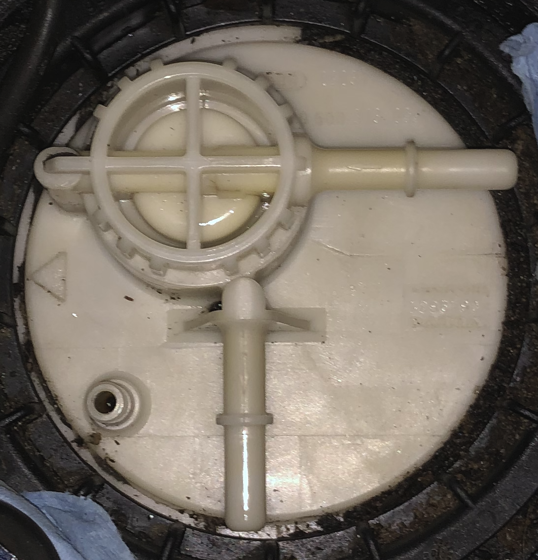

Here's a better closeup of the pump. I think both of those things may be part of the molding:EngineeringBloke wrote: 16 Feb 2019, 11:03 I see a crack in your after-cleaning photo. It is at the 4 o'clock position near the center on the half cylinder tube under the white cross on what looks like a one inch white nut.
I don't think anything is getting under the cover plate. My suspicion is that whatever animal it was, was taking the reverse path of the fuel when it leaks underneath the car: coming from under the car, and climbing up over the top of the fuel tank so that they end up squeezing between the top of the tank and the underside of the chassis. Once they reached the circular space between the top of the fuel pump and the interior cover plate, it would be relatively roomy so it's probably a good place to store things.EngineeringBloke wrote: 16 Feb 2019, 11:03 I would not think anything big enough to store nuts could ever get under the cover plate. I suspect Swedish Volvo assemblers hiding their snacks. If there is a small gap at the edge of the plate, perhaps the nuts or seeds just blew in there?

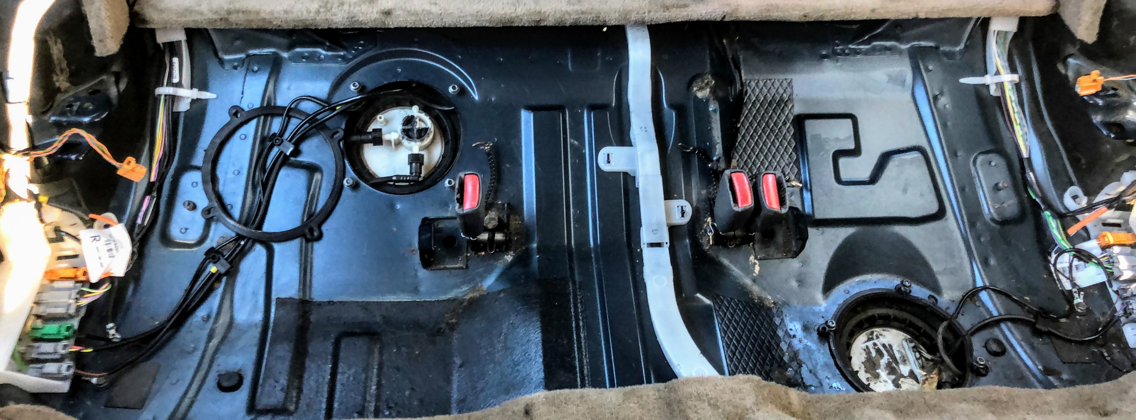

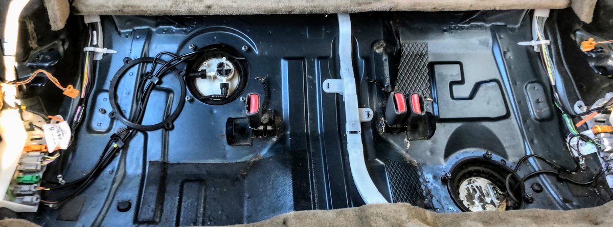

Photo of the backseat / fuel tank area disassembled for reference.
The cover on the fuel sender looked like it had a really grimy old piece of tape across it, but it was so brittle it got sucked up when I was vacuuming.
