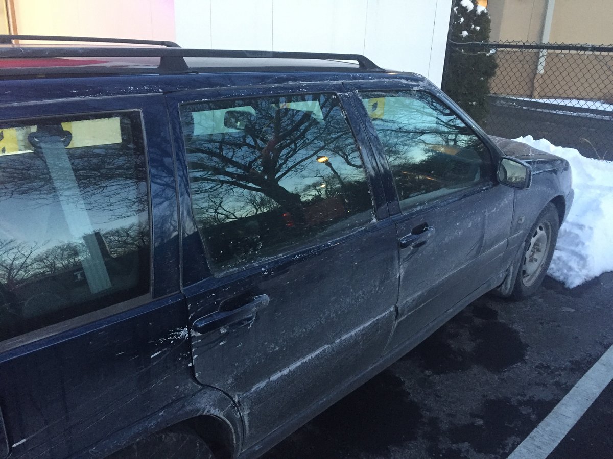

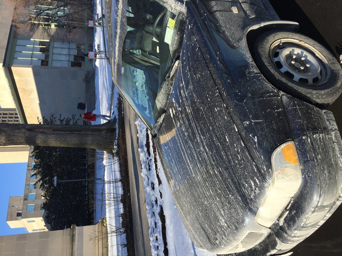

Elizabeth whisked me on a 400 mile round trip in the Northeast. I think I owe her a wash
