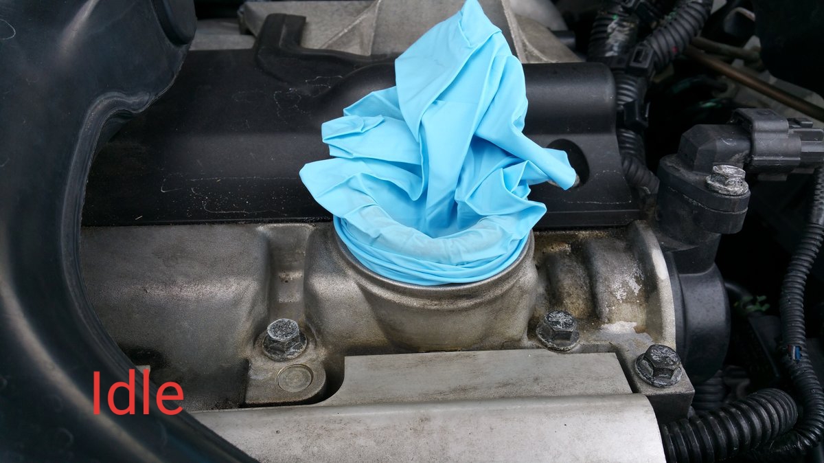

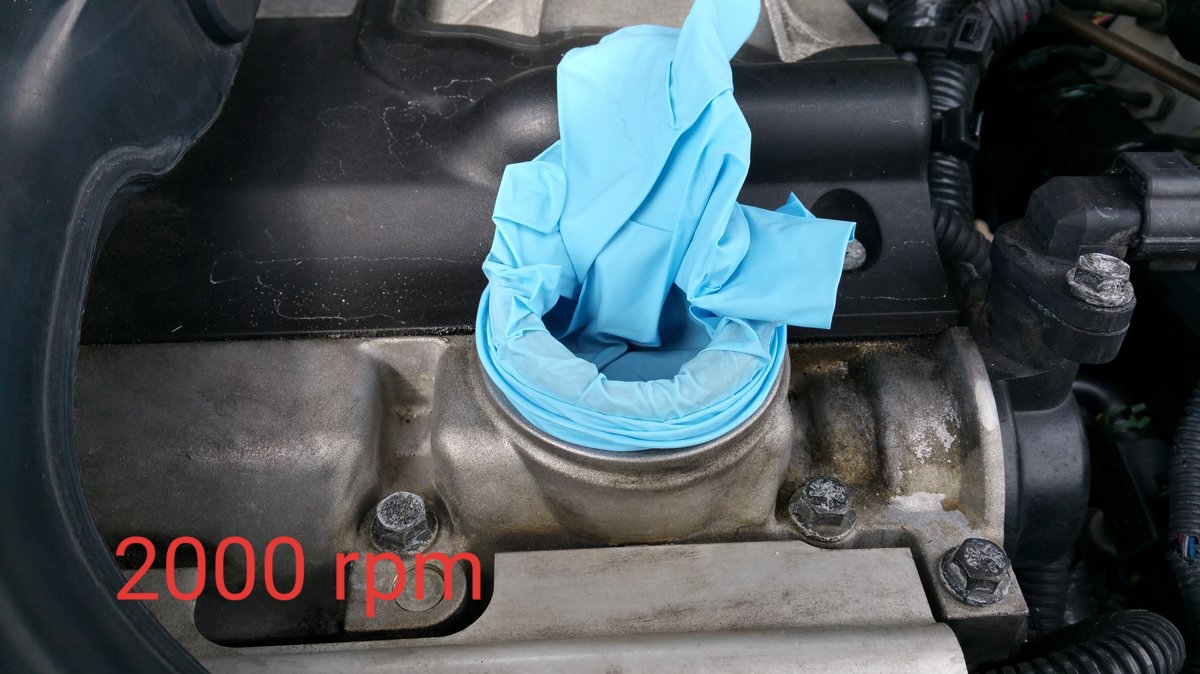

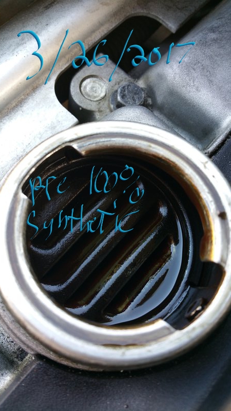

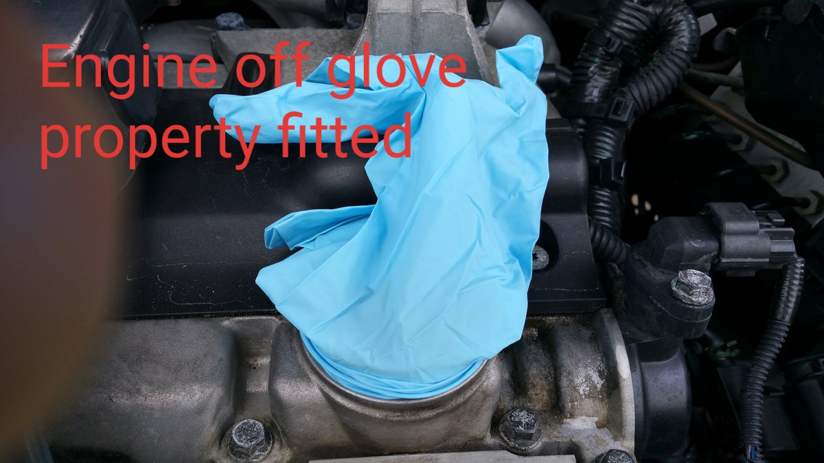

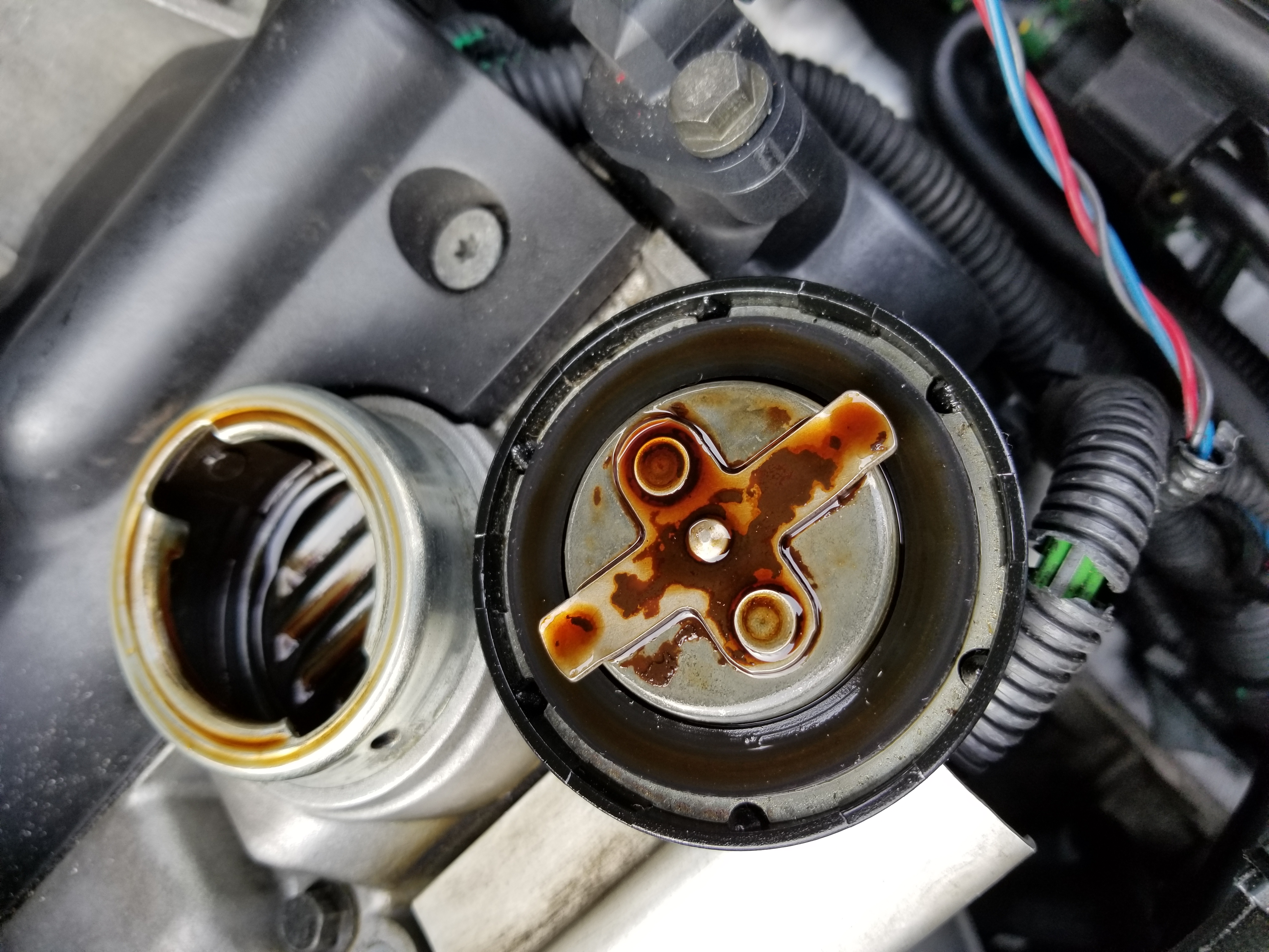

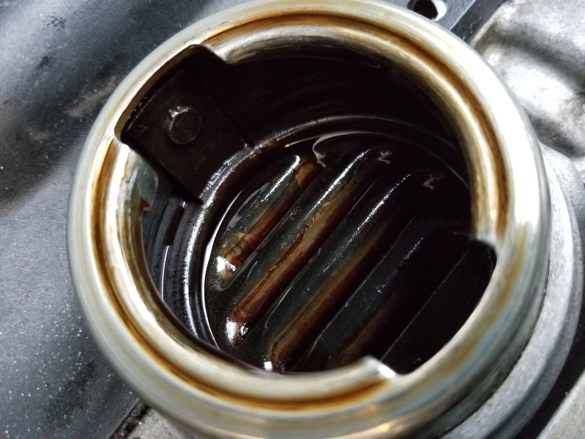

Also there is a diaphragm in the box from what I understand that can fail. Really if the system needs service you might be better off paying a Volvo mechanic if you feel uncomfortable doing a larger job like that. Do a glove test. I'll attach the photos showing you how. Volvo says never use additives in the oil. 100% synthetic oil will melt the crud away. I switched my car to Redline and all that crud is disappearing on own.i have always had 3000 mile oil changes with "synthetic" dealer oil changes and had that same crud. Over the last 35K the engine crud has incredibly been dissolving. I'll attach photos of the grates 35k apart. Juneabscate wrote: 03 Mar 2019, 17:06Positive crankcase ventilationnatural4reelz wrote: 03 Mar 2019, 06:48 Ok thank you
