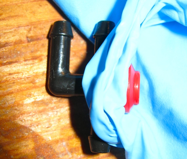

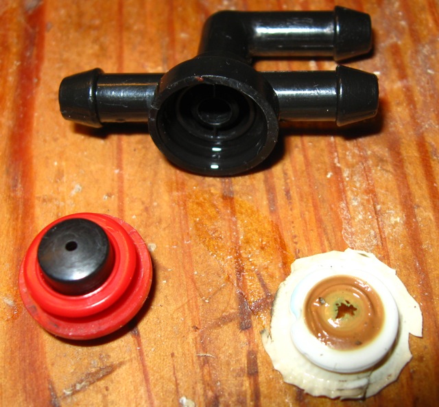

This is a small thing because you can buy a new check valve for the windshield washer for about $2 or $3, but you might not have to. My check valve was allowing fluid to shoot out of the top of the valve. I removed the valve, pried off the red lid, and found a deteriorated rubber gasket inside. I used a piece of a new rubber glove as a replacement. You just clip the new glove in with the red lid, and then trim the excess rubber around. I reinstalled it and it has been working fine so far.

The in hose is connected to the L shaped fitting that goes into the bottom of the check valve. This is the end opposite the red plastic cap that you pry off to replace the diaphragm.
