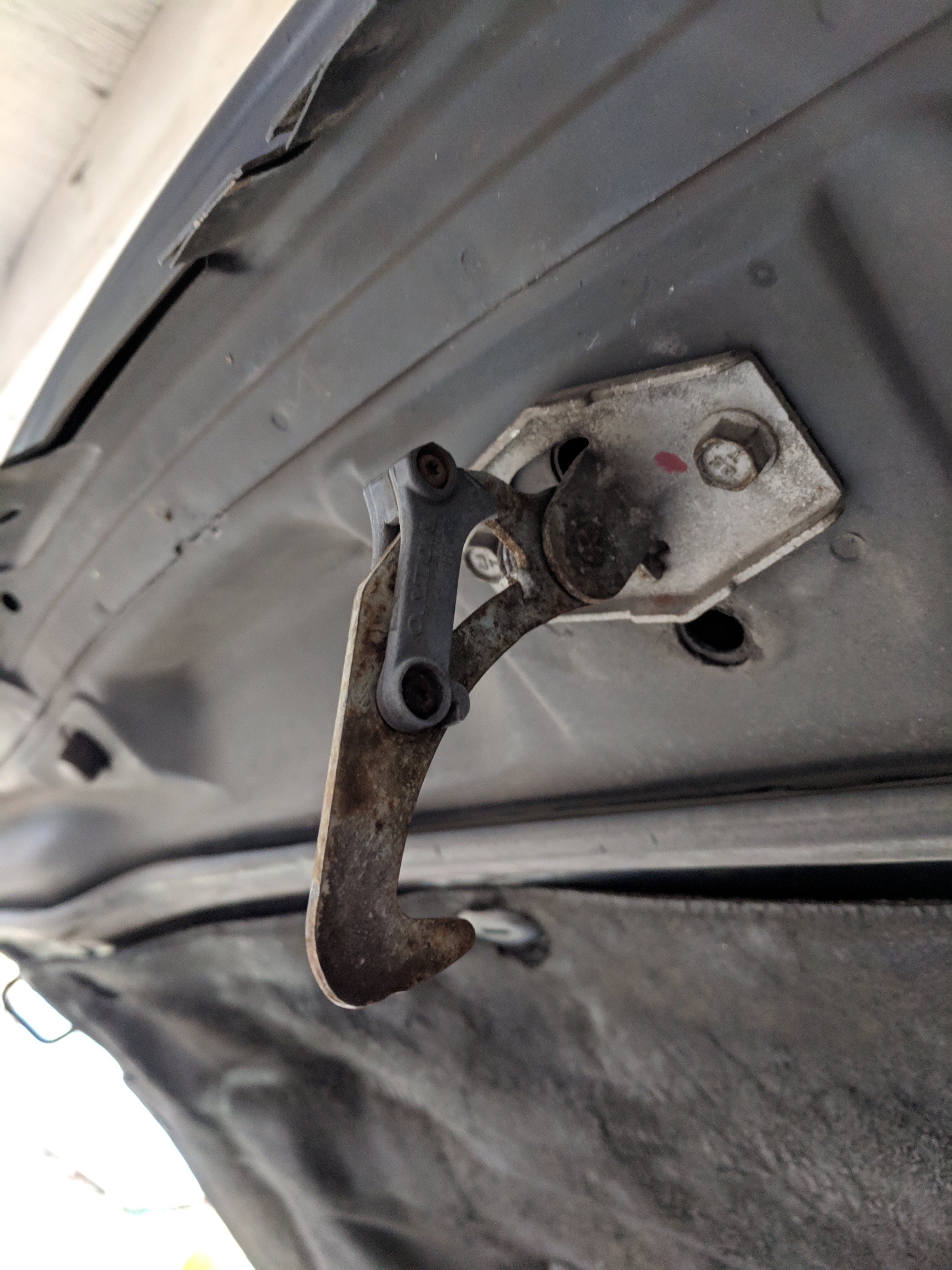

misha wrote: 23 Dec 2018, 17:10 Re-use the one from your old hood....or you mean on the one behind headlight?
I mean the one in the center of the grill. The junkyard one didn't have one on when we got it, and the one I was using just recently broke. So now I'm scared I won't be able to open the hood anymore if I put the new grill on.
Maybe I could just take the entire latch assembly off and drive without it? If it's closed properly or shouldn't be an issue.... Right...?
(Current on the car:)

Wait for another 850 to show up on a junkyard and grab it.
I'm not sure about removing it completely...it acts like a safety catch if one of side ones fail....otherwise you could end up with broken hood and windshield...if it opens on the road.

Definitely don't take that one off yet. As Misha pointed out hood could fly open. My safety latch was similar to yours and I forgot to fully close one day, hood lifted, stuck head out window to safely pull over. Ordered new one when I got home. Attach a piece of wire to pull on it, drape it thru the grill temporarily.
