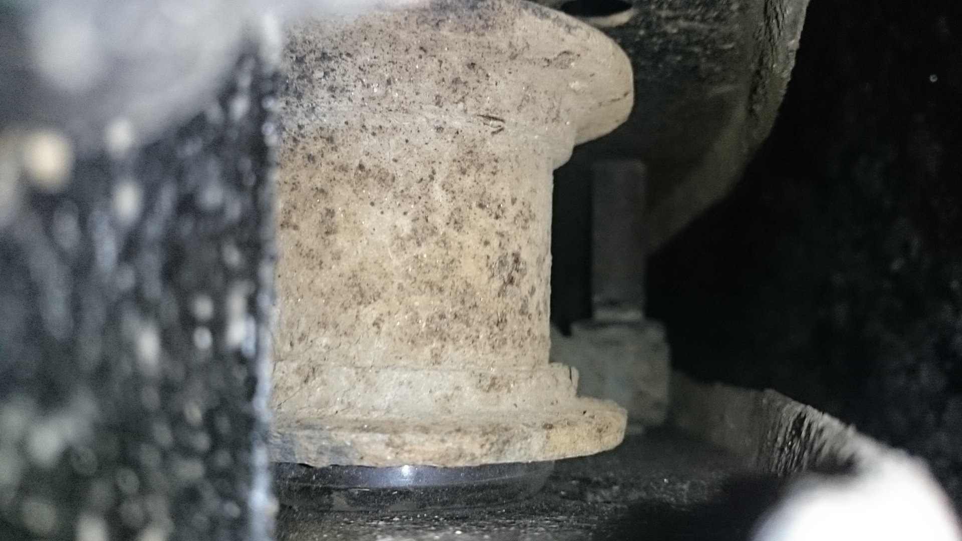

Ah yes, another clunking 240 wagon (1990). Has anyone found a source for a poly replacement bushing for the trailing arms on the Differential end? I ordered some from one of the on-line suppliers, but they fit the front (frame) end. I know that the "right" way is to press out the old and press in the new but I can't see why I can not leave the outer sleeve in the housing, clean up the inner shaft and put in a two piece Poly bushing. I think it would save alot of labor and may have additional road noise, but I can live with that.
There must be somewhere to buy bushings by dimensions or someone who has fixed this problem that way in the past. So. . . help me guys. Thanks
