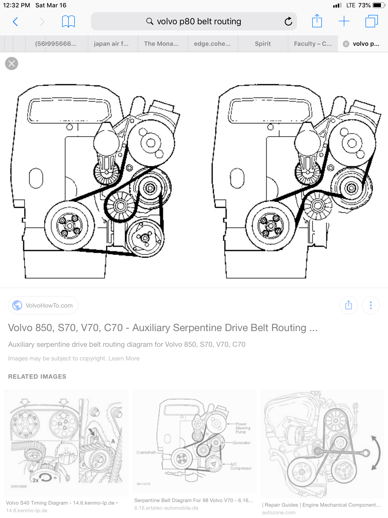

Okay,.this thread is to get help on running our cars without a PS pump
Anyone have ideas or access to belts to try this?
Let’s keep it 1992-1998 as the 1999-2000 are bastards of course.
One problem I see is the PS pump is giving most of the downward tension on the tensioner , so cutting that out and getting tension will be tough
Maybe a short belt looping just the crank, alternator and AC?

You cannot run the engine without the PS pump in place, there would be no tensioner. If you also removed the AC compressor, still no way to tension the belt.
If all you want is to run the engine for diagnostics, take off the belt and run just on battery power?

A while ago, I looked at a V70 that the owner was almost giving away because it had a frozen AC pump. I was going to throw the shorter belt on it and drive it away, but someone outbid me while I was at work. :)
It’s take some math, but it seems to me that routing for no AC is about as much shorter as routing for no PS, but with AC. The problem would be tension, and that you can’t run the belt over the tensioner instead of under it.
The best idea would probably be to sabotage the PS pump somehow, so that it’s freewheeling. That way, you’d be up up and away without risking anything else.

I believe eliminating the p.s. pump would take the tensioner totally out of play. If you find the belt, the slack you'll need to get it on would probably cause slipping at the very least and or not have enough tension to drive anything.
But just my guess. Good Luck
Posts: 35296
Has thanked: 1504 times
Been thanked: 3817 times
You only have alternator load if you keep the AC off. But, I agree, getting a belt on tight enough to drive the alternator without slipping looks like a challenge
