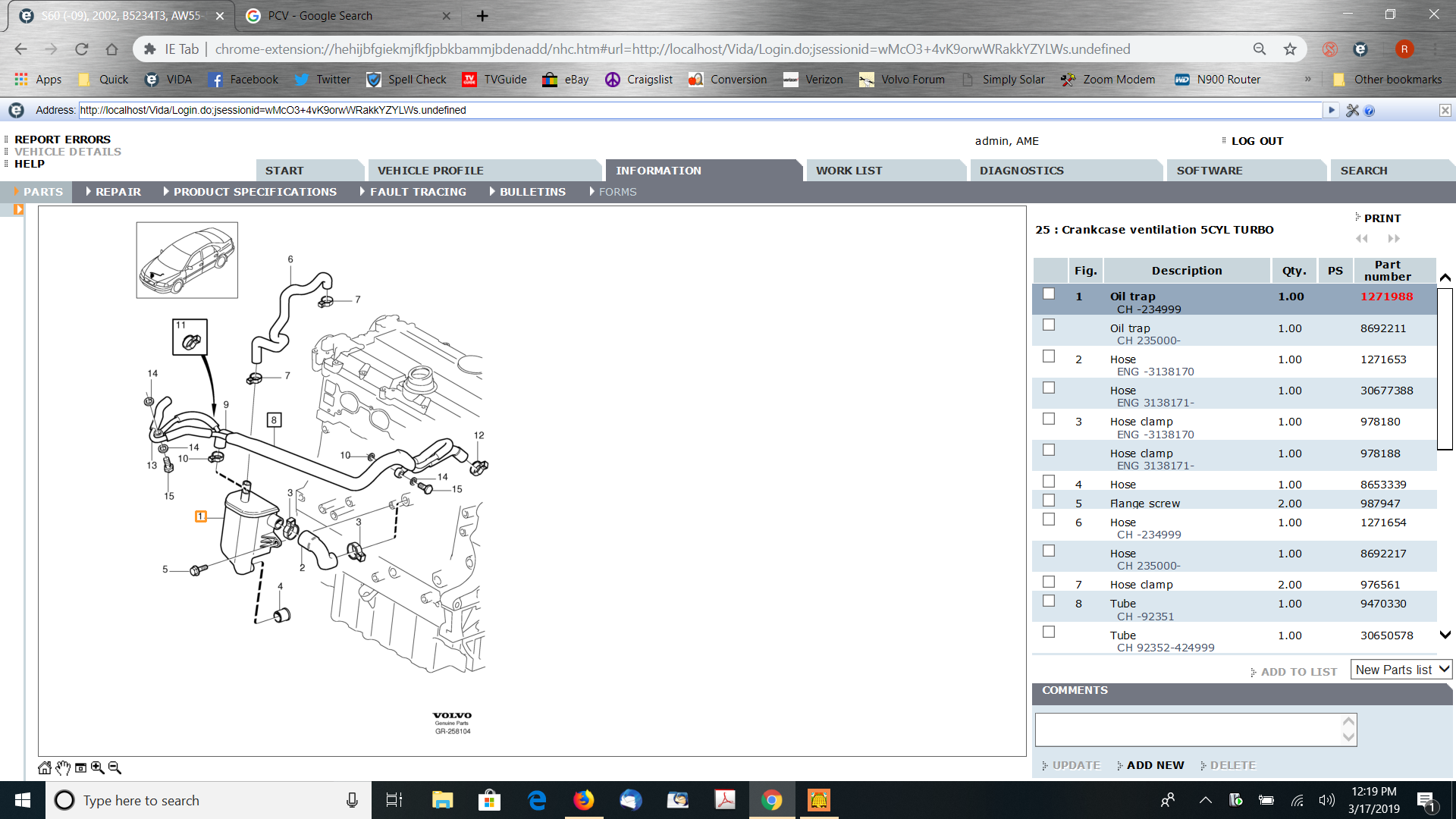

The numbered parts are the PCV system. This is shown with the intake manifold removed. You can get kits to rebuild the PCV system. Be aware some kits have all the parts in them some do not.
My option is: If you take the time to remove the intake manifold. Replace everything while you got it off, including non-PCV vacuum hoses,wiring dressing and intake manifold gasket. That way it will be a long time before you need to remove the intake manifold again.

So the list on the right is everything i need
The breather pcv thing is in the front if my engine ? In frint of radiator?????

It is under the Intake Manifold. the Oil trap is on the side of the engine block.
