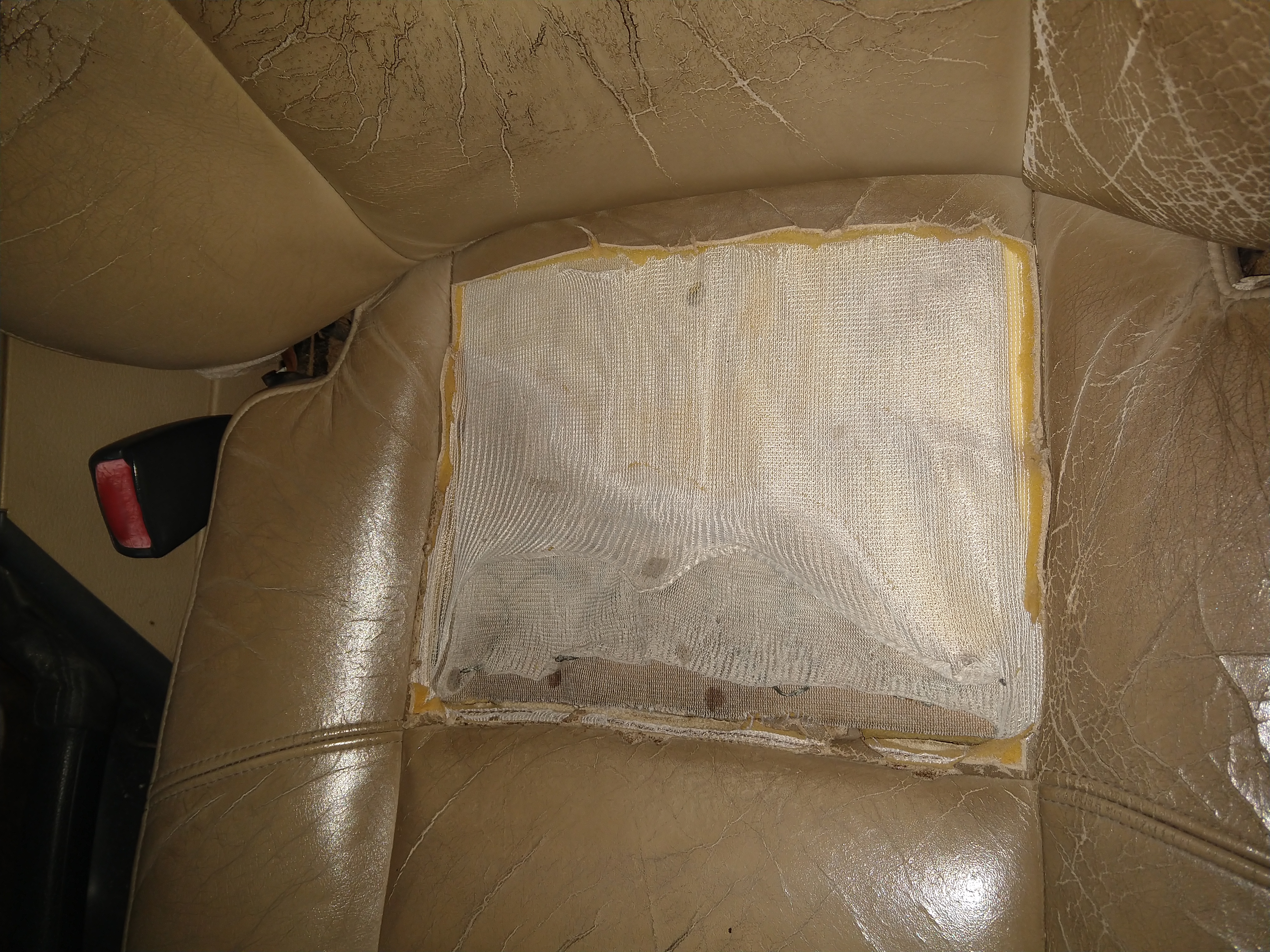

As you can see, my seat was in pretty sad shape. The 'rear' portion of the seat was completely deteriorated, and the deep layer of foam was starting to get torn up. I mainly did this to preserve the rest of the seat from further damage from daily use.
Step One: You need to cut out the old, damaged leather and foam. Honestly taking a knife to my torn up seats was way more painful then I thought it would be (if you get really attached to your car, you'll get it). I recommend using a box-cutter with a new razor blade, or a scalpel if you have one. Take your time and try to cut as straight and as close to the seam as possible. Be careful not to cut too deep and damage the mesh layer and the heating elements! I left a little material at the back so it would be easier to stick tape their later (and the back of the seat was in the way of my razor). After removing the damaged leather and foam, you may need to stretch out and glue the mesh backing material in place, as well as reposition what I believe are the elements for the heated seat.
