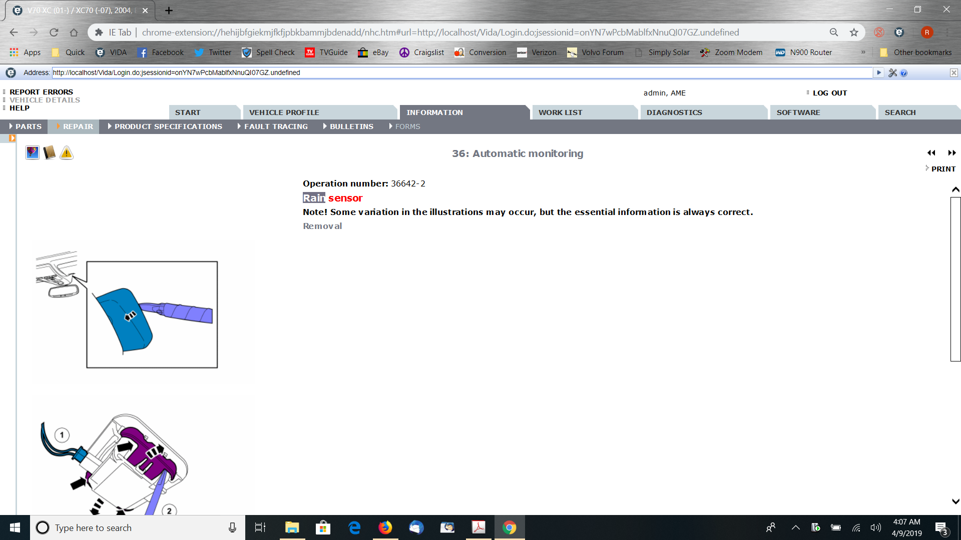

Can you tell me where exactly the rain sensor is? Is it on the exterior and senses moisture, or inside the glass looking out? I keep wondering if it's part of the red alarm light bump on the dash. Or the back of the mirror.
My '04 XC does pretty random windshield wiping. It might go forever not wiping until I can't see, then it will wipe on fast full blast for a while. I'm used to an adjustable intermittent. So I often run with the wipers off and just flip the lever for a single wipe (which is always two for some reason).

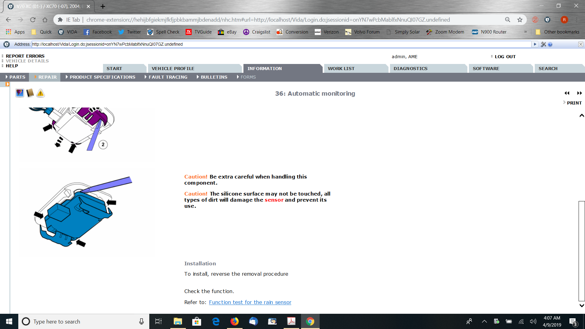

Post by RickHaleParker »

Inside the windshield in front of the mirror. It's apparently quite sensitive to improper mounting if the windshield has been replaced. Also if you add windshield treatment to the area it looks at it can become a bit wierd.
If you'd rather have a regular interval wiper like on the cars without just unplug it.

There's a clear silicone pad that sits on the face of the sensor between it and the glass. The pad likes to stick to the original windscreen. As a result it tends to rip/tear when removed and if reinstalled on the new windscreen like that the system will not work well. Seems many installers don't replace it when it happens and you'll need to buy a new silicone pad. Its a pretty easy DIY. The less you contaminate the new silicone pad during installation the better (ie fingerprints, dust etc).. I recommend wearing nitrile gloves while handling/installing it. And clean the inside of the windscreen where the sensor attaches with alcohol & lint free microfiber/cloth.
