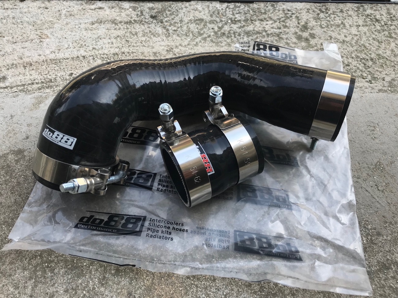

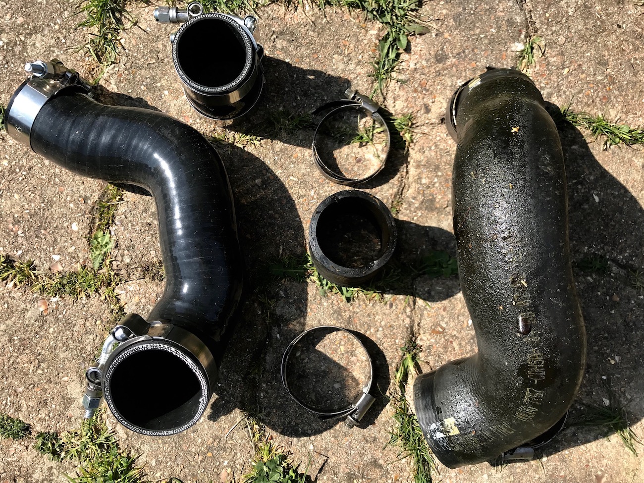

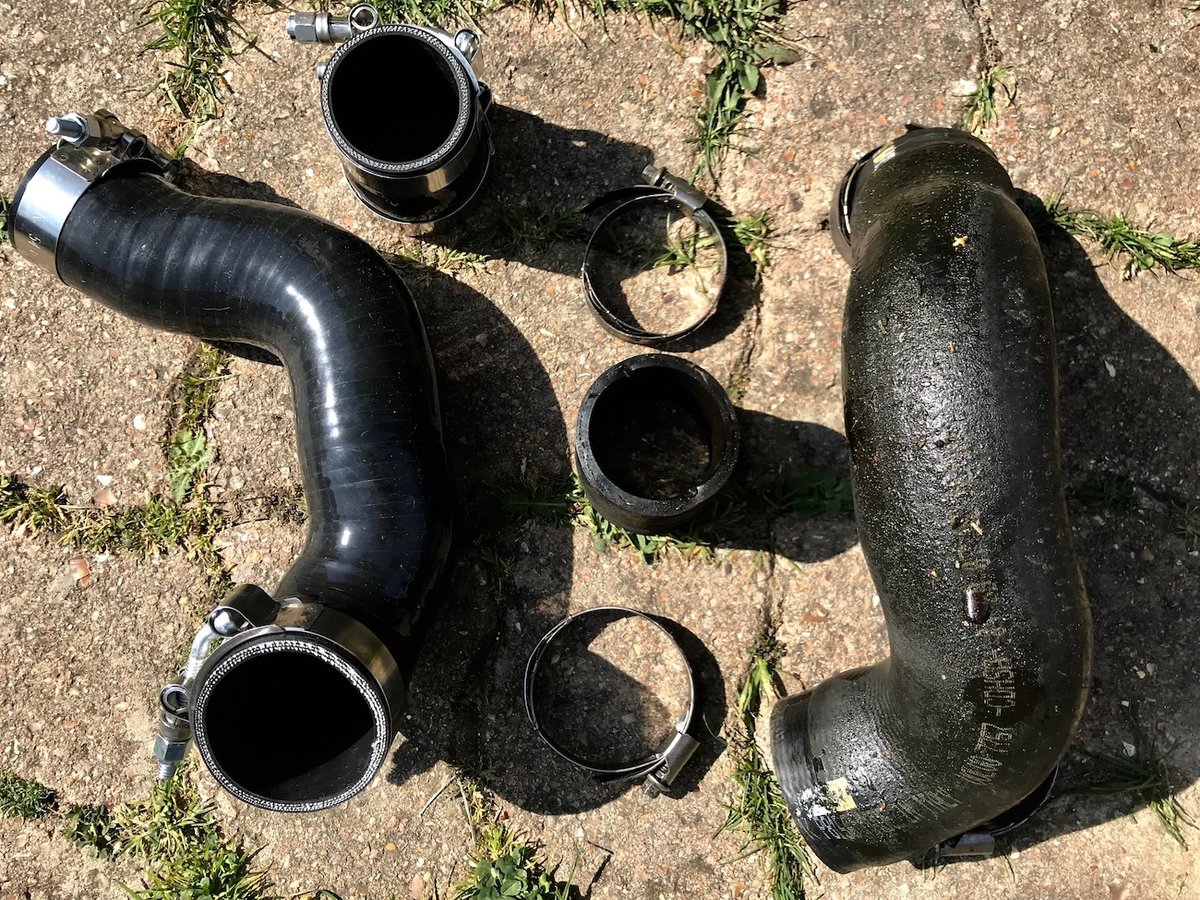

Spruced up the turbo engine today. These intercooler silicone hoses are pretty well made for half the cost of OEM. The T-Bolt clamps are a bit over sized but they work great!
Volvo XC70 2.5 T AWD P2 B5254T2 - 12/2005 Four-C Previous : Volvo V70 P1 2.4l 20s 170ch B5244S 03/2000 - Volvo 245 GL Break 1979 B21 -LPG - Volvo 240 GL Break 04/1992 B230F (Daily for 14 years)

ndphotonl wrote: 07 Apr 2019, 03:27 I use normal jubilee clamps, have bad experiences with tbolt clamps.
They look like tough clamps and sensitive to tight them, you don't know if you gonna crush the plastic pipe. Will see if it fits long time.
I couldn't get the original jubilee tight enough and had all this vapor oil sweating over the turbo and intercooler line.
