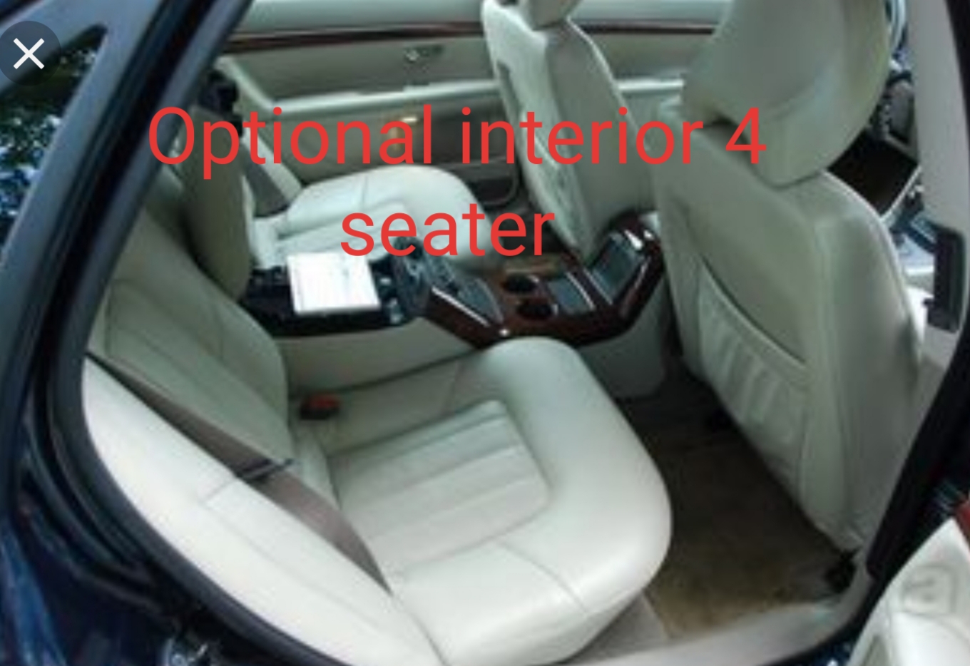

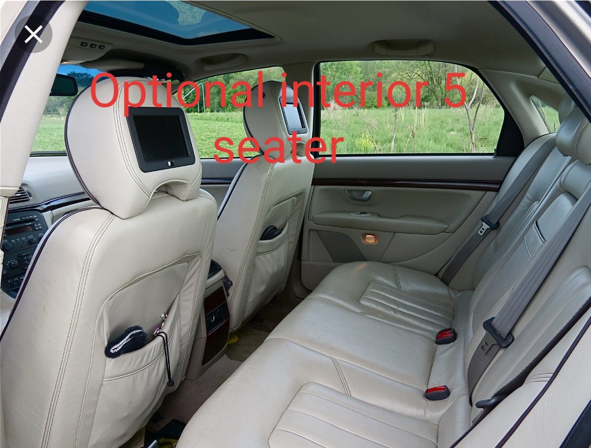

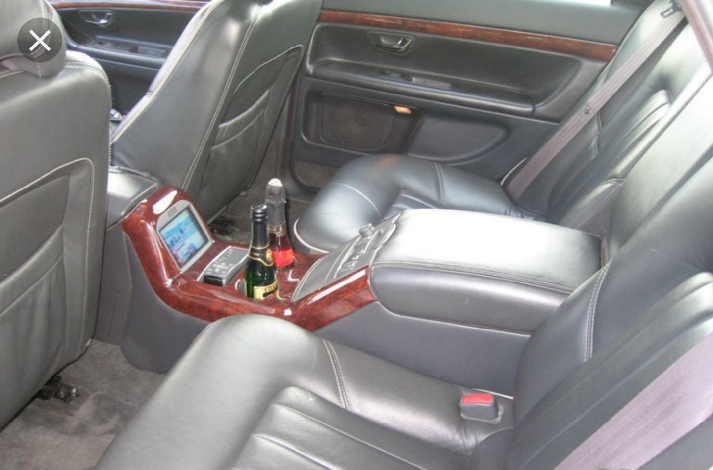

The absolutely best seat in the P2 were the 1st generation S80 optional interior. It was standard on the Executive. My 2002 was a Executive and had this interior. It was nearly the sister interior to the 960 Royal. No other seat came close to its comfort. You will be hard pressed to find anyone else on here that drove a Royal or a Executive. 2004 through 2006 any S80 could have the 5 seat version of this interior as a option. So much more common in 04 and 05. To say "more common" is only relative to the super rare S80 Executive. June

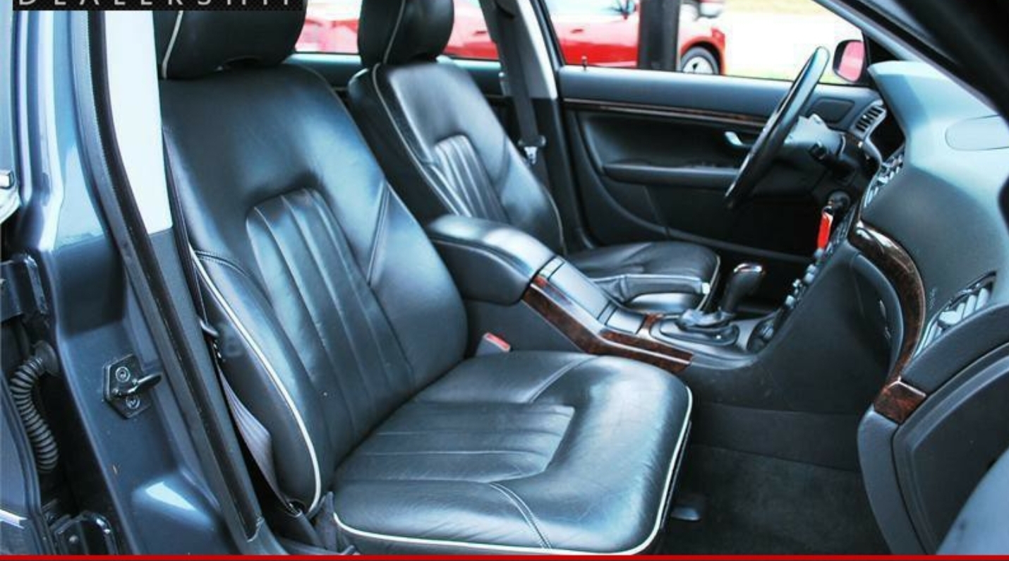

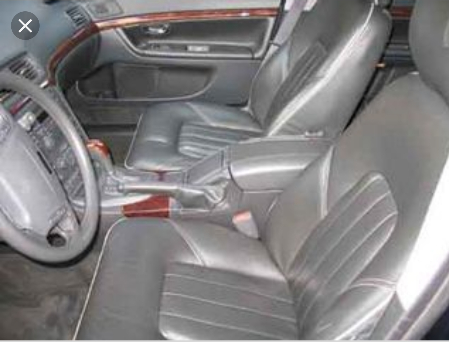

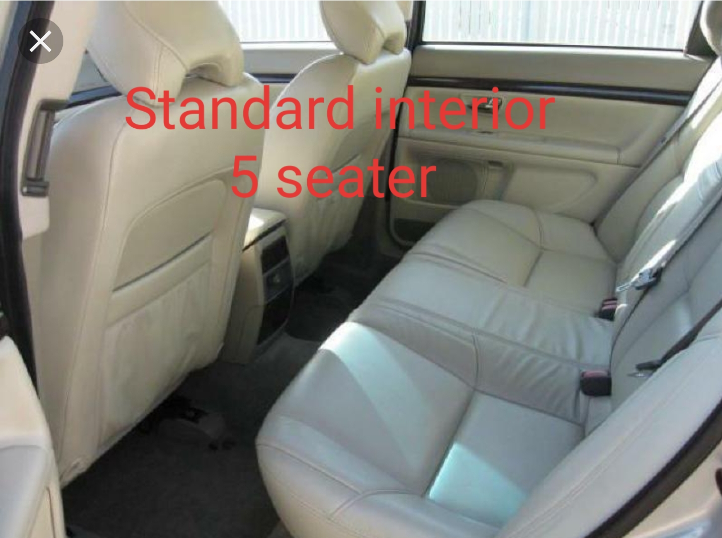

Here are some pictures of the standard interior vs. Optional interior for the 1998-2006 P2 S80. You are right even the standard interior is better than any other Volvo seat in P2, but the optional seats were better beyond that. Notice the difference especially the lower cushion and center back design. JuneRattnalle wrote: 16 Apr 2019, 07:12 I don't think I've ever seen that back seat configuration before.
That said even the regular seats in the early S80 were by far some of the best Volvo has made. Super comfortable while still keeping you stuck properly in place while turning. They've really lowered the bar since with shorter seat cushions among other things. I haven't tried the SPA seats with extendable leg rests though.
