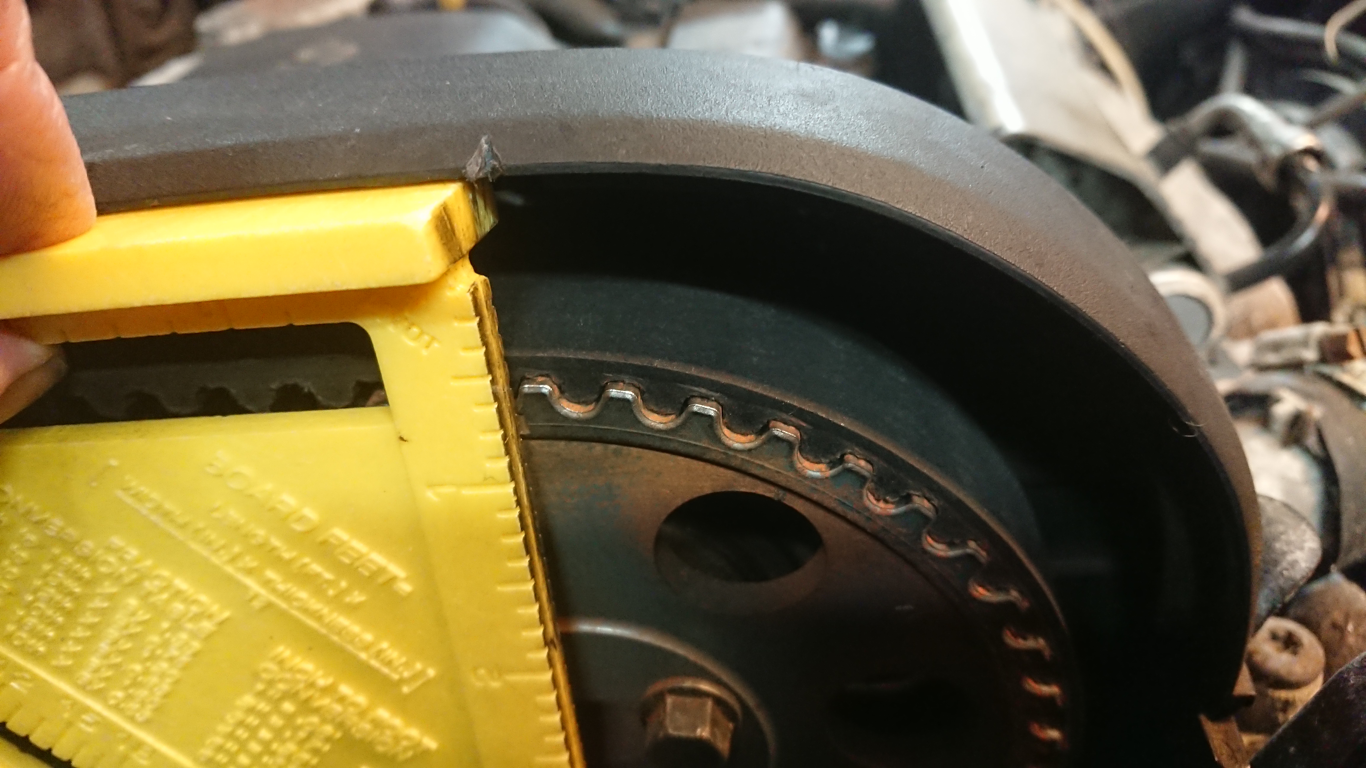

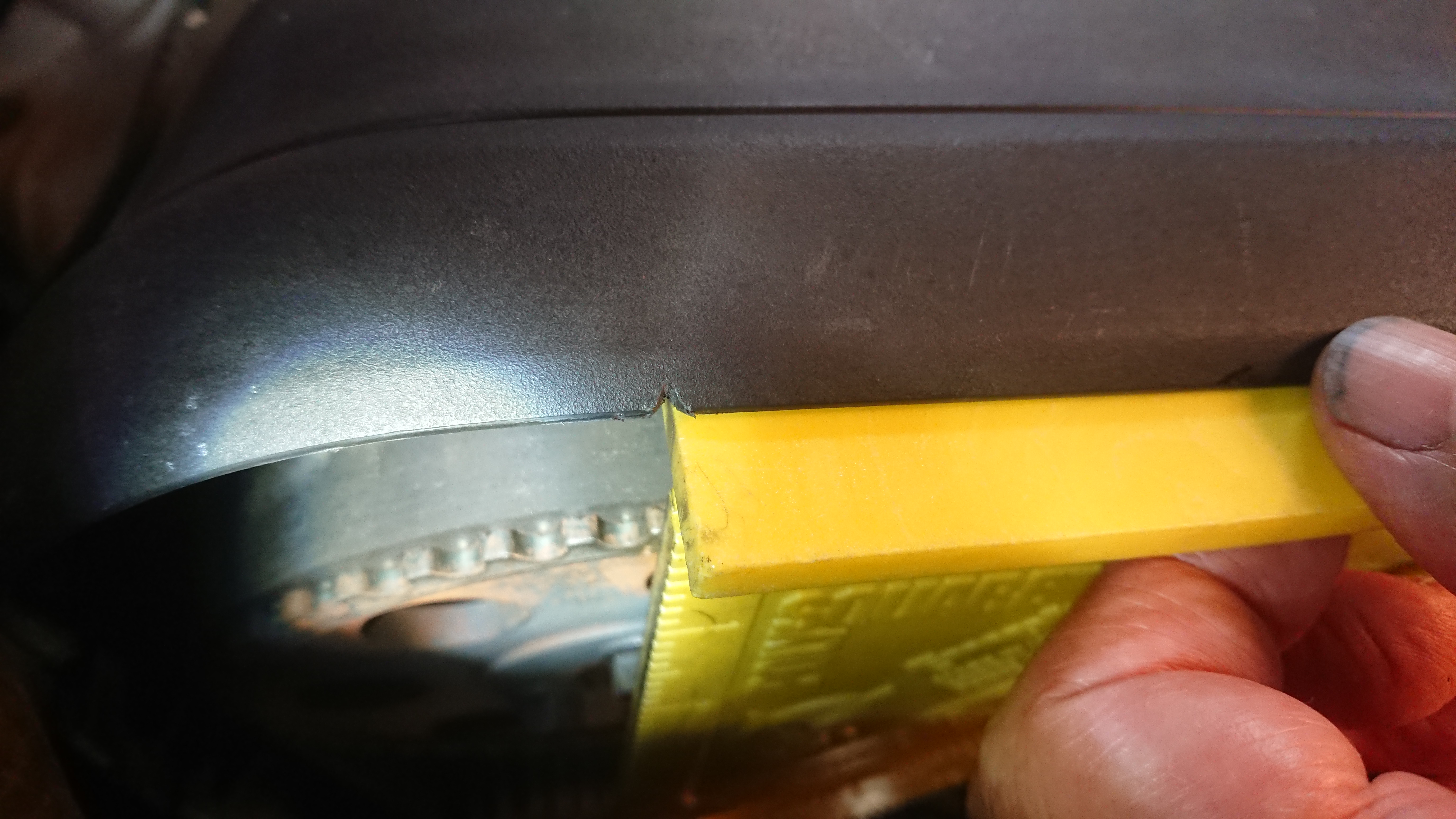

I got the new T belt installed today, but it took me a while. And what I thought would be the difficult part, was actually easy. I opted not to remove the pulley because I don't have an impact drill. But getting the belt around the backside of it was actually pretty easy. A little bit of fumbling but I got it on after 10 mins or so.
What took much longer was getting the belt installed with the timing marks lined up properly. I didn't expect to have problems with that, but what was bothering me was that it was so hard to see the marks in the cover. I ended up with the exhaust cam off by one tooth twice.
Then I had an idea (this was probably done before, I doubt I came up with something new). I extended the little notches out to the edge of the cover, where they can be easily seen. That made my life a lot easier, see below:
The only thing I'm not entirely comfortable with is the adjustment on the tensioner. I tried to have the little lever stand up straight since it was a 65 deg F day, but somehow I ended up with the hex. hole at about 7:30 or so. Tension seems fine but I don't know if I should try to adjust that again.
Also, that little lever moves around quite a bit when I rotate the engine, is that normal?
