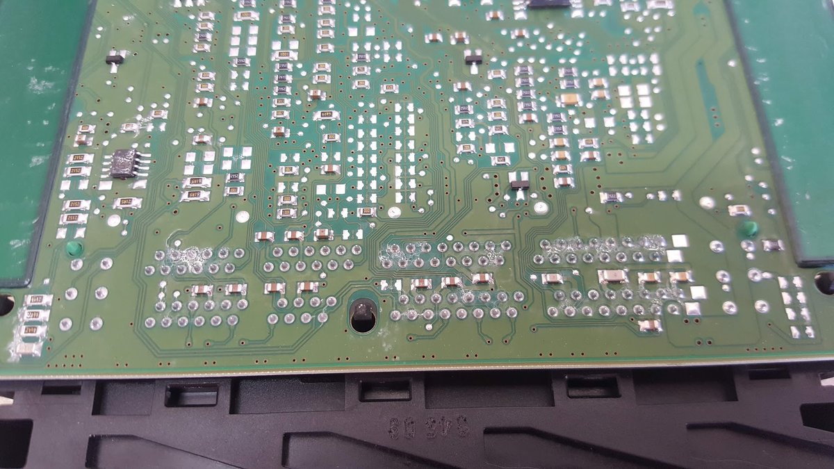

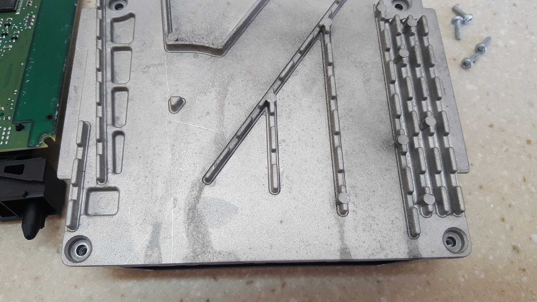

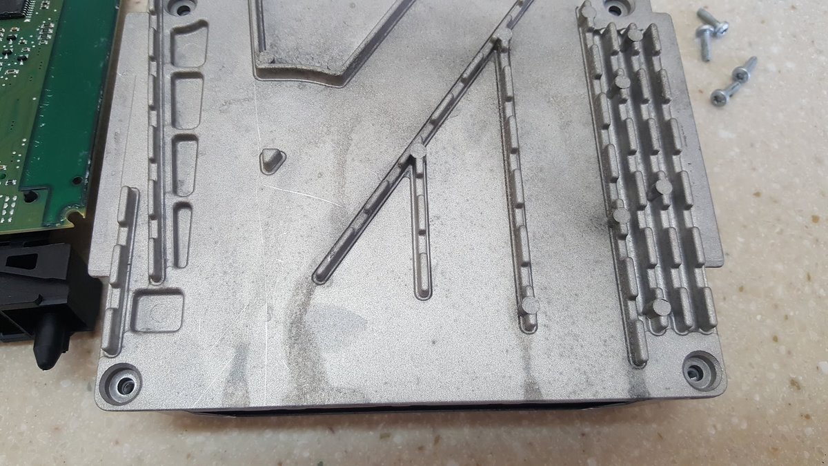

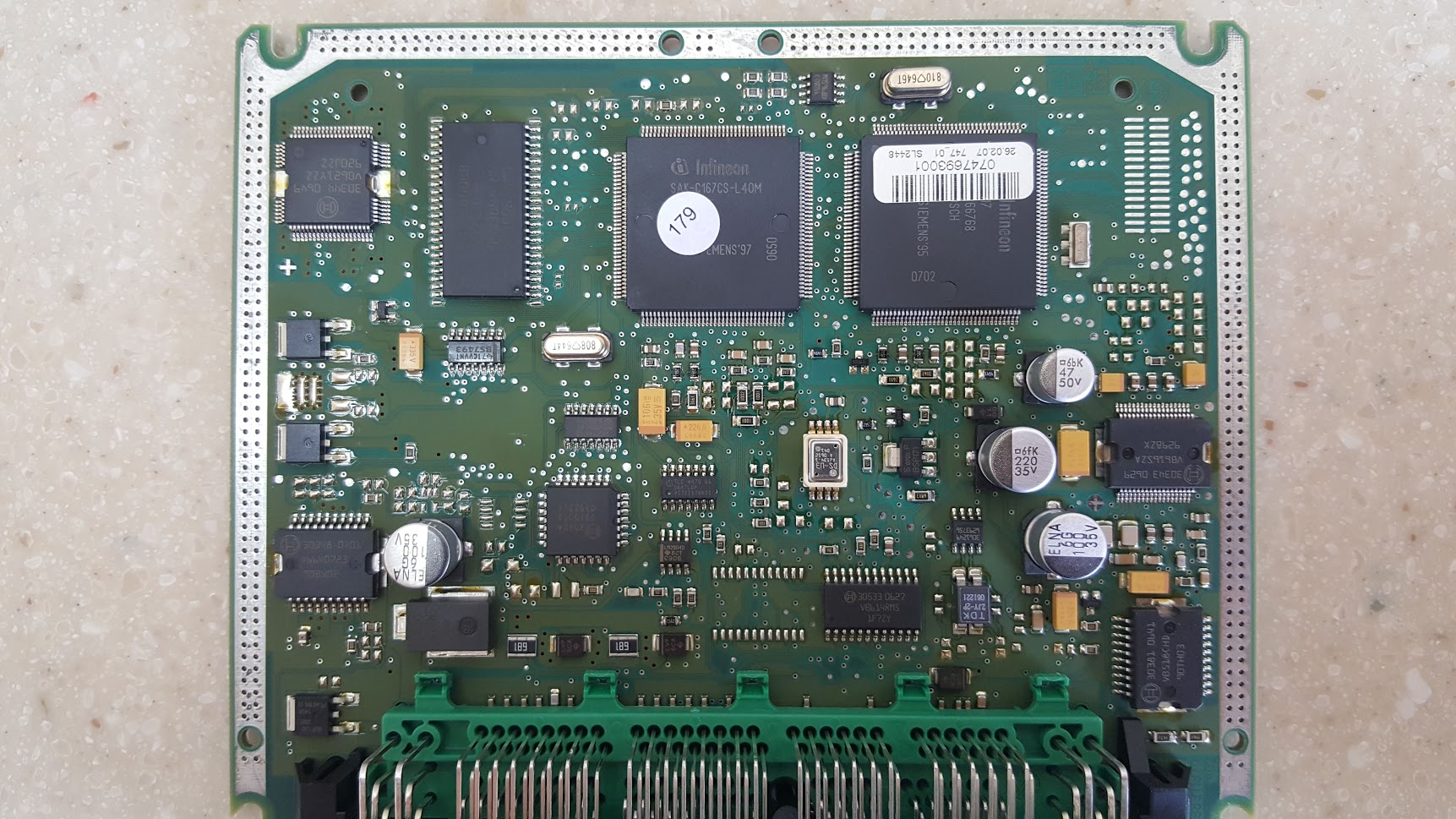

Well I think we figured it out.
The connectors on the ECM looked great, but I noticed it looked like water had been flowing down the side of the aluminum ECM cover in the past. So we popped the ECM open and it had corrosion everywhere on the back side of the PCB.
Wonder if ultrasonic cleaning would bring it back to life or if it needs to sent out or if its shot lol
Ill try cleaning it first and go from there I guess, we'll find out if anything burnt out.
Thanks for the help everyone.

Could be mineral deposits (from the water) creating leakage currents.
Wash the board with Electrical Contact Cleaner.

RickHaleParker wrote: 23 Apr 2019, 14:20 Could be mineral deposits (from the water) creating leakage currents.
You might be right, i was thinking it already went the step further and turned to corrosion.
I will def try to electrical contract cleaner right now before taking extreme cleaning measures haha.
Thanks again.

A used ECM with the same Bosch part number can be cloned to suit the car. You'll need a Windows laptop and a Dice tool. I can fill you in and point you in the right direction with regard to who can do this for you when/if the time comes.
