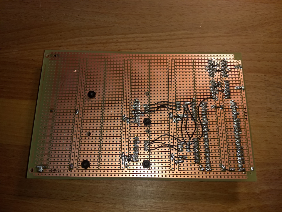

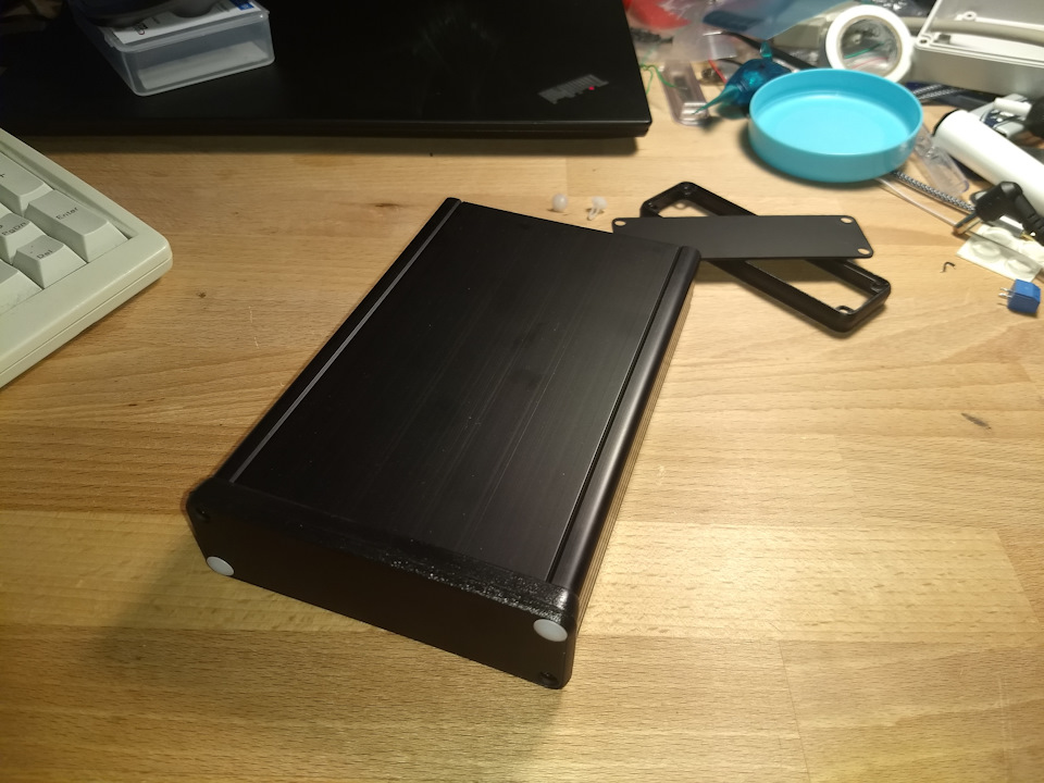

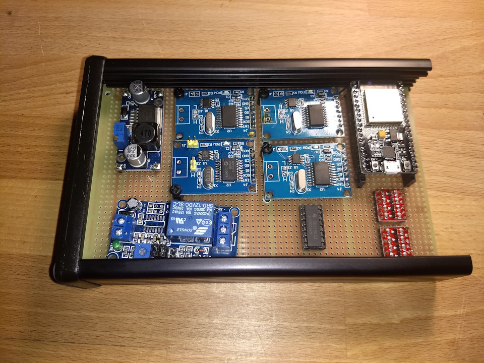

This is my "version 3" work in progress:
Need two extra CAN channels to control headrest monitors for my kids, you don't have to solder all four.
I had the software generally working on ESP32 a couple of month ago, just decided to solder everything on the breadboard and put in a bigger enclosure. The code sits in the esp32 git branch: https://github.com/vtl/volvo-ddd/commits/esp32
Also all/most model years differ in how the CAN messages are layered out exactly, so that part needs to be adjusted. The software is designed with that in mind, all the car differences should be contained to one file (car configuration). For example, this file is for my MY05 XC70: https://github.com/vtl/volvo-ddd/blob/e ... _aw55_us.h Adaptation to other configurations shouldn't be too big of a deal, I figured out how to carve needed bits out of VIDA SQL database.
