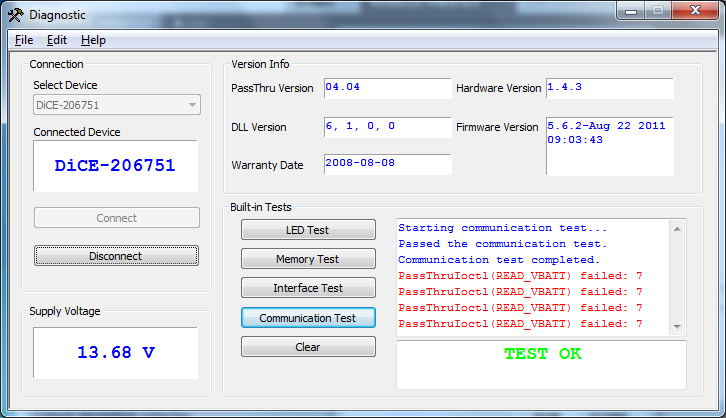

Xheart: On your Base System Device. Go to Properties\Details\Hardware Ids. Copy the top Hardware Id to the clipboard. Paste the Hardware Id in to Google Search. You might be able to find what it is and the correct drivers.

Diagnostic Tool says DiCE is connected and TEST OK. But when VIDA is asked to READ VEHICLE, it fails...

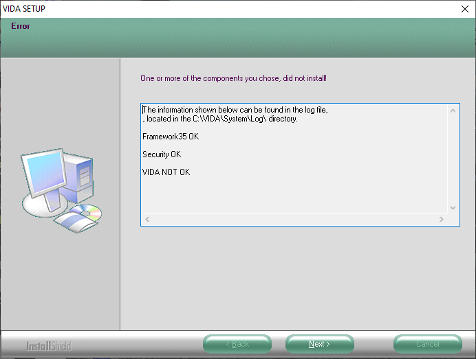

Okay, time to ask for help... because I'm at a loss. I've had to uninstall/reinstall VIDA at least 3 times now, and each time it ends up going into a loop of not starting (VIDA monitor shows not ready or error, can't remember excactly) and now I can't even get it to install.
When I install part two of the VIDA RePack, everything seems to go smoothly until the end, when I get the VIDA NOT OK message at the installation summary screen. I copied the info I found in the installation log. Everything looked just fine until the end...
I added bolt font to the two entries on the log that looked suspect. Any idea what I could be doing wrong? Every time I've installed it before, following the instructions on the first post on page 6 of this thread, I had no problem.12:51:35 [INFO] Language = en-US

- vida error.PNG (46.55 KiB) Viewed 3501 times

Open the SQL server, Configuration Tools/ SQL Configuration Manager.
Make sure that ‘SQL server (SQLEXPRESS)’ and ‘SQL Server (VIDA)’ are both set to ‘automatic’.
Try again. If all else fails completely uninstall and eradicate SQL server then start over.
