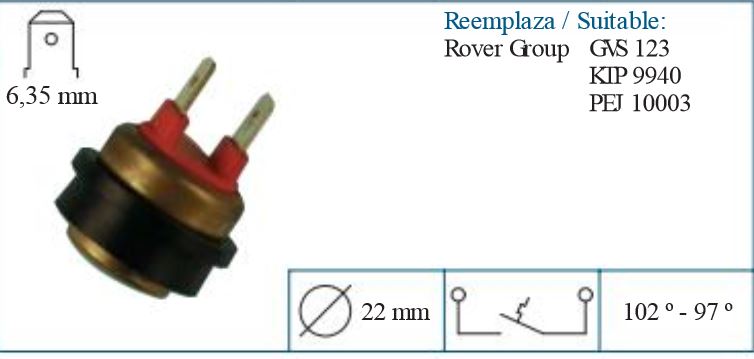

In Celsius below,....from 206°F to 215 °F switch is closed to conduct.
Just on Rex/Regina radiators that have electric fans
