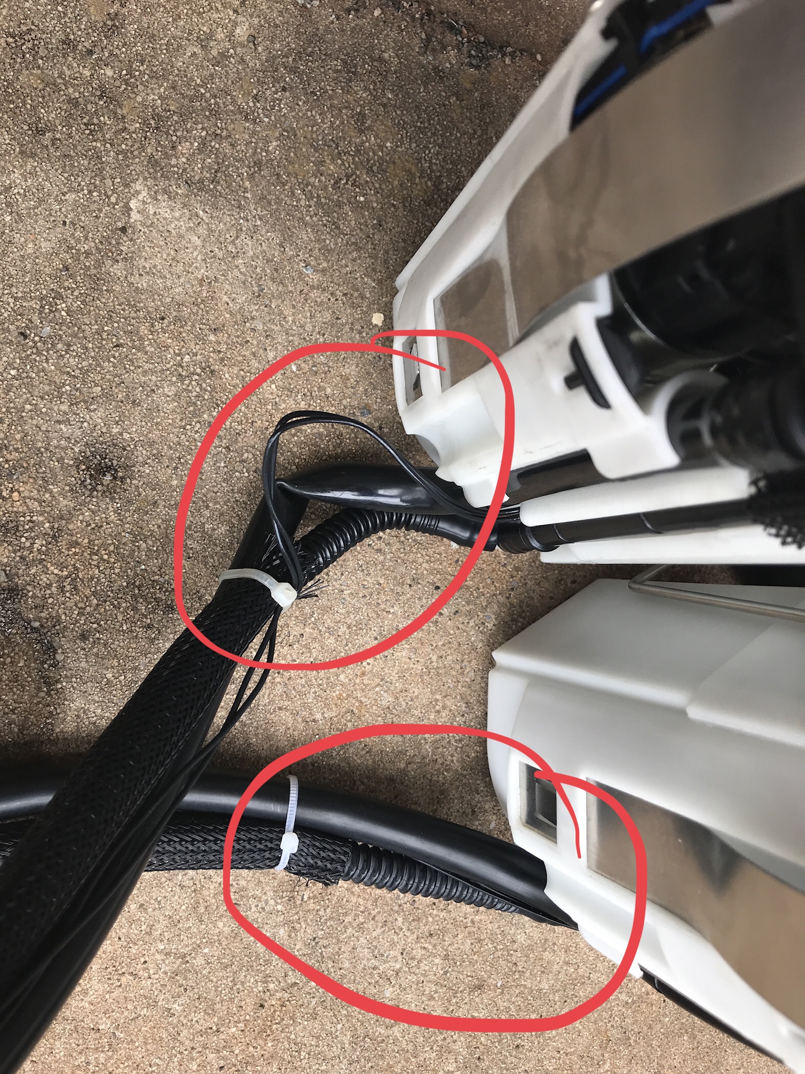

Replaced the fuel pump with a warranty replacement. Found the issue, it was a kink in the line coming from the sender unit. I pulled the fuel pump out and pump side was dry save for a tiny puddle for gas. Fuel sender side was full of gas.
I’m going to run it down to empty to test the fuel level is good before capping off. It’s pretty difficult getting the pump in and fishing the line to the sender unit. Everything feels a little forced when installing. Crossing my fingers that it’s not kinked again, suppose time will tell. I’ll keep this unanswered until I can confirm the lines not kinked again.
