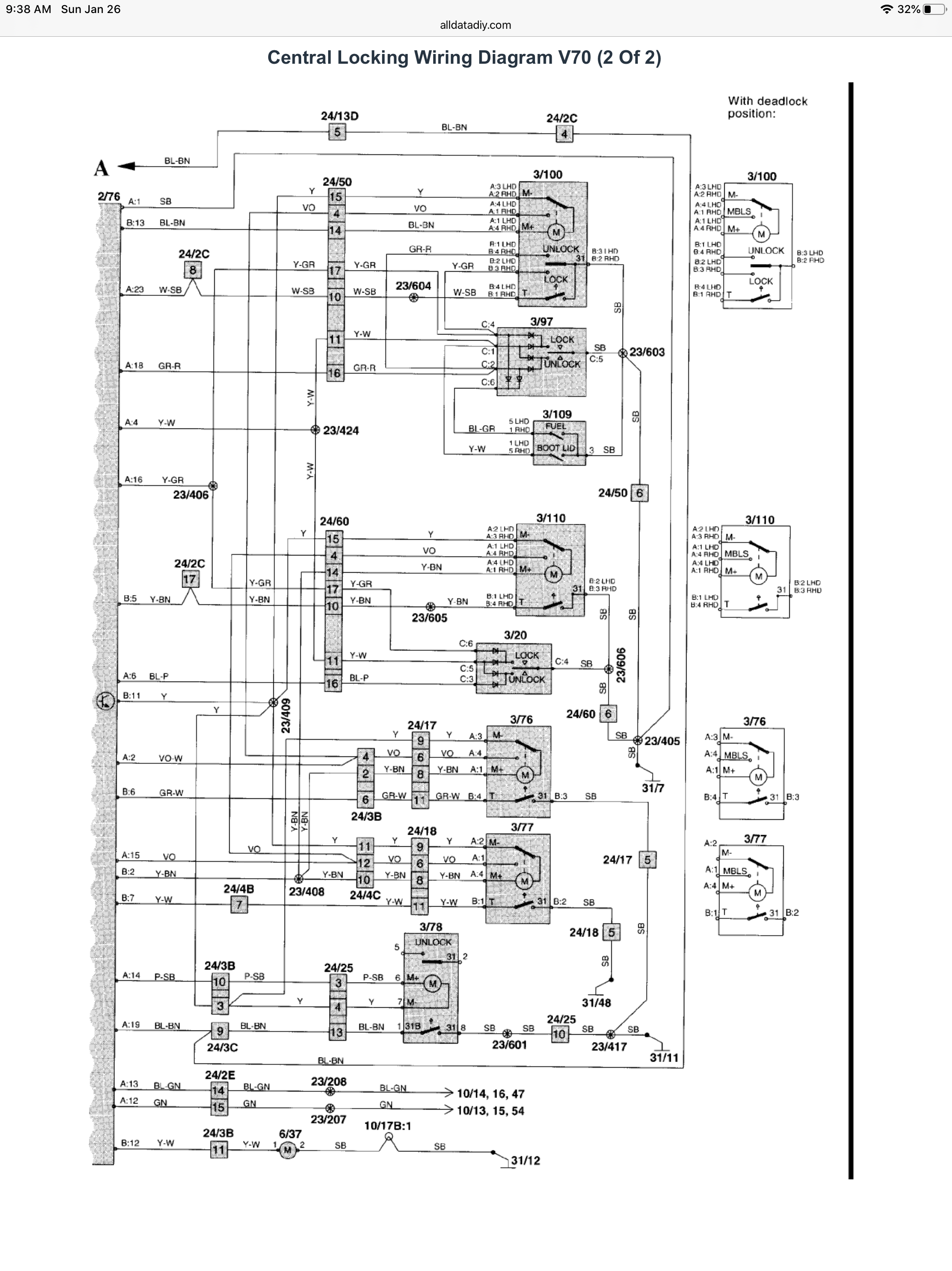

Adding the lock diagrams to thread for troubleshooting

CORVID Volvo Vacation - so going back after this one with Verve and Elan
Recap - logic related failure of interior lights. Lights stay on unless overhead switch placed in OFF position.
From cold start (car off for at least one hour, all CANBUS quiet) lights behave normally. As soon as key is in POS II, fault condition returns.
TODAY.....
Torx 8 and removal of passenger door harness.
LIGHTS now functionally normally.
Preliminary diganosis - passenger door fault in lock or switch sensor triggering 2/76 lock controller to stay active.

Reconnected door electronics, removed passenger side lock switch and lights work.
I bet this solves the key issue too, but we are headed for lockdown for four weeks, so that will be a while.
Current draw is now down to 45 mA, which is in range for this car when turned off.
1/2 battery charge drain time for 45 mA drain is about 40 days
