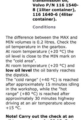

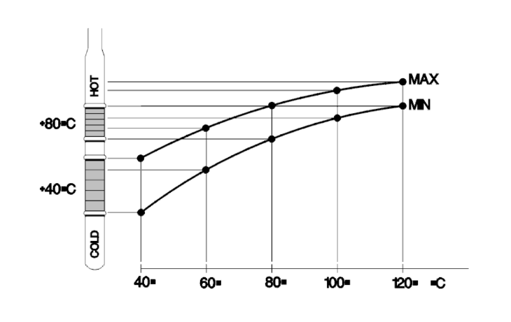

As I set out to measure the transmission fluid properly tonight, I found a few tidbits. VIDA has a fairly detailed description of the expected level on the dipstick at various temperatures, along with a handy chart:

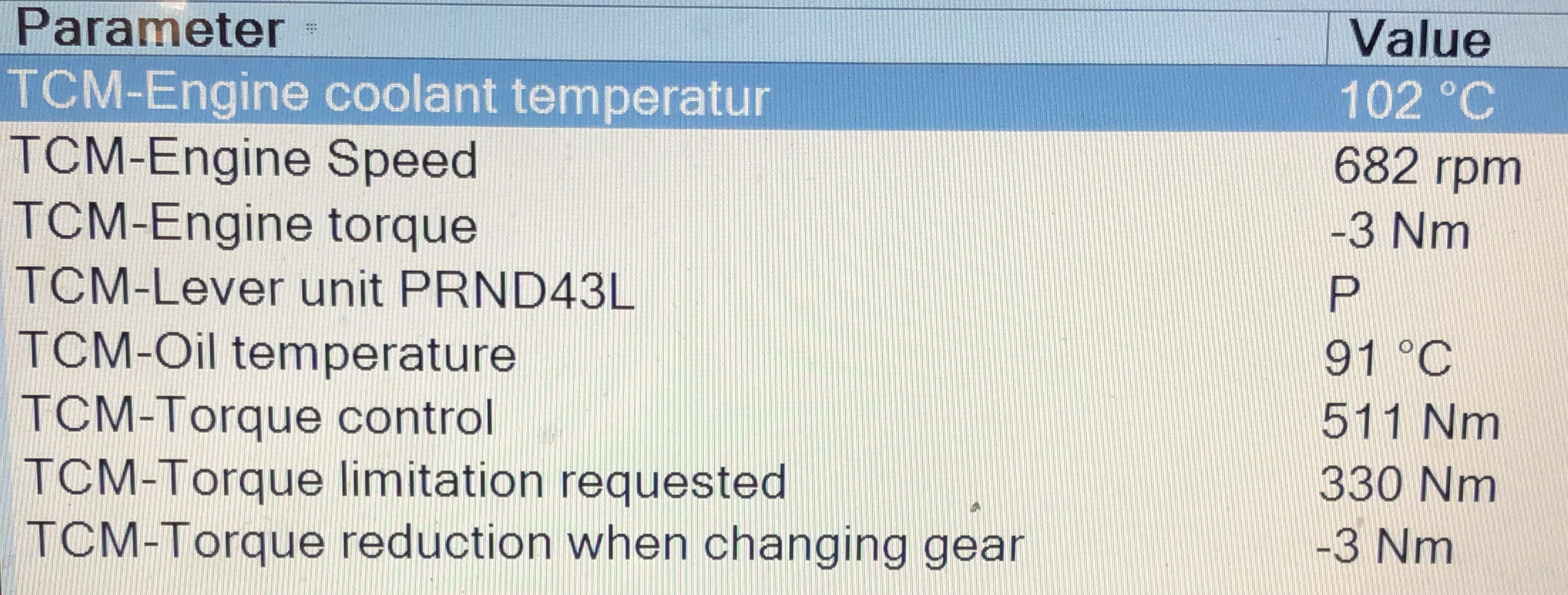

Here is the readout from VIDA of the conditions under which I did the check. I got the temperature up by idling in the driveway and shifting through the gears a few times.

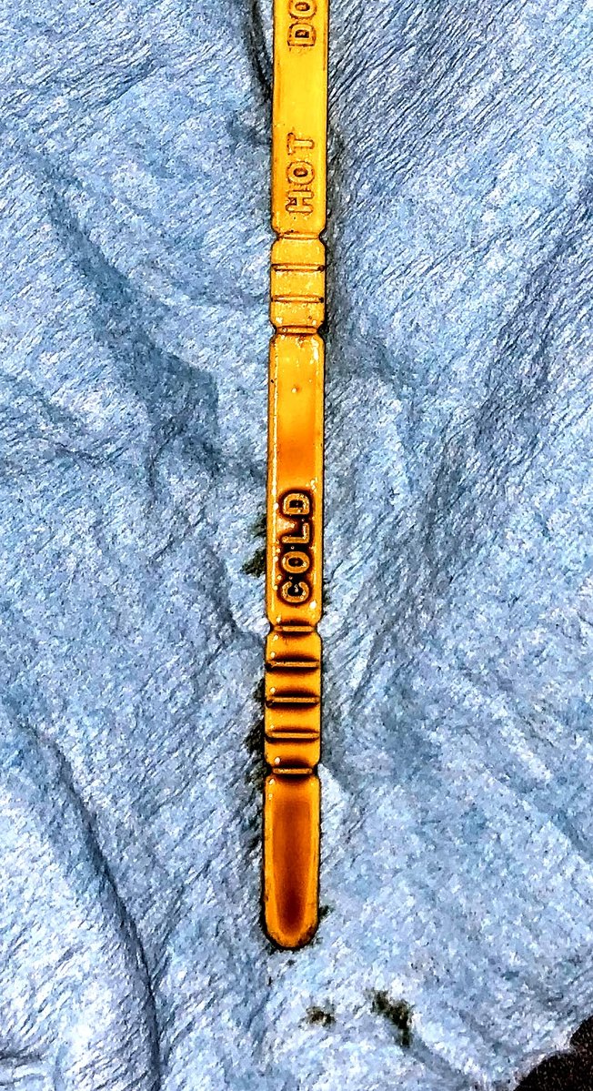

And, perhaps hardest to interpret, here is the actual dipstick reading (I did this three times with the same results):
I'm seeing at least some amount of wetness just above the highest HOT line. But the thicker fluid seems to end somewhere between the top COLD mark and the bottom HOT mark. Going by the lighter fluid it seems like I'm in the right range, but going by the thicker fluid it would be too low.

Just getting it warmed up from idling and manually shifting a few times in the driveway is only good for a COLD reading. To read it HOT you have to drive it through all 5 gears up to highway speed with a few stop and gos for ~30min.
Your fluid appears higher than average. Read the ATF where it's thick on the dipstick. The dipstick tube on my AT also leaves a small thin amount of ATF above the actual reading.

For a Transmission Oil temperature of 91° C, engine running.
I read that as below minimum. There is no Oil in the correct range.
Also noticed the engine temperature is ~ 10 ° C on the high side. You might want to check the fluid level right after a drive. This might bring the engine temperature down to 90° C and the Transmission Oil down to 80° C.

VIDA wrote:At room temperature (+20 °C) the oil level is close to the MIN mark on the "cold area".
I measured 40oz or 1.18L of fluid suctioned.
I drove a few miles around town and observed that incidence and severity of the "thud" had decreased; however at first there were also a few shift flares. I assumed this was due to TCM trying to adapt to the sudden drop in fluid levels. By the end of my afternoon commute, this had smoothed out.
This morning I measured the transmission fluid again before starting the car for the first time, and the fluid was at the MAX mark on the "cold area", which is .2L higher than the above specified level from VIDA, but not enough for me to consider draining more fluid. I drove to work today and experienced a couple of "thuds" but not as much as in previous days. I also took the car out for a highway run of 30 minutes, and measured the transmission fluid afterwards using the procedure specified in VIDA (well, mostly, except I had to make an assumption about the temperature since my VIDA/DiCE rig is tethered at home):
VIDA wrote: ...the "hot range" (+80 °C) is reached after approximately 30 minutes highway driving at an air temperature above +15 °C.
Park the car on a level surface.
Apply the handbrake.
Apply the foot brake.
Let the engine idle.
Move the gear selector lever to position P.
Move the gear selector through all positions. Wait in each position for approximately 3 seconds.
Move gear selector to position P and wait approximately 2 minutes before checking the oil level.
The dipstick must be pushed down as far as possible into the dipstick tube.
The level at this point was LOWER than when I measured first thing in the morning, and in fact just barely reached the tip of the dipstick. Based on this measurement, taking into account the distance between the MIN/MAX marks in the HOT area, I extrapolate that the dipstick is telling me the fluid level is low by approximately 1.5L, or in other words just slightly more than the amount I drew out the other day.
