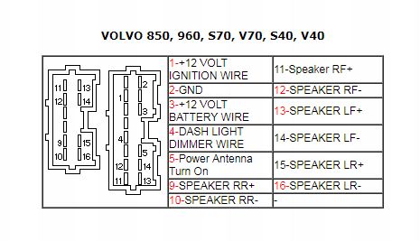

I like to set up my car stereo so I can use it even with the car off, and ideally so the cigarette lighter socket can deliver power too, so I can leave my phone charging. I usually just hook up a switch between the constant 12v+ and the switched 12v+ in the stereo harness, but I did that just now with my SC-816 and blew two fuses...
Can anyone think of a reason for that, other than user error?
I verified the wires with my multimeter and all looked good. No power to the switched line until I turned the key. Other line had power always.
And this diagram agrees with my wire choices:
https://www.tehnomagazin.com/Auto-radio ... nector.htm
Connecting one of the green/brown wires (constant 12v+) to yellow/purple (switched 12v+). In this diagram that's wire 1 and 3.
Making the stereo work with the key in the off position...

- wiring.jpg (27.6 KiB) Viewed 1141 times

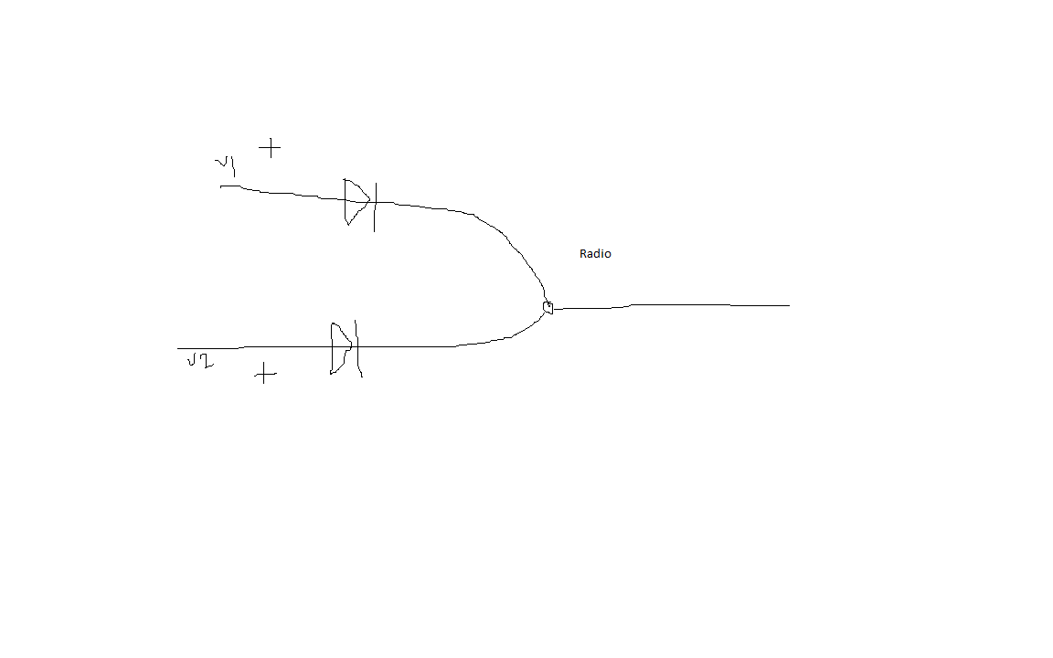

My thought is one of these on each power line (aka V1,V2) going towards the radio should do it... They are basically one way valves for electricity.
pardon the garbage schematic no guarantee I have the cathode anode correct, it's just here for purposes of clarity
https://www.amazon.com/RUITASA-Schottky ... 4253919969

The diode needs to be rated for the expected power draw if about 10 watts for the charger, plus 50% margin

Absolutely...abscate wrote: 26 May 2019, 01:44 The diode needs to be rated for the expected power draw if about 10 watts for the charger, plus 50% margin
These are rated for 10 amps each. Worst case scenario he uses two or three in parallel for each voltage source.
