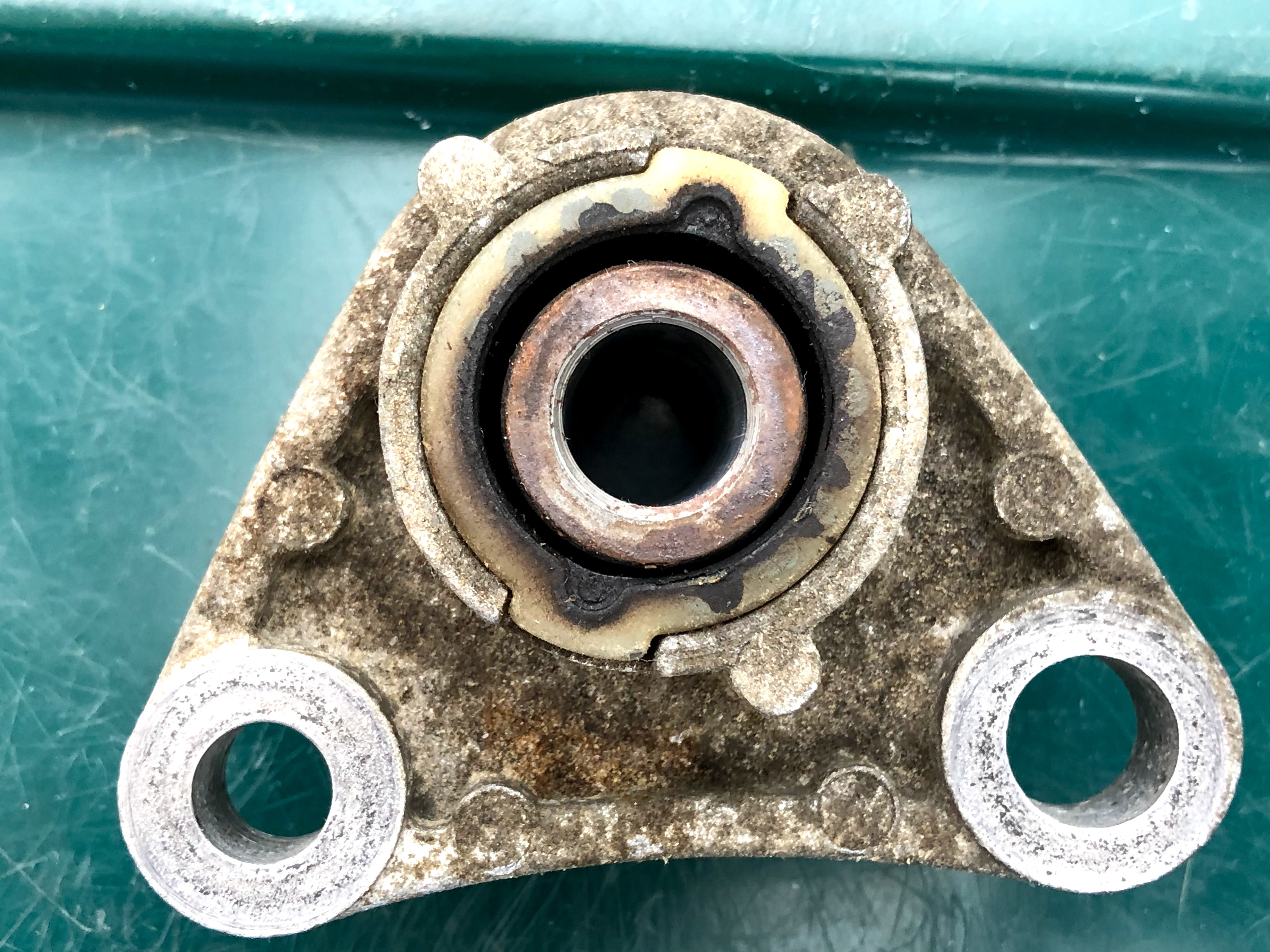

Update: Last night, I did the following:
- Reset the ATF fluid counter using VIDA.
- Removed and disassembled engine stabilizer mount and bushings, cleaned, and reinstalled with all bolts torqued to spec.
- Inserted chunks of rubber hose into gaps around top engine mount bushing. This reduced movement of the bushing significantly.
I took a few test drives, and the thud is still occurring. I suppose the transmission could need more time to adapt after the fluid change and counter reset.
The one thing I haven't done yet, which a couple of people in this thread have mentioned, is replaced the stabilizer bar bushings. Here is how they currently look after being cleaned:
It looks like I could get new OE mounts from FCP for $17 each. iPD has the previously-mentioned polyurethane stabilizer bushing insert kit for $11, an aftermarket set of the complete mounts for $30, or $50 for a solid aluminum set of mounts to make the bar completely rigid.
I'm sort of getting to the point where I may not chase this down any further, because the problem doesn't honestly impact drivability in any way, it's just annoying.
