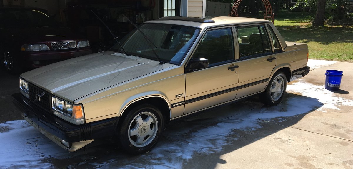

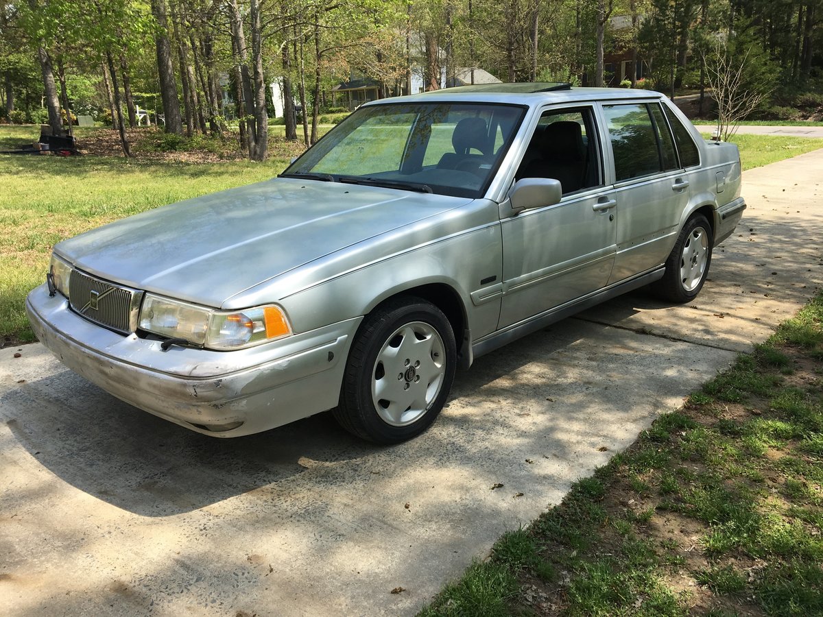

Can you post a pic of the 740 you use to have and the S90 you have now?

Yeah, I have a '98 S90. Picked it up back in March for $100. It needs a transmission, but it's still kind of drivable. I'm thinking about swapping in a T6 engine from an S80/XC90. And replacing the trans of course!
