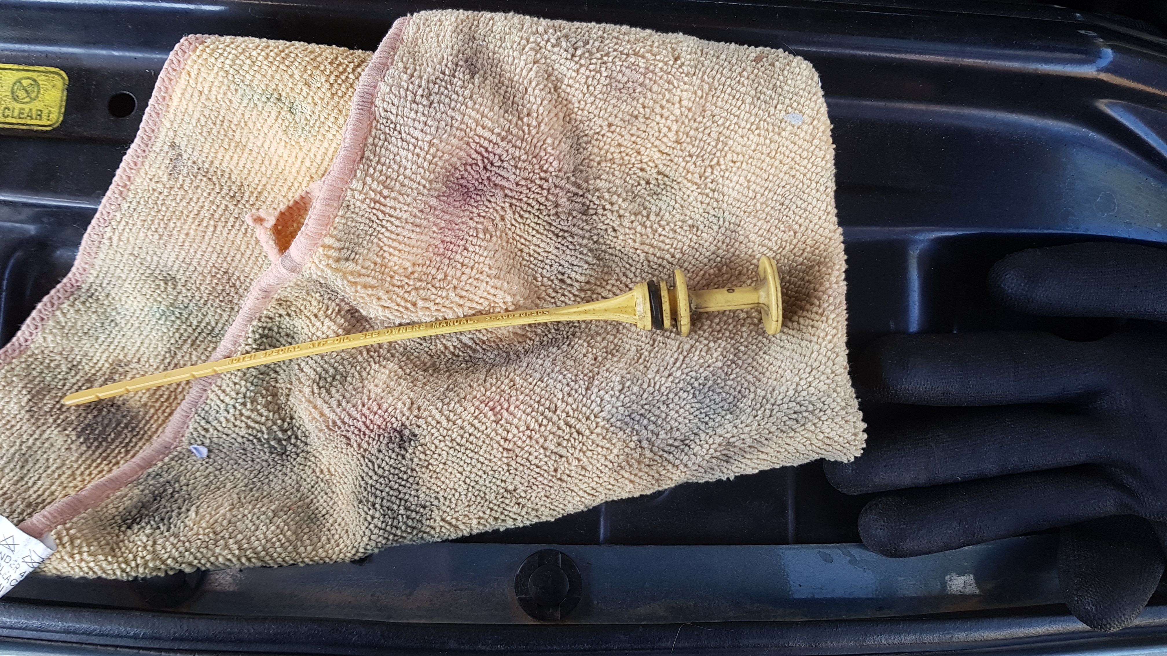

Thanks, but this look more like previous years, mine now is a 2007. I think I will just take air filter or everything easy on the top. The car is beautiful...

Go to Volvo user manual online and check the manual
The trend in cars is to eliminate the dipsticks for sensors - a practice I abhor.

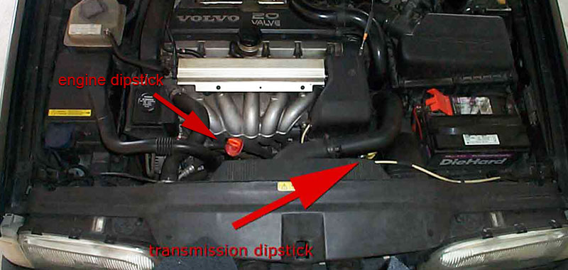

On my '98 C70, I got to push a intake air hose aside to see the transmission dipstick from above.
You might try sticking your head under the car and look up to locate it.
I think the newer ones have a shorter dipstick tube, look way down deep from the top.
