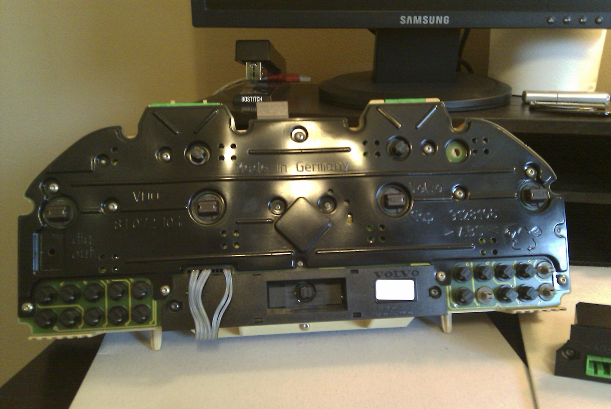

Earlier 850 clusters clusters have a wire harness on the connector, later ones and all 96-97 have a ribbon connector. If you have a ribbon connector style then any 95-98 (yes, including 98 S/V/C70 clusters) will swap right in. If you have the earlier style it will be harder to find. My 95 has the ribbon style, I'm just not sure when the switch happened. If you are unsure, pull the dash cover, take a pic of the connectors on the back and post it up.

It all depends on whether yours is wire harness (probably the 94 will fit) or ribbon harness (probably need a newer one). You need to check.

Turbo or non-turbo matters if you want the vacuum gauge on the left side, that is present in 95 and earlier turbos. Otherwise, for example, a 96 turbo cluster works just fine in a 96 NA car, there is no difference in the cluster itself. I was assuming your car is non-turbo but if not, let us know.
Here are some useful pics regarding what I have been talking about.
Top is gray wire-style connector, bottom is white ribbon-styler connector.
And this:
If you want input on your options, let us know what you have.
