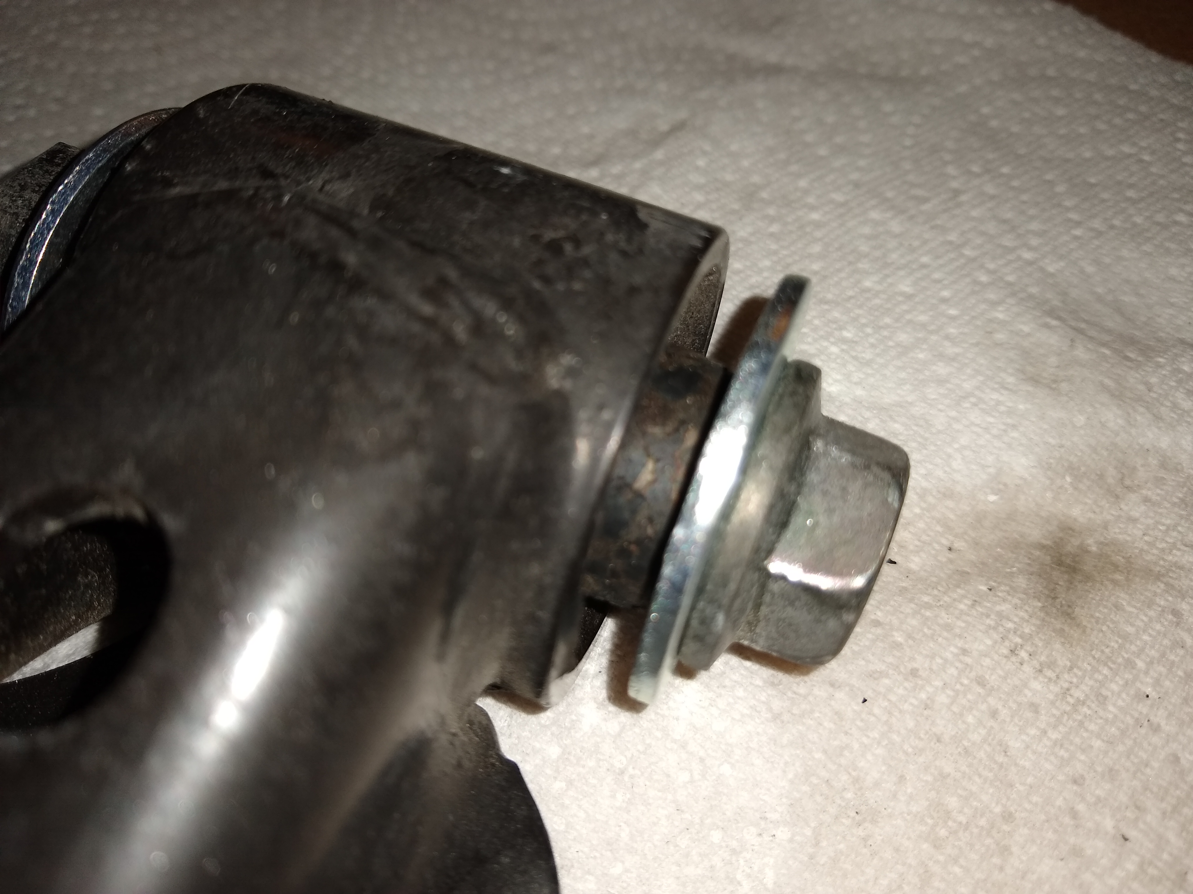

I plan on starting at the top and later to the torque mount, sub-frame bushings, control arms and lastly front engine mount. Everything will be cleaned de-greased and sanded where possible for adhesion. The Upper Mount inserts are shorter allowing for a greater amount of Poly while the bottom will provide a connection for the inner and outer poly. The white PVC Cap (Home Depot) was trimmed in two spots so it can be centered on the mount. Doing one side at a time for better curing.
Upper Engine Mount - Saw IPD selling inserts for their Poly Mount so came up with this before applying the Poly to the entire cavity. This alone would add longevity to the mount.
If you want to try this and think the hoses might slip out just use a zip tie around each or a little Poly Sealant.
Strut Bar Mount I discovered I couldn't use the IPD Poly Inserts as one is solid on the bottom. Will try using the middle washer to tie it solid to the Strut Bar and hopefully the extra Poly will absorb some of the vibration. If not the center washer will be remove to allow a little more flex. Regardless both will receive the Poly treatment including what little I could put on to the top of the mount.
Strut Bar Mount Lastly, the strut bar mount. This is a solid mount but if you hit it with a dead blow hammer you'll see it shift some what easy from side to side so Poly will be added and smooth out with the finger around the bar and washer.
I will apply a thin coat of dielectric grease on the the PVC cap and washers in hope it can be removed easier after everything cures. Read somewhere that Volvo should have used a slightly larger bolt or have smaller holes so the bolts don't bounce around. During installation the bolts will be coated with Poly to fill the gaps and provide some vibration and dampening properties. Let me know what you think whether good, bad or improvements. Thanks.

Starting the experiment this evening with the Strut Bar Mount that could fit an IPD insert. Wanted to first try an area that can be shallow filled to test for cure time and bond. Was going to use a clamp but the Poly flows like chocolate pudding and even smells like chocolate pudding. Hope it doesn't tastes like it.
I cleaned the part with a tooth brush and 90% alcohol besides sanding where I could. Only put a thin film of Die-electric grease on the blue tape of the washer. Will see if it reacts with the Poly and if the blue tape around the hose clamp sticks or can be peeled off easily.

Engine Mount: Decided not to use the white End cap in previous post to extend the width of the Poly as cure time was too long. Filled engine mount pivot with Poly (forgot picture). No noticeable movement of engine when revved causing the feel of quicker throttle response while driving. -
Strut Bar Mount - Used hose clamp to build extra Poly on bottom. Used washer to tie entire system together. Used Poly to fill bolt hole to further eliminate potential movement. -
Strut Mount & Bearing - Since the car has KYB's (Don't Care For Them) I decided to stick the two parts together and see what it's like when the mount separates. Fill the inside but clearing the star nut.
