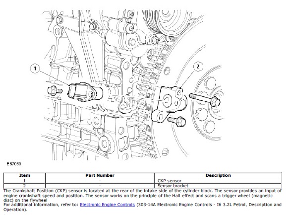

Things that can break that will prevent starting
Crankshaft position sensor - if the signal isn't strong then the engine may not start
Clogged fuel filter - this seem s very unlikely you don't have problems once it starts
Broken fuel pressure sending unit - The system is return-less and it is strongly dependent on this signal

I tried this just now, at first crank nothing, second crank it moved the needle then stopped, third crank did nothing. It seem to deplete my battery fairly quickly attempting to start. Its now back on the charger.
I have replaced the crankshaft? or camshaft position sensors.(the 2 sensors on top of the head)
The fuel filter is new. Is the sending unit the second piece in the fuel pump on the other side of the gas tank? I have opened it back up to make sure there was fuel in the "cup" of the pump.
edit: also changed the fuel pressure sensor and the battery last September when the issue started, I change the fuel pump and it drove great for a month or two then died. I pulled the pump and replaced it again discovering the kink. Installed a second fuel pump and it started up.

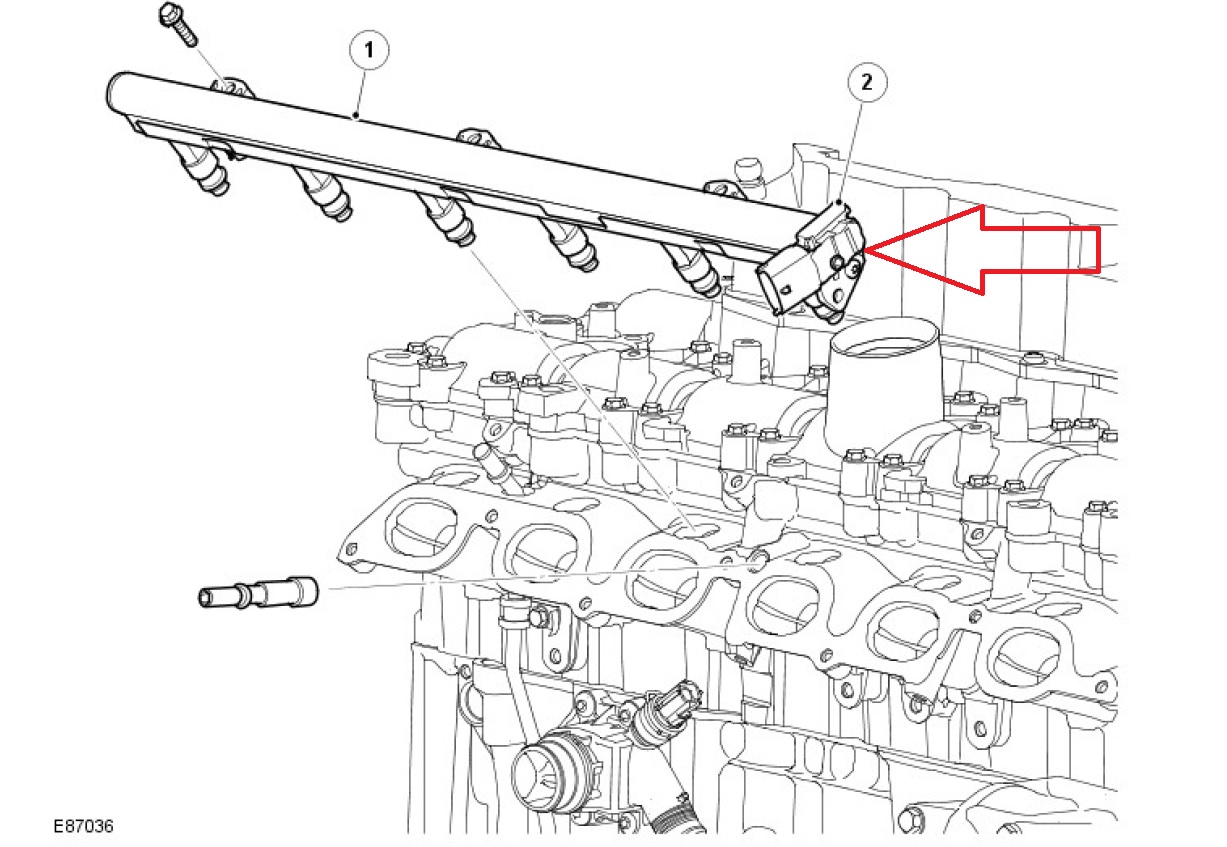

Dan^2,
I don't have VIDA so I can't answer that.
Did you replace the sensor shown above with the RED ARROW?
If yes what did you buy? Part number? Manufacturer?
From the LR2 manual (note: this should be similar for the P2 XC90 but I can't be sure)
Starting process This will be different for the XC90 because you don't have a dock just a key
With the remote handset inserted in the start control module and the stop/start button is pressed, the start control
module issues battery voltage high signal on the LIN bus connection to the CJB and the fuel pump is run for 2 seconds to
prime the fuel system. The CJB uses this signal together with the stop lamp switch signal and issues a crank request
message on the high speed CAN bus to the ECM.
Fuel Pressure Regulation
Fuel pressure regulation is controlled by the ECM to respond to fuel pressure demand and provides stepless control of the
pump output using the FPDM to control the pump operation. The ECM can vary the fuel pressure to between 55.1 lbf/in2
(3.8 bar) and 72.5 lbf/in2 (5 bar). The high pressure is only used in extreme conditions such as heavy engine loads and
engine starts.
The ECM uses the signals from the fuel rail pressure/temperature sensor to determine information regarding the pressure
and temperature of the fuel and provide precise injection periods, improving engine starting under all conditions. The
advantage of controlling the fuel pump output pressure are that pump power consumption is reduced, lowering the load on
the power supply system and reducing fuel consumption, improved service life of the pump and reduced fuel pump noise.
