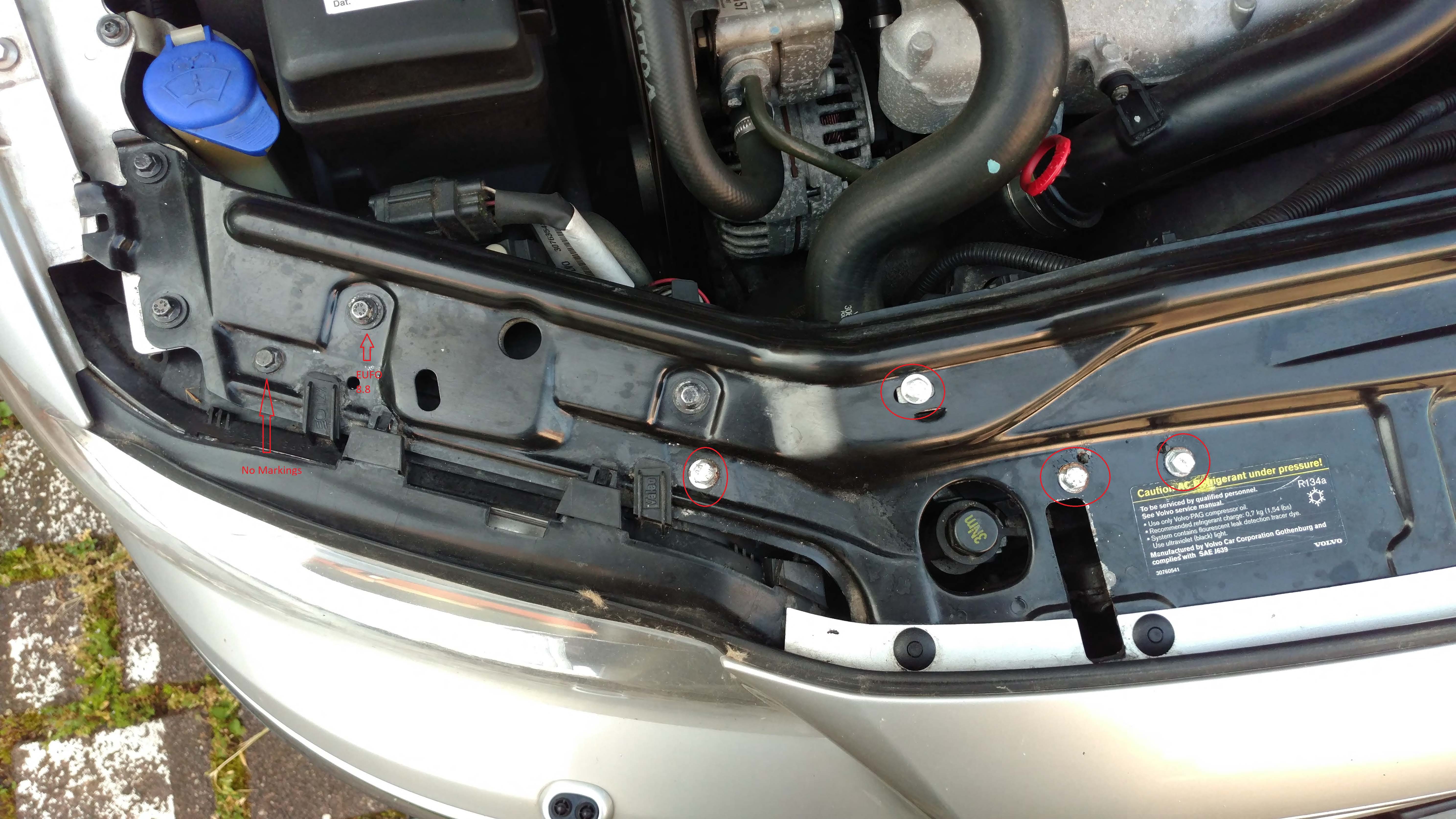

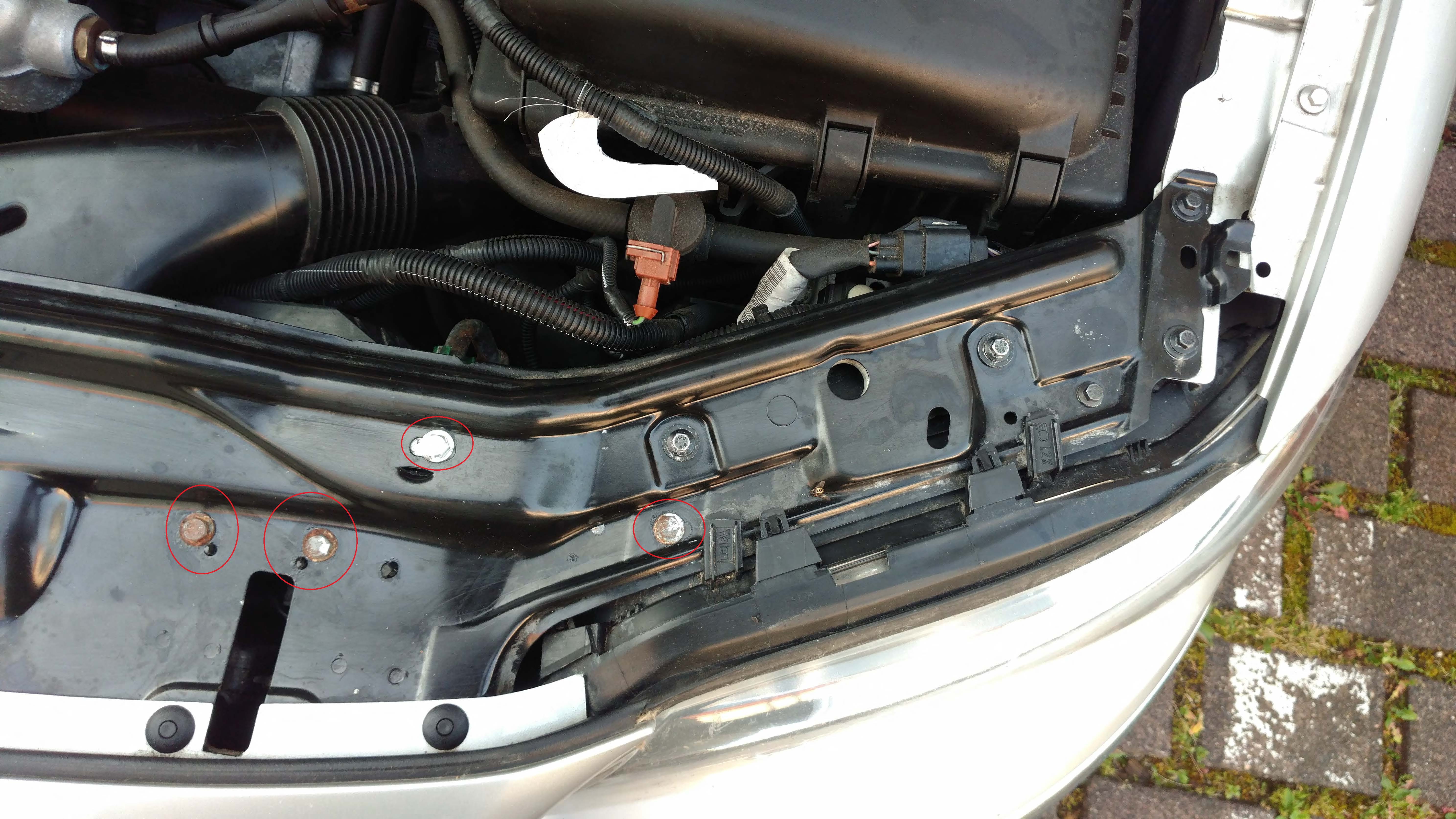

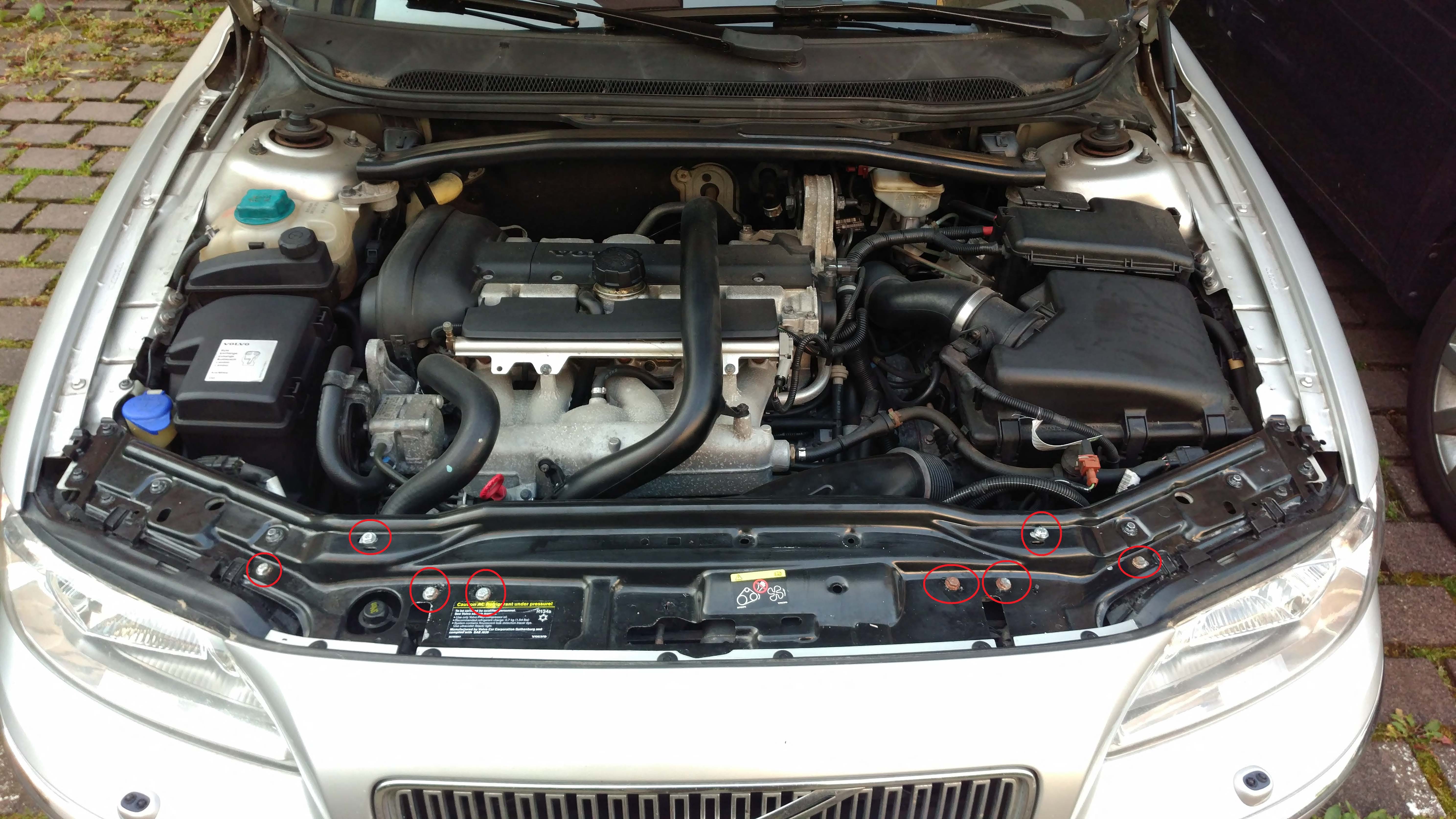

I have some rusted flange screws under the hood, in the mounting bracket that covers the radiator.
It looks like the previous owner or his shop replaced the black Volvo screws with some steel ones that are rusting out.
Can someone please let me know the OE part numbers for these screws so i can replace them with the black ones that are rust resistant?
couldn't locate a parts picture that shows these screws or identifies them on a Volvo blow up picture.
Some of the OE flange screws have the words "EUFO 8.8" on them, while other OE flange screws do not have any markings on them. This leads me to assume that they are possibly varying lengths.

Here's the parts diagram for the section you're looking at - I think the screw and washer in question are #17 and #18.
https://usparts.volvocars.com/a/Volvo_2 ... 74661.html

Your engine bay looks immaculate! I have managed to get mine washed really well, but I haven't taken the time to shine out the aged black plastic covers. Good work!

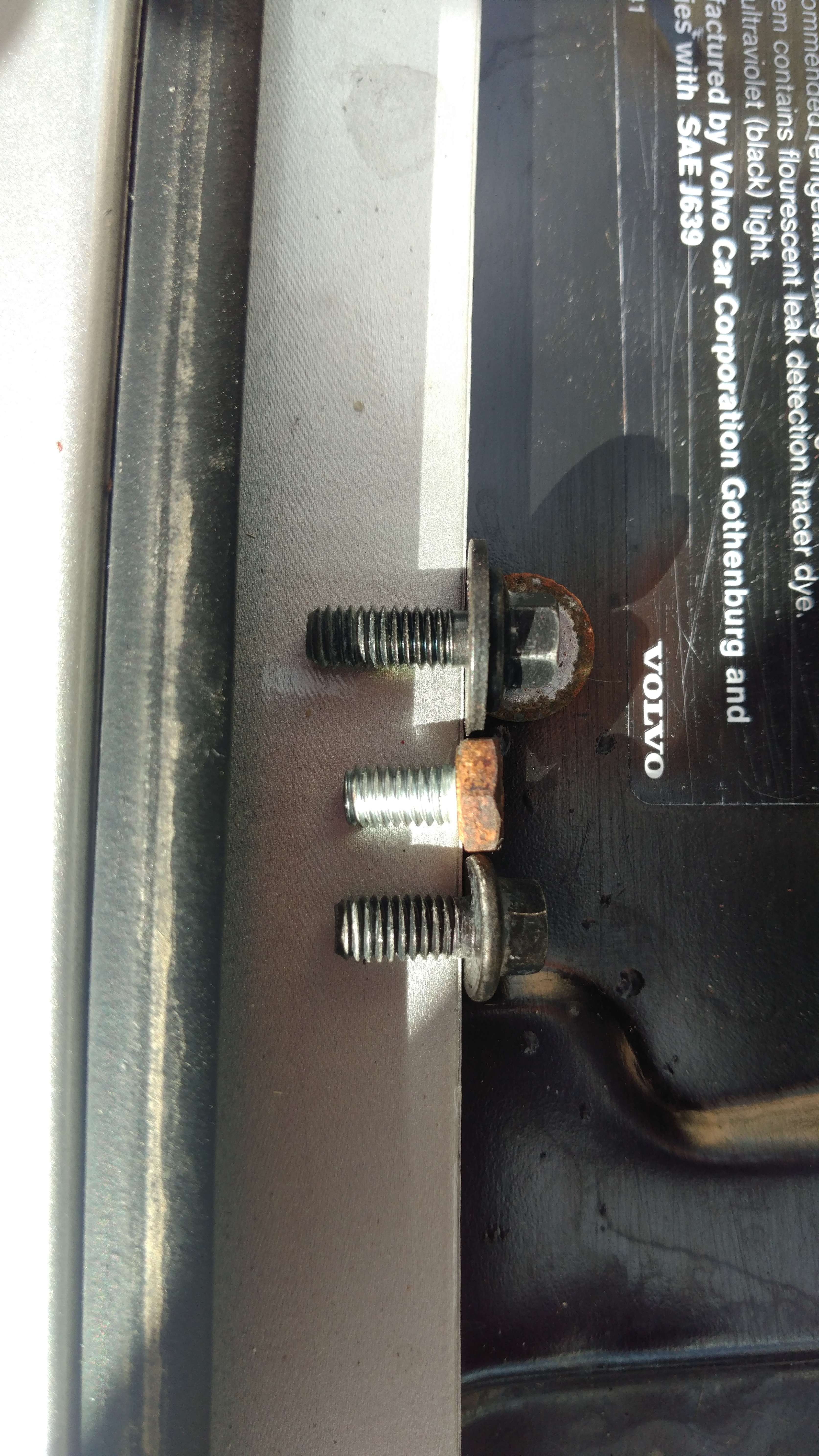

Just wanted to follow up.
I pulled one of each bolt as recommended and all three were slightly different lengths.
I believe that the rusted bolts were M6 x 10mm, the black flange bolt with the 8.8 on it is M6 x 16mm like in the parts page posted by the other commenter and the black flange bolt with no writing on it is M6 x 12mm or 14mm.
I believe if i buy the M6 x 16mm in the link, it will work for all the bolts, the black washers are sold separately, I'm looking at like $40 bucks for the bolts and washers, i may just but some zinc flange bolts from Amazon without the washers and just call it a day.

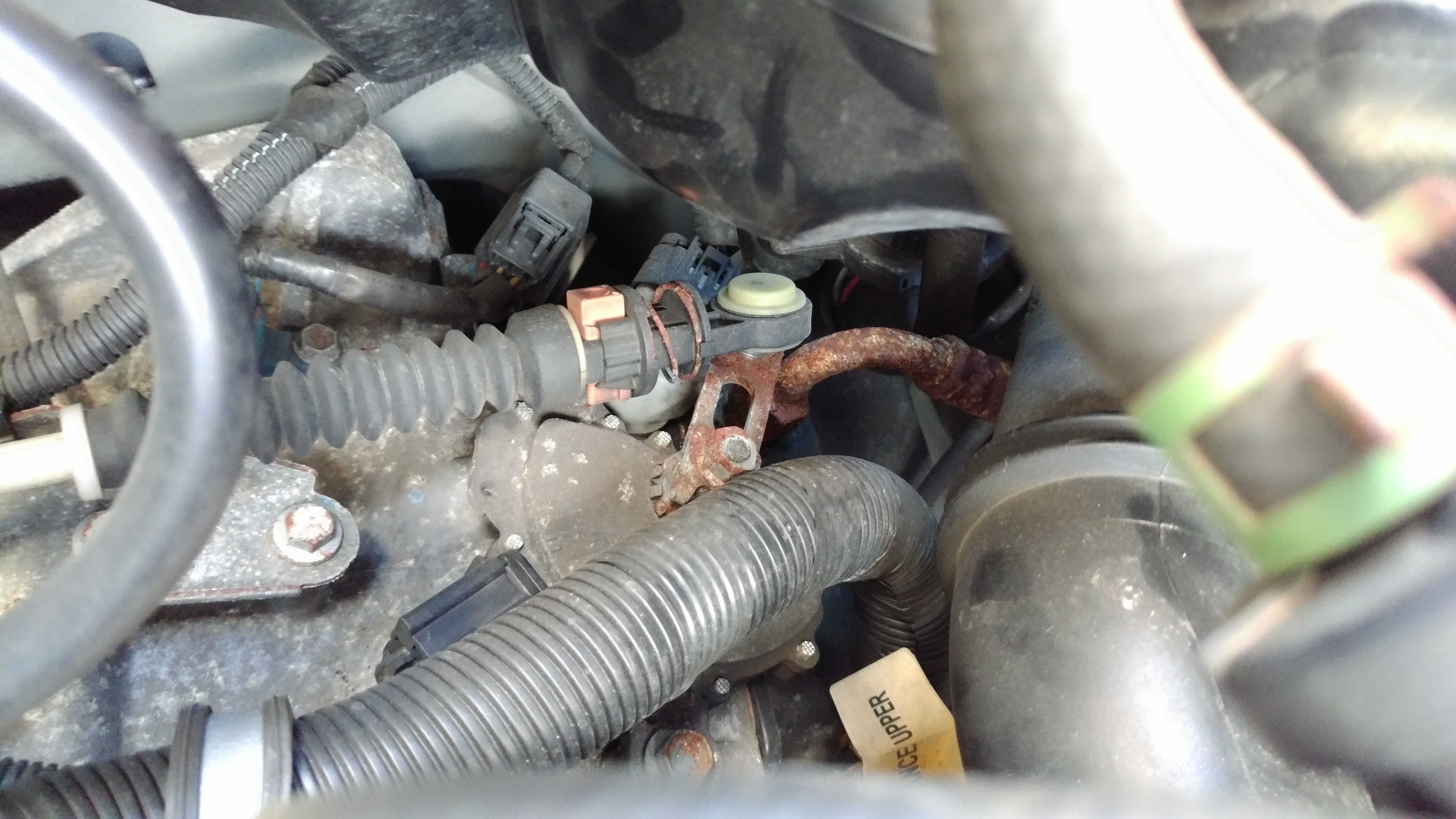

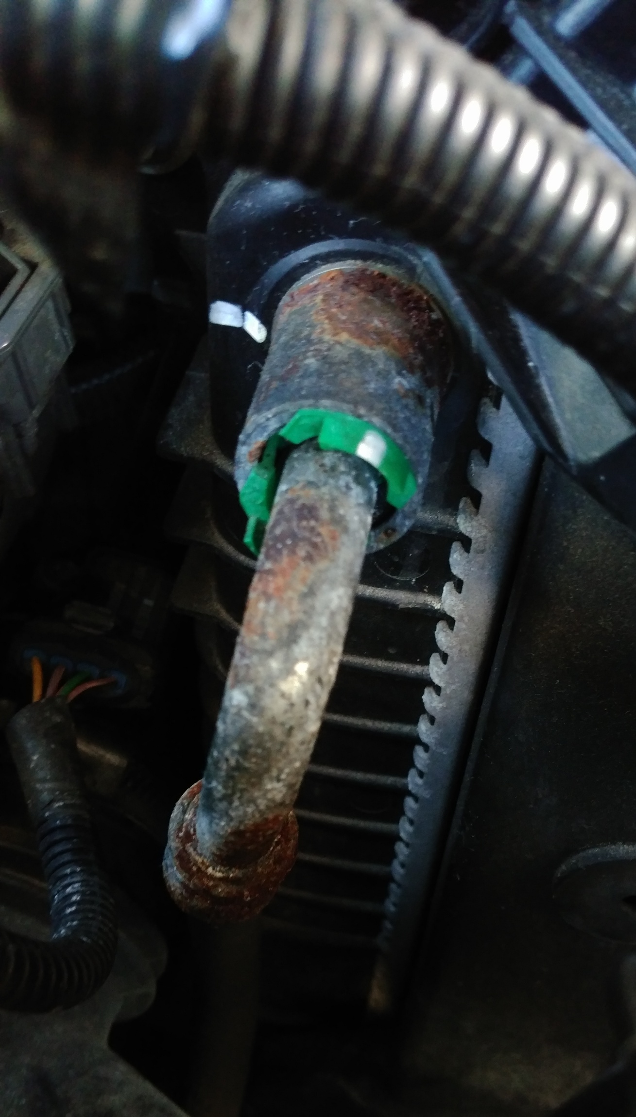

When i was looking at the bolts i noticed that my transmission cooler return line looked pretty gnarly and rusted as well. Would you guys worry about this transmission cooler return line looking the way it is and change it or would you leave it alone?
The metal part that goes into the radiator and the metal part that connects to the transmission have a lot of surface rust, not sure how far into the metal the rust goes.
