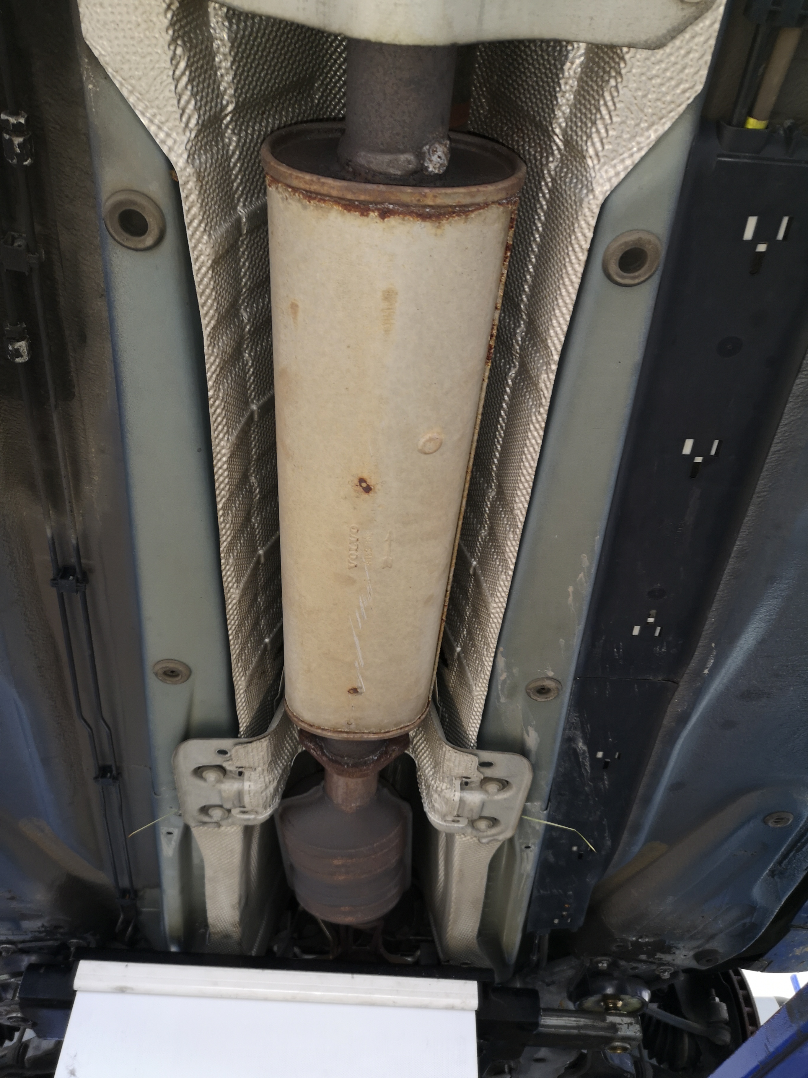

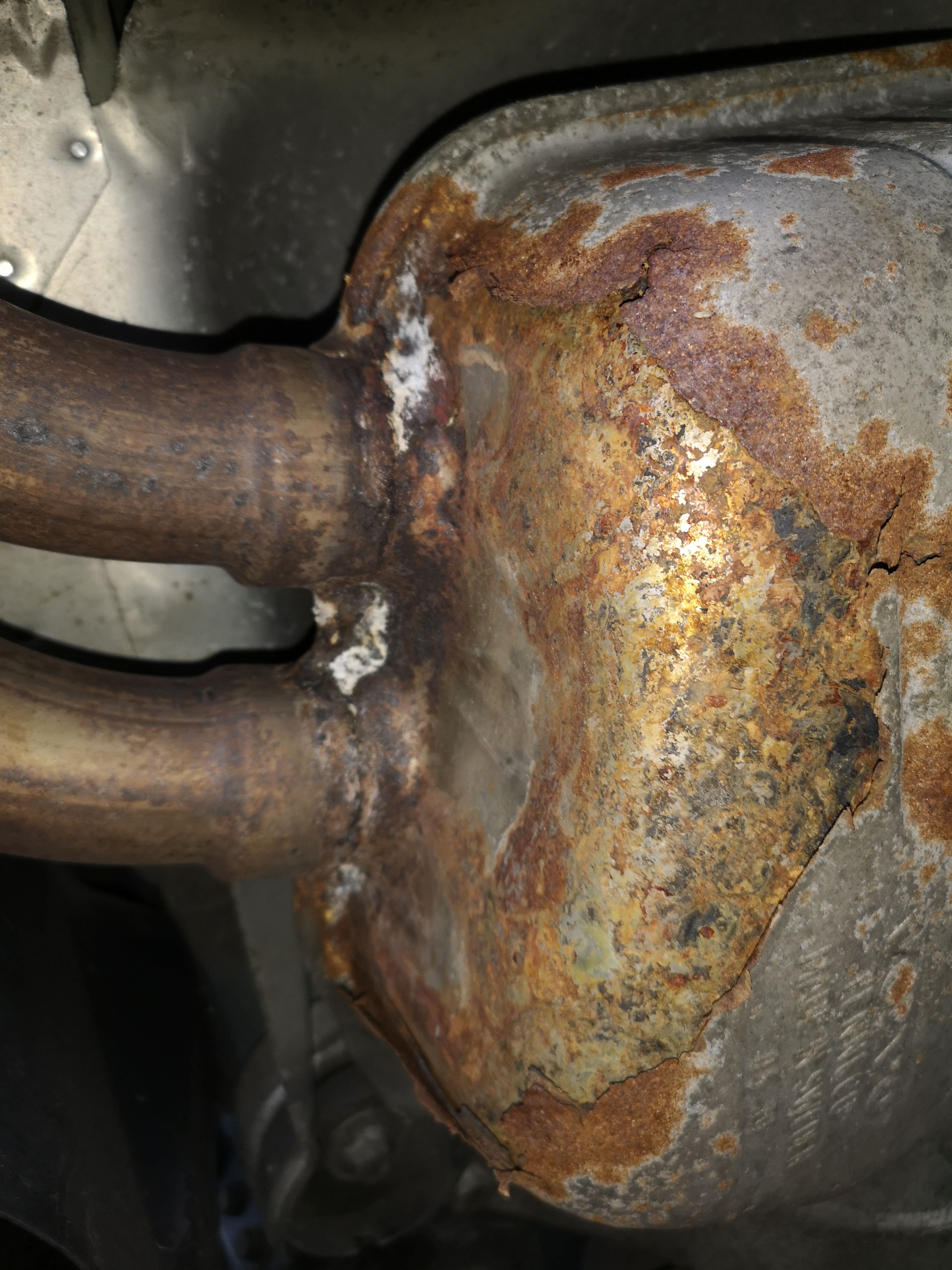

Heat shield/outer layer on back box is rusting. Exhaust still fine.

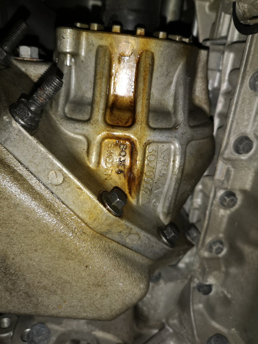

Going to need to look at AWD. Front and back box is a bit oily (only bits that are)

As far as the oil on the underside of the transfer case/bevel gear, look up above it, up to the turbo. Just about every turbo P2 I've looked at leaks at the turbo's oil return line. It's really nothing to freak out about if this is the case. All of our cars leak a little bit from that exact spot.

Thanks very much. Back in the garage tomorrow (rear pads, handbrake cable, aircon recharge and wheel alignment) so I'll have a look.
