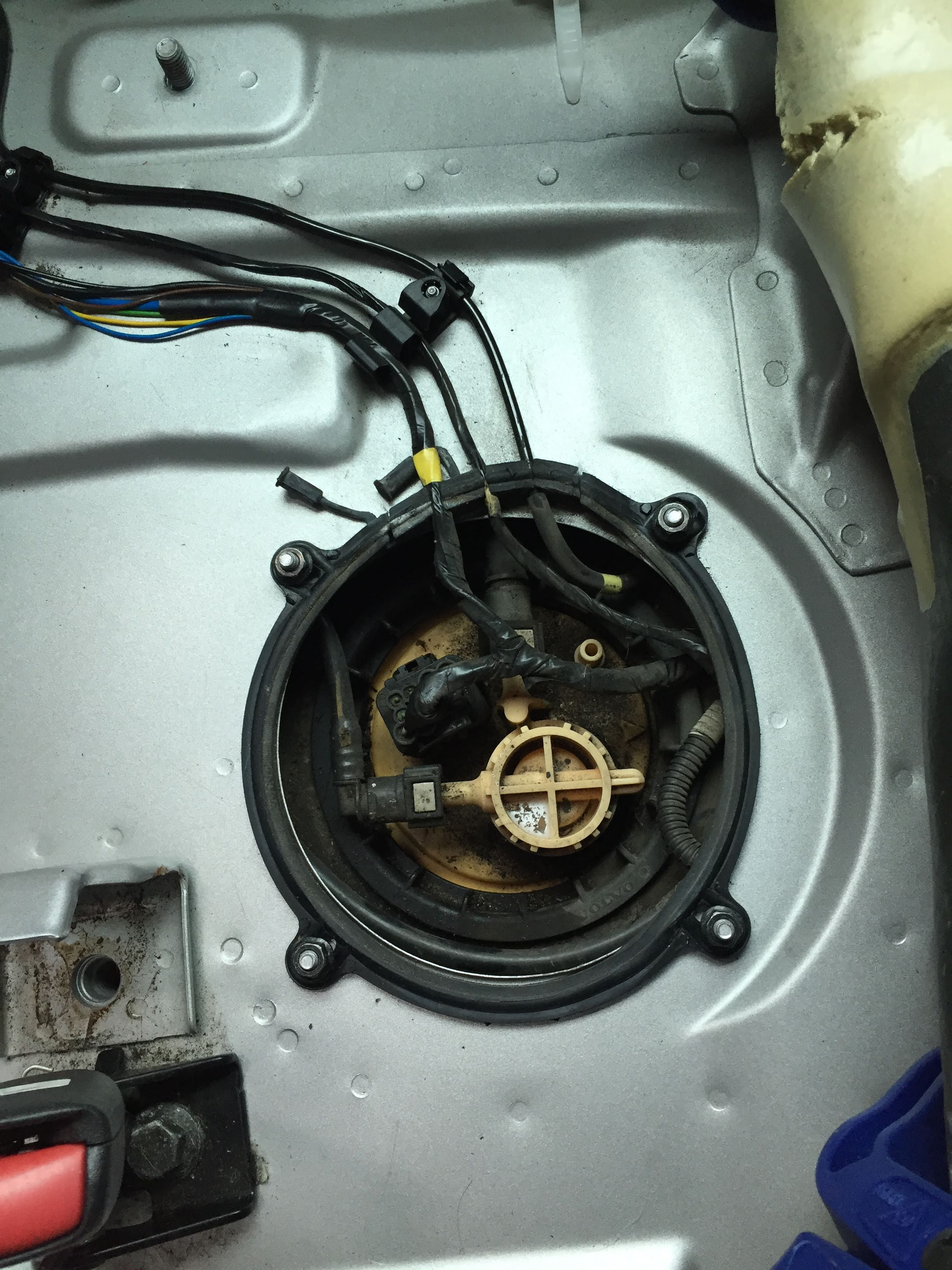

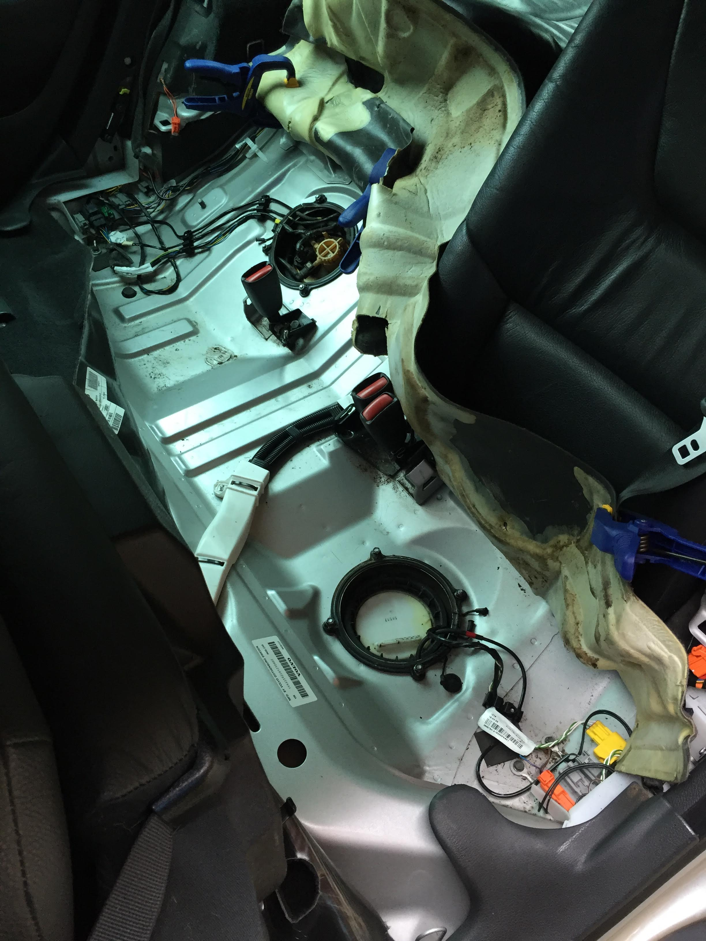

Hi guys,
I am just about to embark on this adventure today, and thought of a question I'm hoping someone can help with... Here's my status:

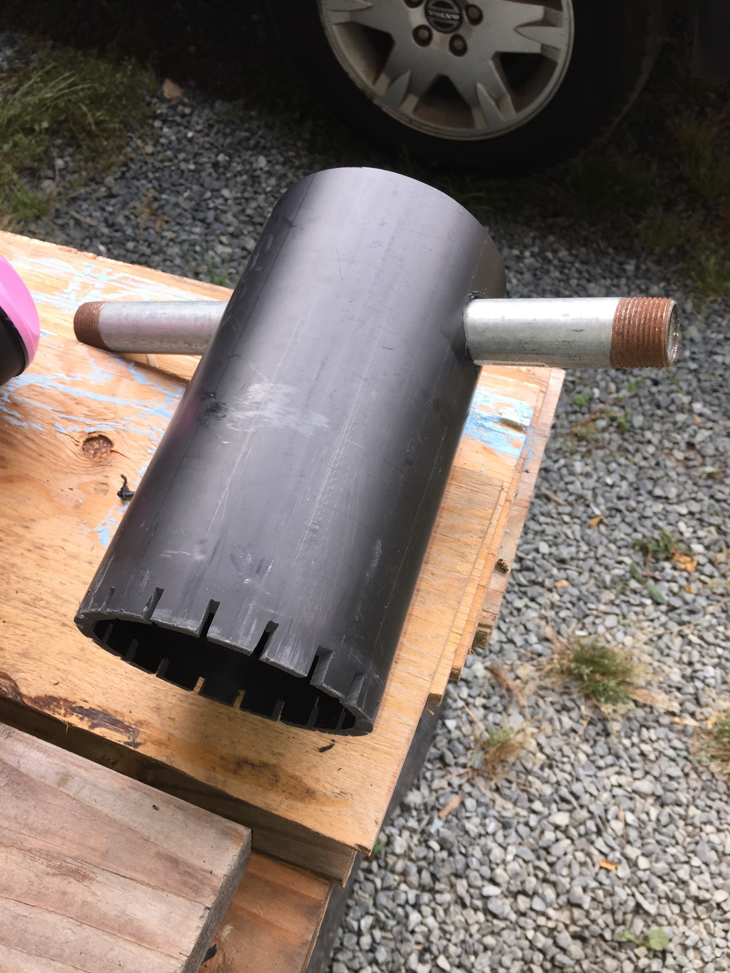

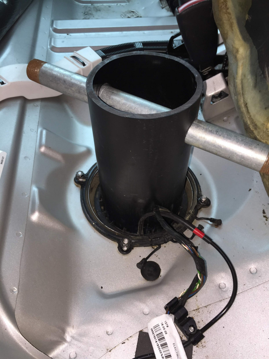

So far I have everything removed and exposed, with both covers off. Yesterday, I made a homemade 4-inch ABS pipe "special tool" and it worked beautifully to remove the ring on the drivers side. Thanks for that excellent idea! I took off the cover on the drivers side and popped it up slightly to allow me to siphon out most of the fuel in the tank.

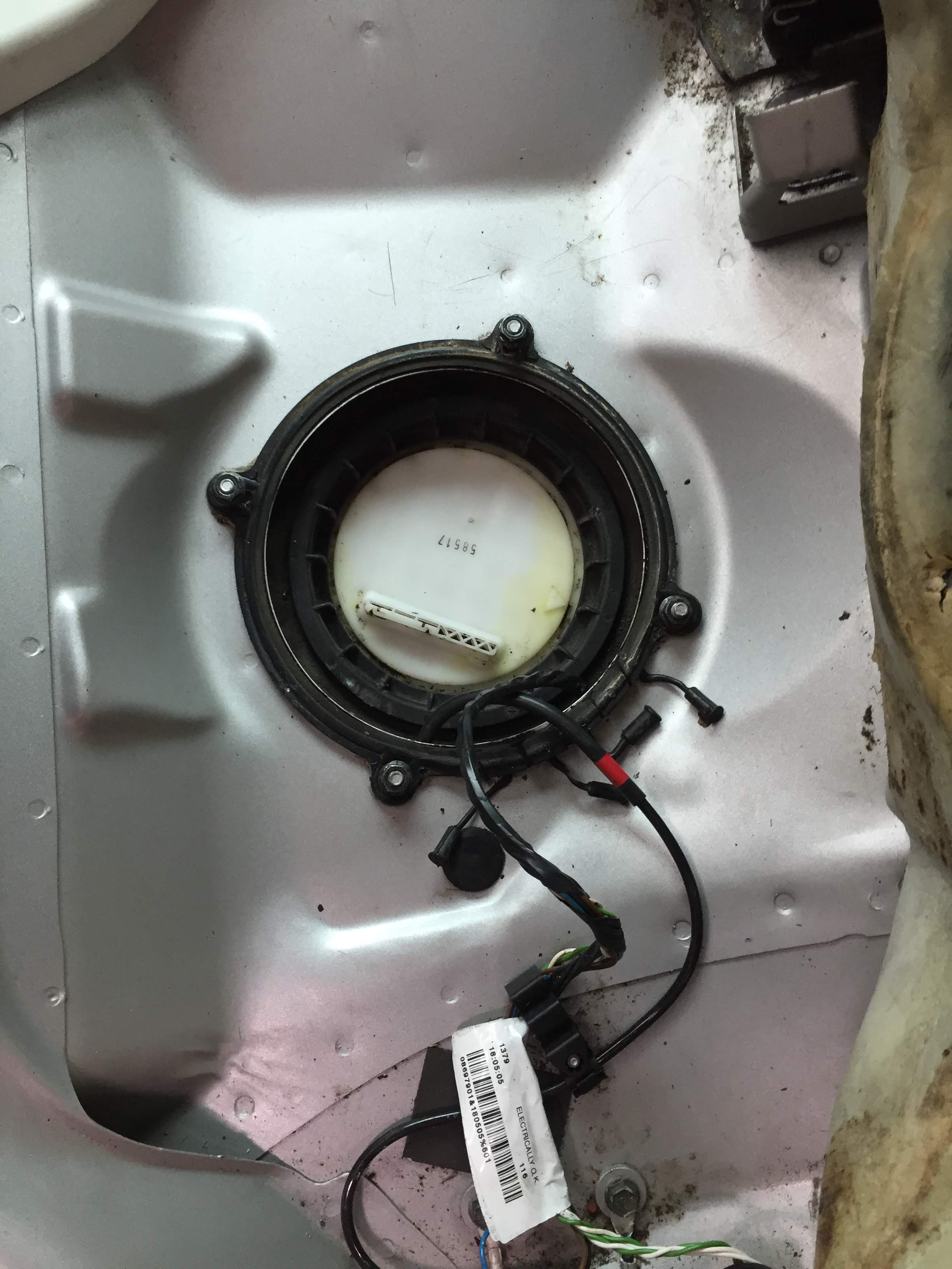

When I looked inside the drivers side access port, I was surprised that the suction pickup (white plastic piece on the end of the black suction line) was not attached to the floor of the tank or to the bottom of the cover apparatus. I am a little confused by this section in the original post:
"Hard to describe, but you will see it when you pull the cover up on that side. Here is what you are pulling up (sitting upside down in the photo). At the end of the suction line is a plastic piece which fixes on the bottom of that piece. Obvious when you see it, but hard to describe."
My question is: Is this white plastic suction piece supposed to be attached to the bottom of the cover apparatus, or to the bottom of the tank in some way? Is it really supposed to be loose, just sitting in the tank?
Thanks for any help
**Update - 7/7/19
I completed the fuel pump replacement yesterday, and this appears to have solved my problem of the car dying intermittently once fuel level dropped below half tank. Success!!
In completing the project, I answered my own question from above. Looking at it more closely, it was clear that the white suction pickup near the end of the black suction line that extends over to the drivers side fits onto the bottom of the drivers side cover apparatus/fuel level sensor. Specifically, it slides into the rectangular slot in the bottom of the cover and snaps into place. Unfortunately, I didn't take any photos of this, but that was clearly one problem I had, because as I mentioned, it was loose when I first accessed the drivers side port.
Otherwise, the instructions in this post worked beautifully. Getting the old pump out was a bit difficult because the black tube that runs up the side of the pump housing had come loose in the tank and was sticking out sideways. I had to bend this enough to kink it to get it out of the opening. The black tube I'm referring to here is one of the two lines which run over to the drivers side. It runs up the outside of the pump housing, ending with a short 90 degree elbow at the top of the plastic pump housing. It just snaps into a groove in the outside of the pump housing, and I found that it can pop out of this groove rather easily when I was installing the new pump. The fact that this was loose was likely contributing to my problem, and I found I had to be very careful when inserting the new pump in order not to have this pipe come loose.
I used the "messenger line" approach in the following way, and it worked perfectly with no hangups or difficulties. I tied my line to the looped end of the black suction line on the drivers side just before removing the old pump. Obviously, at this point the drivers side level sender/cover was removed and the wire was disconnected. I had also removed the retaining ring from the fuel pump side and disconnected both fuel lines and the electrical plug. Once the line was securely tied to the loop on the drivers side, I removed the old pump (a bit tricky, but came out ok by slowly working it from side to side). I put the old pump into a rubbermaid tub as suggested in the post. There was a little bit of dripping as I pulled the black suction line through to the passenger side and then untied the messenger line. At this point, I took the tub containing the old pump and black suction line out of the car. In re-inserting the new pump, I took care to have it oriented properly, then tied the messenger line to the loop in the black suction line. I slowly inserted the black line into the passenger side port while gently pulling it with the messenger line from the drivers side. This required climbing/leaning into the car a bit in order to reach both sides. I found that the messenger line easily pulled the black line over to the drivers side port with no difficulties. I then worked on getting the new pump inserted and in position before making any connections on the drivers side.
A couple of other notes that may help others:
I had to push the two fuel lines out of the way, into the space between the fuel tank and the car body in order to get the new pump inserted. At first I was worried they would be hard to fish back out of this space, but they seem to be fixed in place fairly well. The challenge was keeping them from popping back out and getting in the way of the new pump as I inserted it.
The ball float flummoxed me briefly as I inserted the new pump. It seems to be just in the way with no obvious way to get it to fit into the hole as you slide in the new pump. The method I used was to push it down a bit so that the ball popped down below the bottom of the pump in order to get it through the hole. Once the ball float and bottom of the pump were through the hole, it popped back out into its normal position. The fuel gauge appears to be working properly, so this seems to have worked fine.
Lastly, I've added the few pictures I remembered to take in hopes they may help others who are tackling this project. Thanks so much to everyone who has shared their experience! This has helped me solve a vexing issue with my XC70!!
