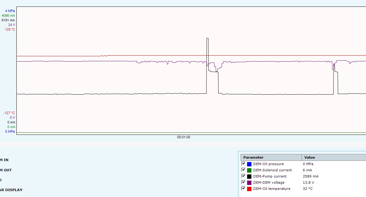

After installing a brand new 80 bar sensor and repair kit the DEM-0001 cleared but now I'm getting DEM-0007 (hydraulic pressure faulty value). The sensor reads both pressure and temperature. It reads 20C on a cold start then climbs up to 33C after a 15 minute drive.
For some reason the sensor isn't getting any pressure reading. It only reads 0Mpa. The Haldex fluid is full. I tried testing the pump with a 9V battery but got no response. Does it need 12V to turn on? The pump current is reading 2.5 to 7amps. Does that verify the pump is being activated?
The solenoid valve current never varies. Is the solenoid always fed just 6mA? I tested it with a 9V battery and the valve opened.
