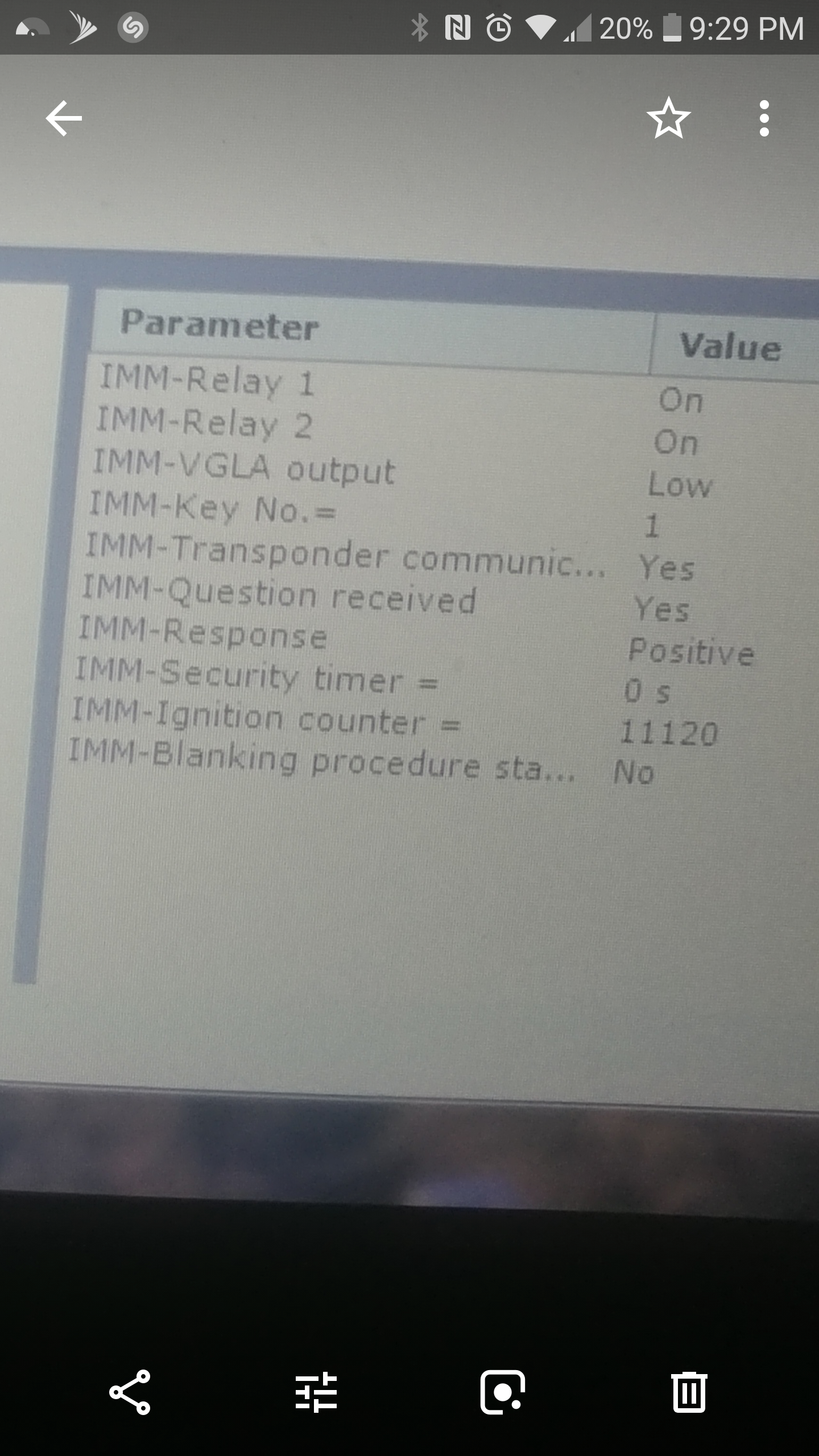

car still no start.only code is ecm-720a i checked from immm #4 to ecm# 22 circuit is good also check antenna ring connection that good .i even put on the Stabilant 22A on the pins(didt work),can i buy new immobolizer from volvo and update with vida with my old key.

It starts sometimes. If the immobilizer was the cause it would never start.
ECM-720A is a communication problem, like a bad phone connection.

well i left the immobilizer alone with the funny looking connector.got on ebay found a service center that repair ecu for 189.00 if it can be repair.after few day at repair center got a email (unit burned up circuit) and replacement is 450.00 total.paid for replacement And on saturday installed ecu put key in and it starts every time............................i hope it stay this way........................thanxz all for any info that was giving
