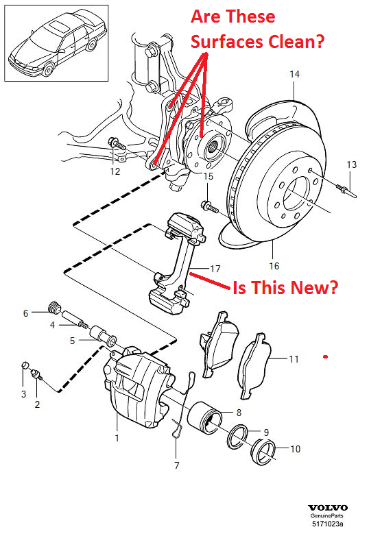

Part 17 new from last year or now while fixing noise?
So looking at the original post again till now:
1) Changed to 16" last year.
2) 16" started to make noise 6 weeks ago.
3) Changed a bunch of parts and adjusts
Assuming 1 ~ 3 is correct did the noise changed at all anytime during all the change in parts and adjustments?

Since the noise began with the old set of brakes then a part from last year which was not changed out is causing the problem. Did you hit any large pot holes or run up a curb? Alignment been checked?
Not familiar with that part but why do you suspect that unit?
