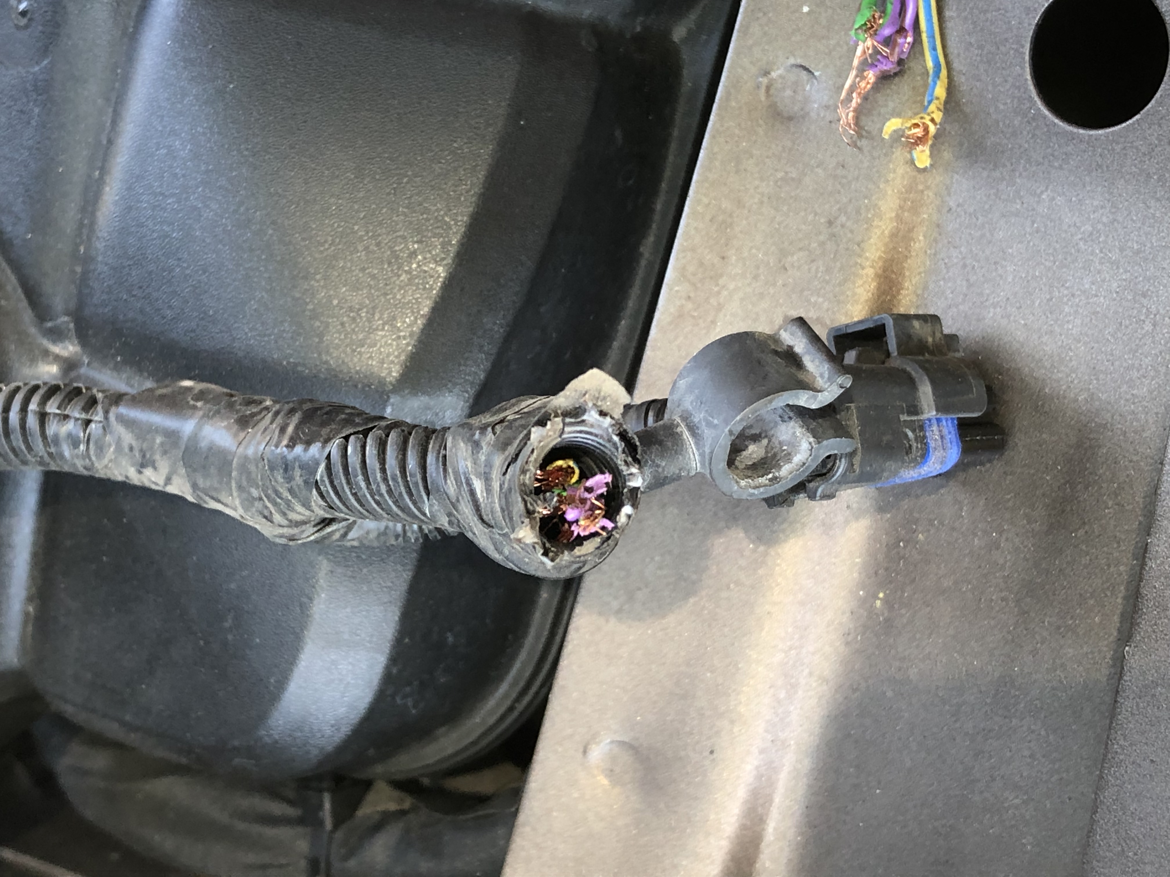

OBD2 shows P0037. O2 sensor #2. With 480 miles left on 100,000 warranty, I took it to dealer. Should be a free fix. They changed out O2 and PCV Box, and light still on. Further investigation, mechanic found this.

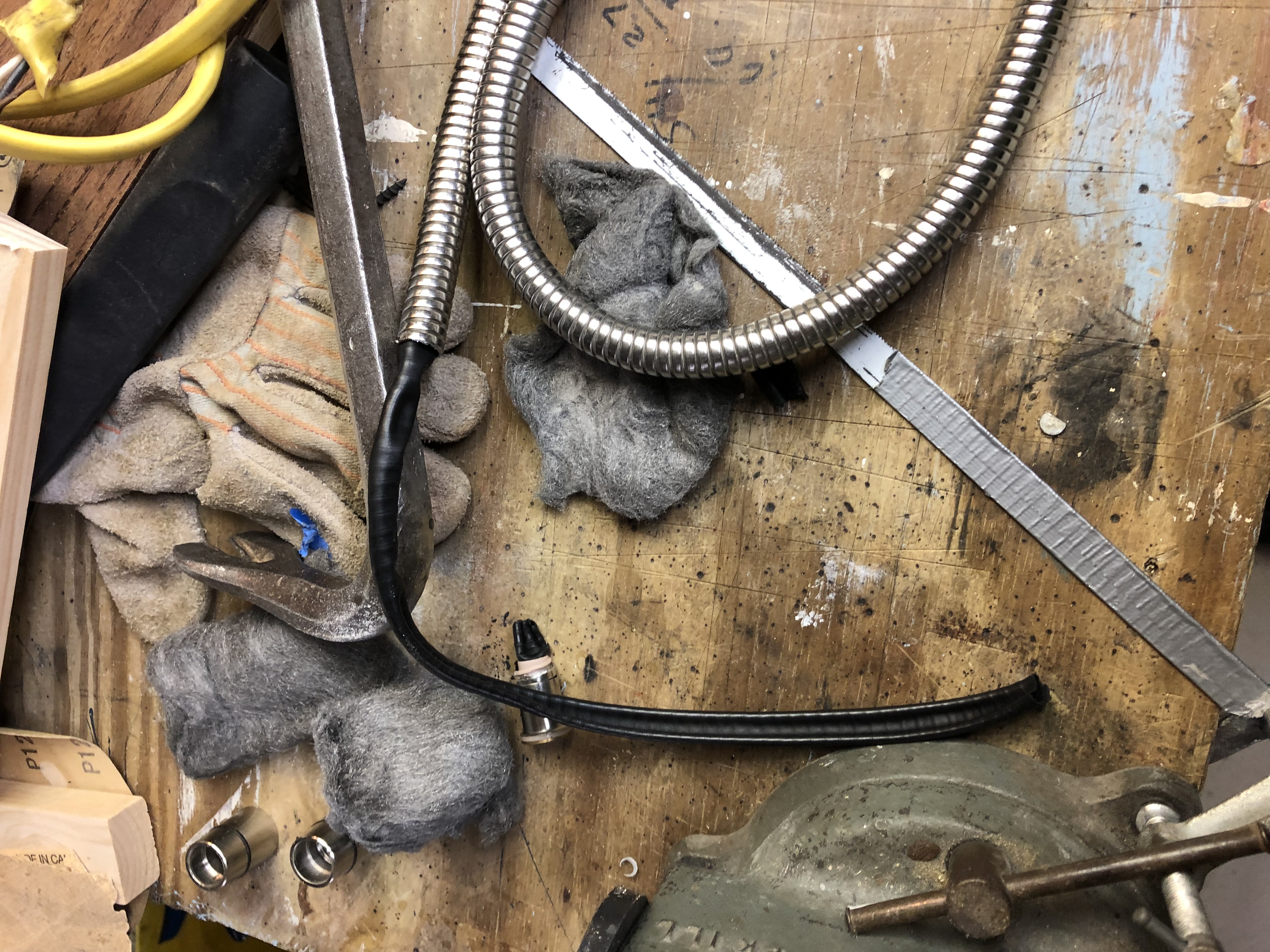

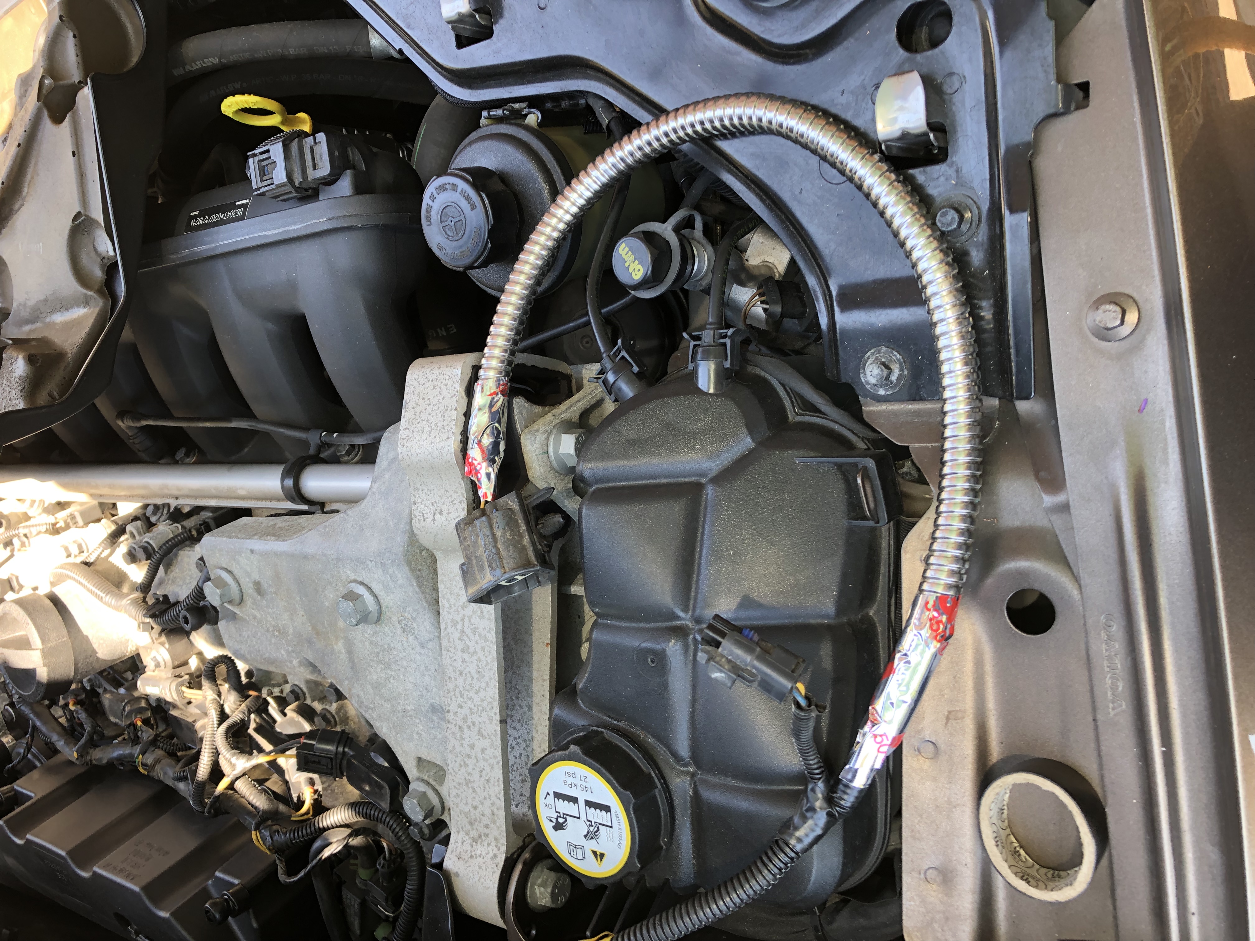

We have a city groundhog that has been here about 4 years. I have seen him in my ‘99 a few years back. Not covered under warranty. It would be $200.00 to reconnect the wires. I drove the car home and decided to fix it myself and add a little armor to the wires.
I had a stainless steel spray faucet hose laying around and figured it might slow him down.
Time will tell for the groundhog.

Running good now.
