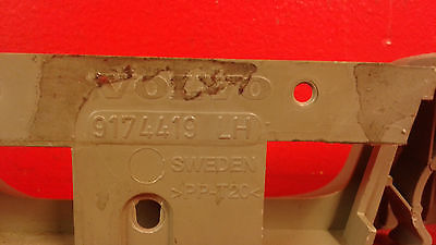

G'day guys i am currently swapping out my manual passenger (left side) seat with a powered drivers (right side) seat. i have done the easy part of switching seat bases and rails and installed the motor in the passenger backrest and also small DPDT relays to use with the factory switches...however buying the correct color trim online is proving a challenge.
i have already purchased part number 9174419 that fits but is wrong color, the seller described as being BEIGE however its grey (volvo for oak ) my trim code for my xc70 2001 is B951 (volvo for sand/beige)
Volvo have stamped 9174419 on all colors with this part , the correct part number i hope is 9196009 LH and that is not stamped on the part..that makes sense?
ALL i need to know is this LEFT side as drawing shows and does XX5X mean color sand/beige for trim code B951
