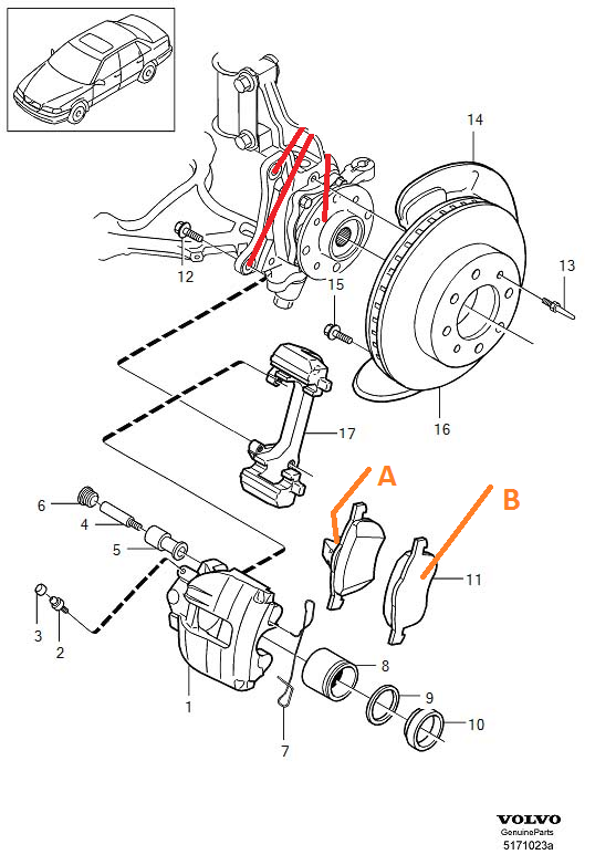

Great News! Did you put any Brake & Caliper Grease on A & B before the shims? Which side A or B did you put the shim on?
https://www.crcindustries.com/products/ ... L3301.html
C70 2000 BRAKES.png (159.61 KiB) Viewed 651 times

No grease back on A or B
Shim on both A and B
Had put plate on pads before, but the trick was to only put it only on half the pad to get an angle
