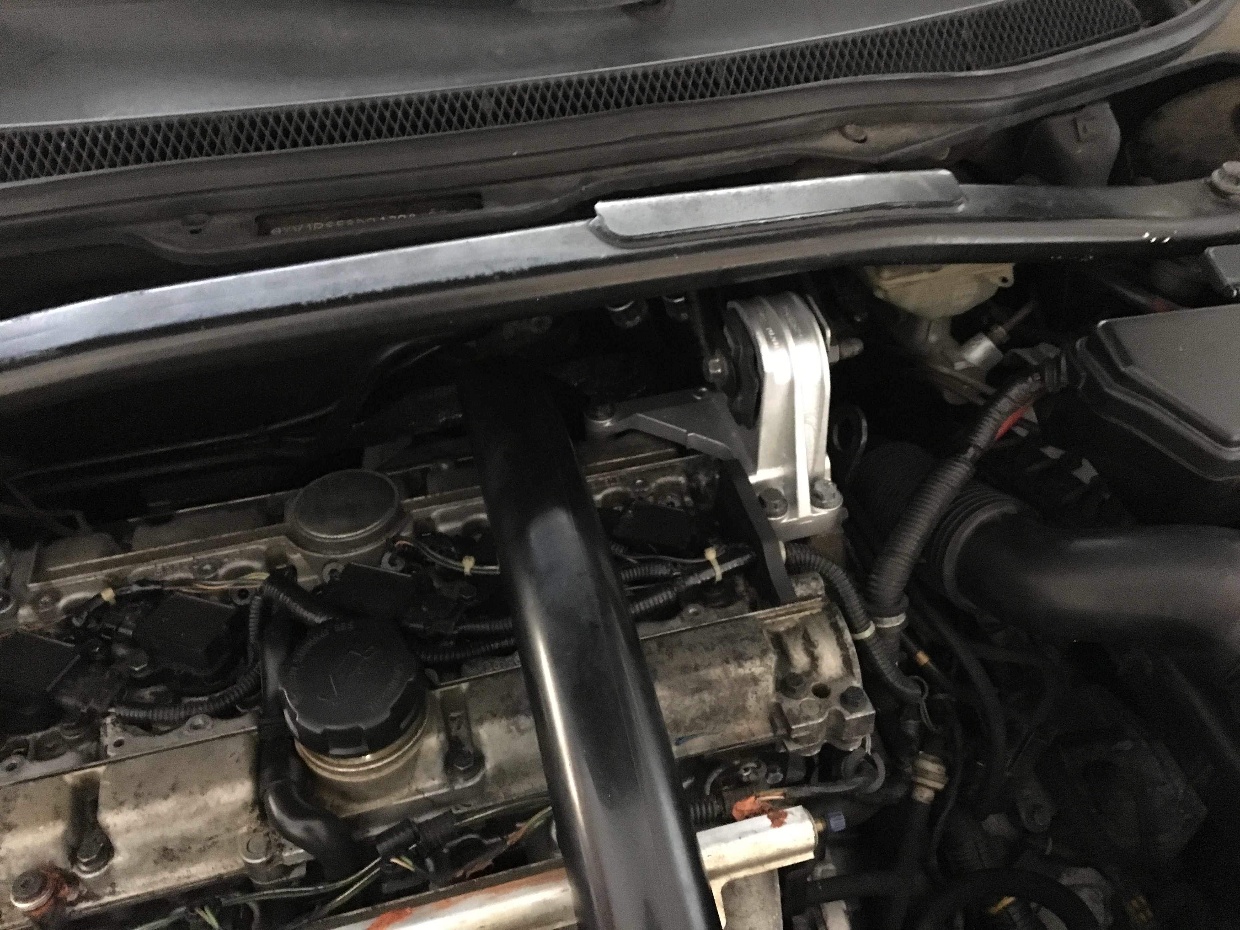

Spent the last two days cleaning the S60’s interior. It turned out pretty nice! I still need a driver door panel and a driver seat eventually, but everything else is in really nice shape.
Also received the upper torque mount today from FCP, now the strut brace is finally installed. The old bushing was completely missing when I got the car, so I couldn’t install the brace.
The new mount makes the rest of the engine bay look like crap.
Timing belt, cam seals, water pump, PCV, tires, control arm bushings, and more to come!
