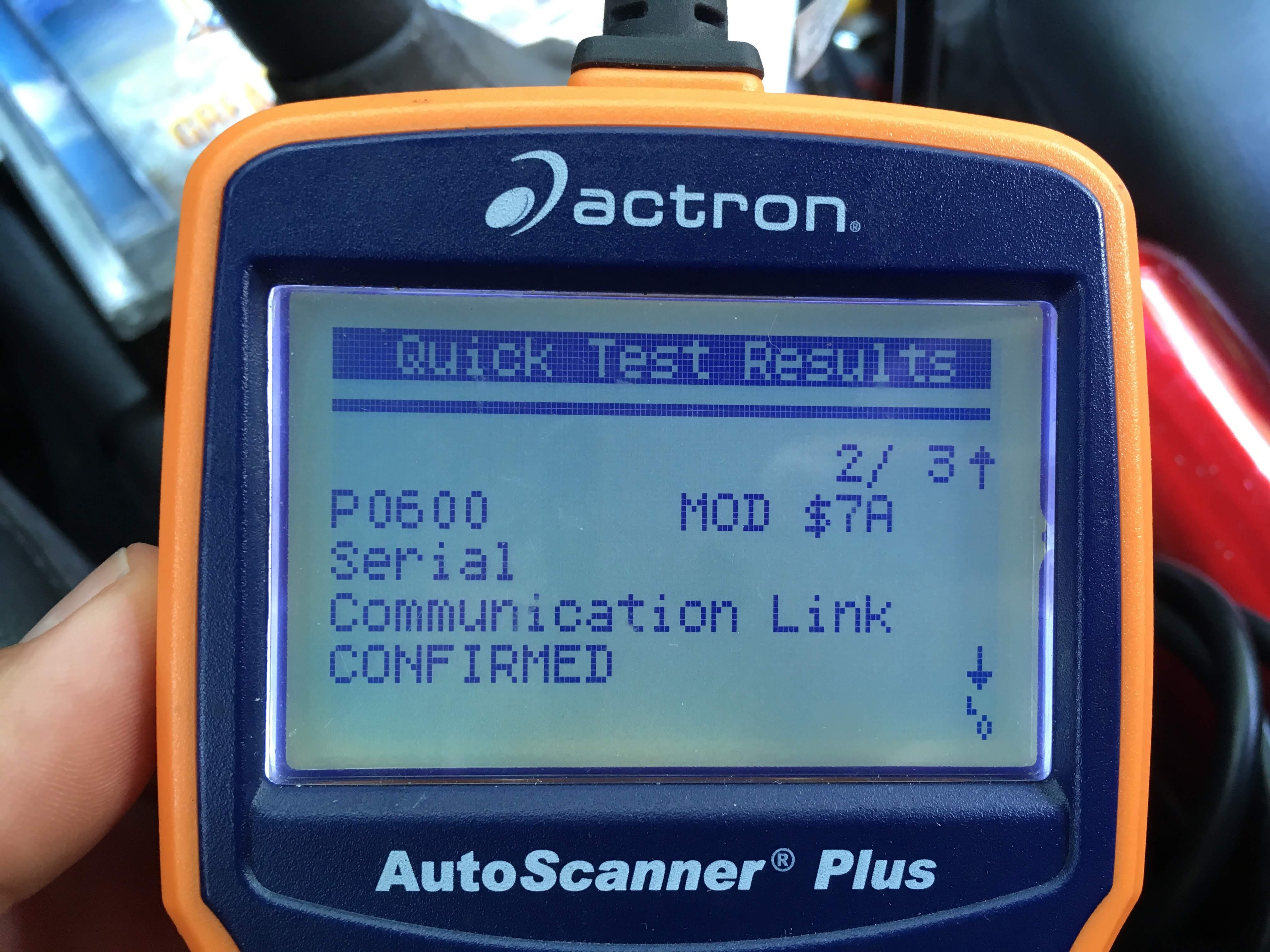

The ‘00 V70 never fails to keep me on my toes. Most recently, it’s giving me a P0600 (serial communication error).

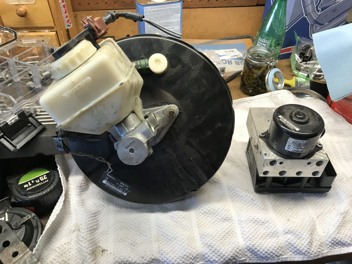

I didn’t do anything to my car yet but I picked up some parts for it today at the pick n stab. The plan was to collect a couple of pounds of BMW nuts and bolts but I stumbled upon this nice C70 convertible. Easy under 100K and a 2004. I have had some annoying brake problem for a long time now. Brakes require a lot of input force to work, pulsating feel in pedal sometimes etc. I decided to just pull it all to get the problem over and done.
Neck totally fried but the parts look awesome where they are sitting on a shelf in the garage

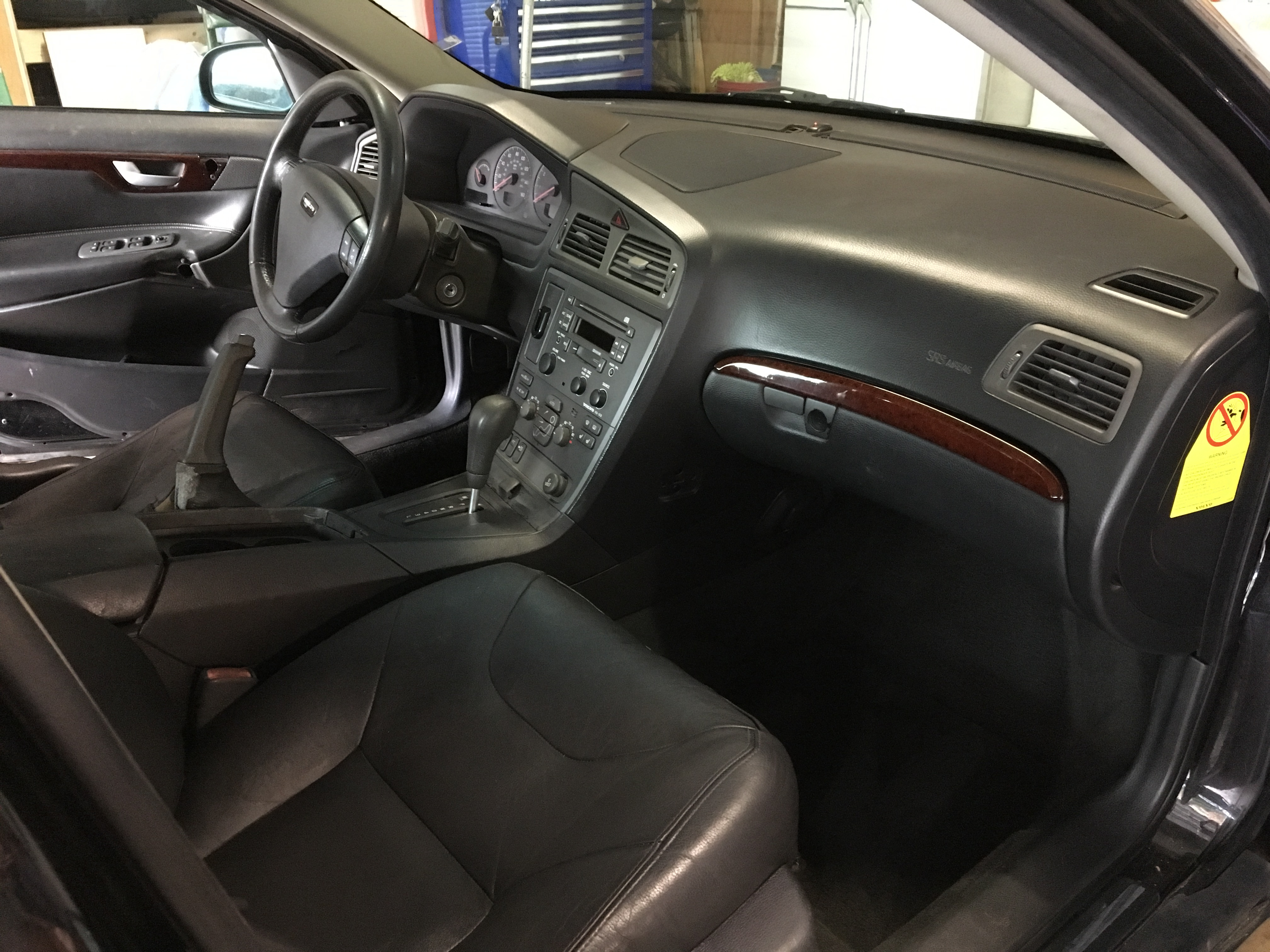

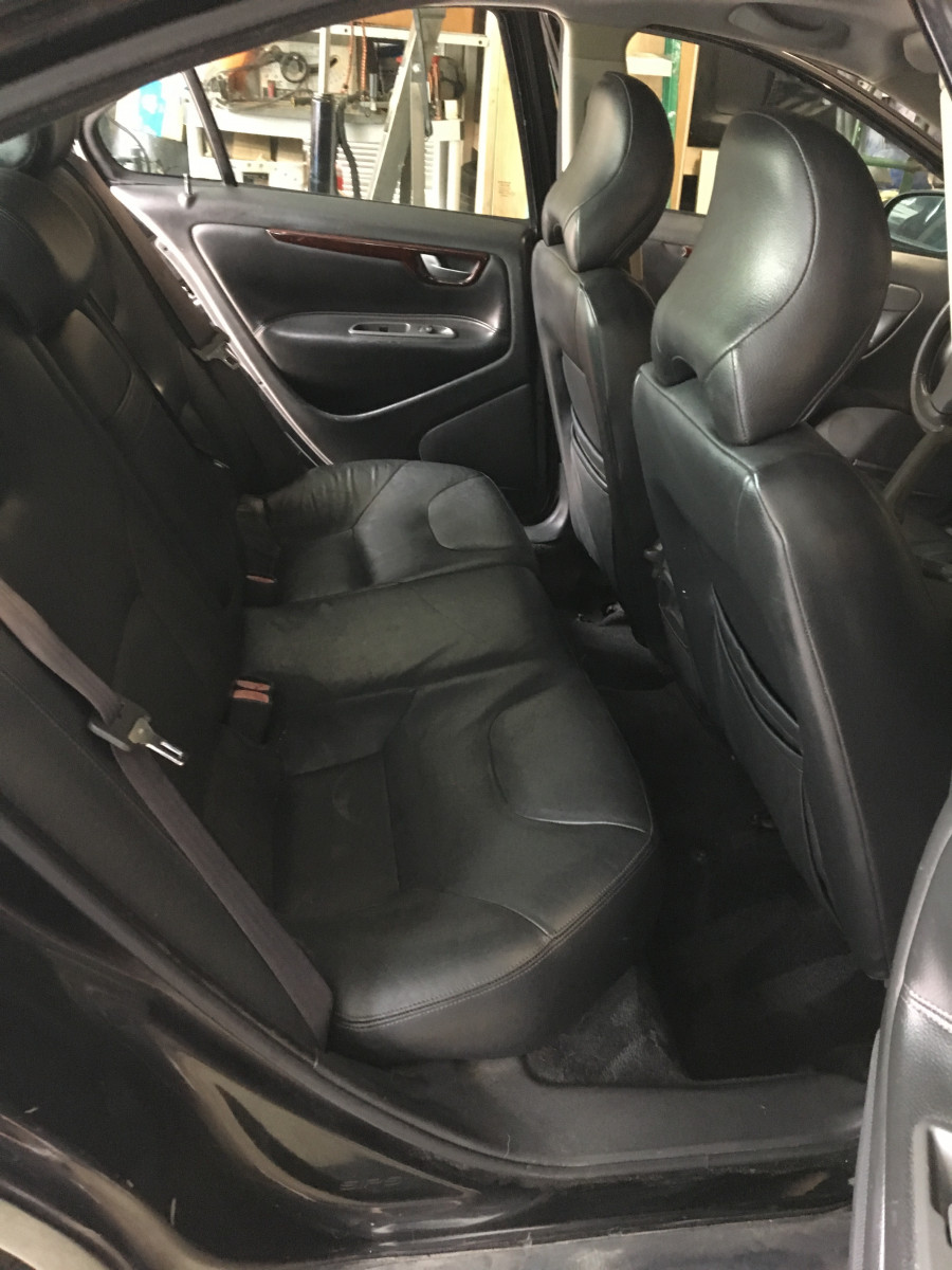

Spent the last two days cleaning the S60’s interior. It turned out pretty nice! I still need a driver door panel and a driver seat eventually, but everything else is in really nice shape.

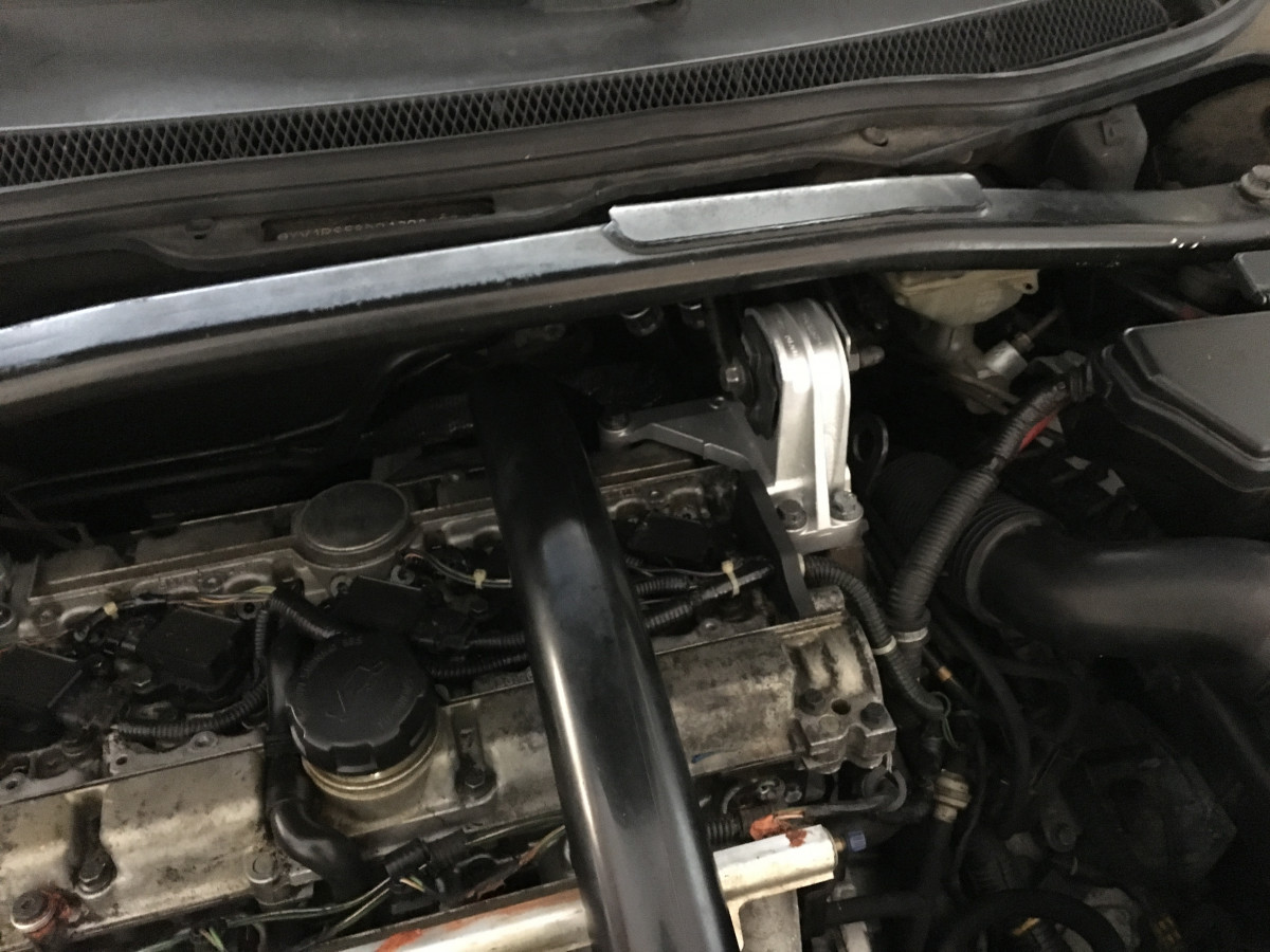

Also received the upper torque mount today from FCP, now the strut brace is finally installed. The old bushing was completely missing when I got the car, so I couldn’t install the brace.
The new mount makes the rest of the engine bay look like crap.
Timing belt, cam seals, water pump, PCV, tires, control arm bushings, and more to come!
