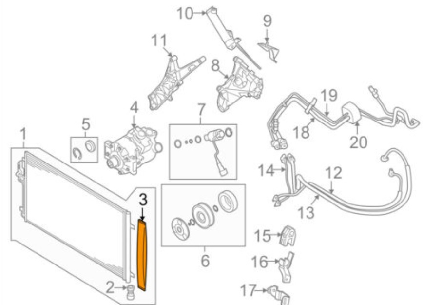

This is what I bought
GENUINE VOLVO 30776238 Receiver Drier Insert
If I had to do it again I would also replace the plastic cap witht he O-rings and filter screen at the same time (I don't have the part number handy)
Note: to replace the desiccant bag you need to lift the radiator and Fan and then lower the cross-member under the radiator. This will expose the plastic cap with the T-70 that needs to be removed. Also don't forget to remove the R134a first.

Item #2 and #3
These are what I would replace
To remove the old bag you just need needle nose pliers or small fingers
The Bag fits inside the condenser, picture not to scale.
