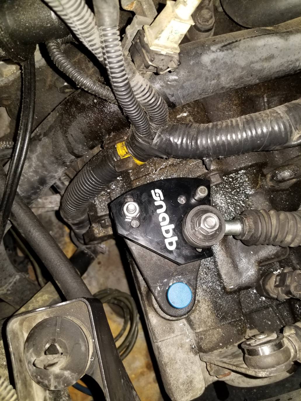

Oh and I finally installed my Snabb short shifter.
Looks great but more importantly the car shifts like a manual should. Crisp and precise. No more vaguely hunting for gears. It stays in place too which is a big plus. I HIGHLY RECOMMEND THIS MODIFICATION.

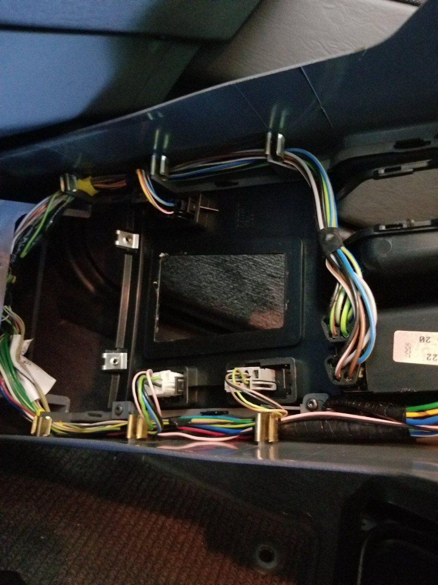

Another cool this is I found out first hand that Volvo really did prewire every car for every option. Here's the underside of my center console

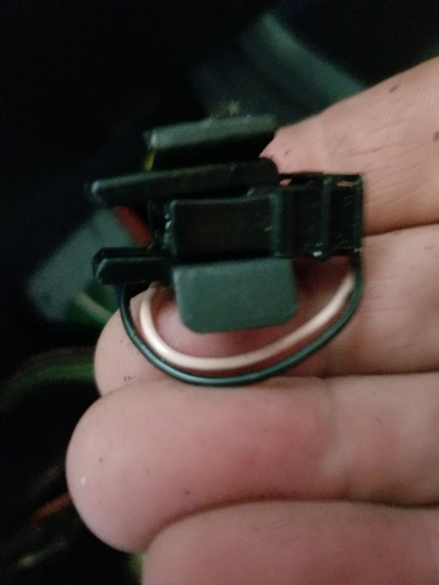

I looked under my seats and they are all wired up as well. I wonder if I could just pop in the switches and have front and rear heated seats...

I wish my turbo was wired for a passenger power seat. I pulled carpet, opened the wiring loom....nothing. Thought about wiring it to the seat heater wires.

A power passenger seat would be really nice!ZionXIX wrote: 07 Jul 2019, 19:25 I wish my turbo was wired for a passenger power seat. I pulled carpet, opened the wiring loom....nothing. Thought about wiring it to the seat heater wires.
