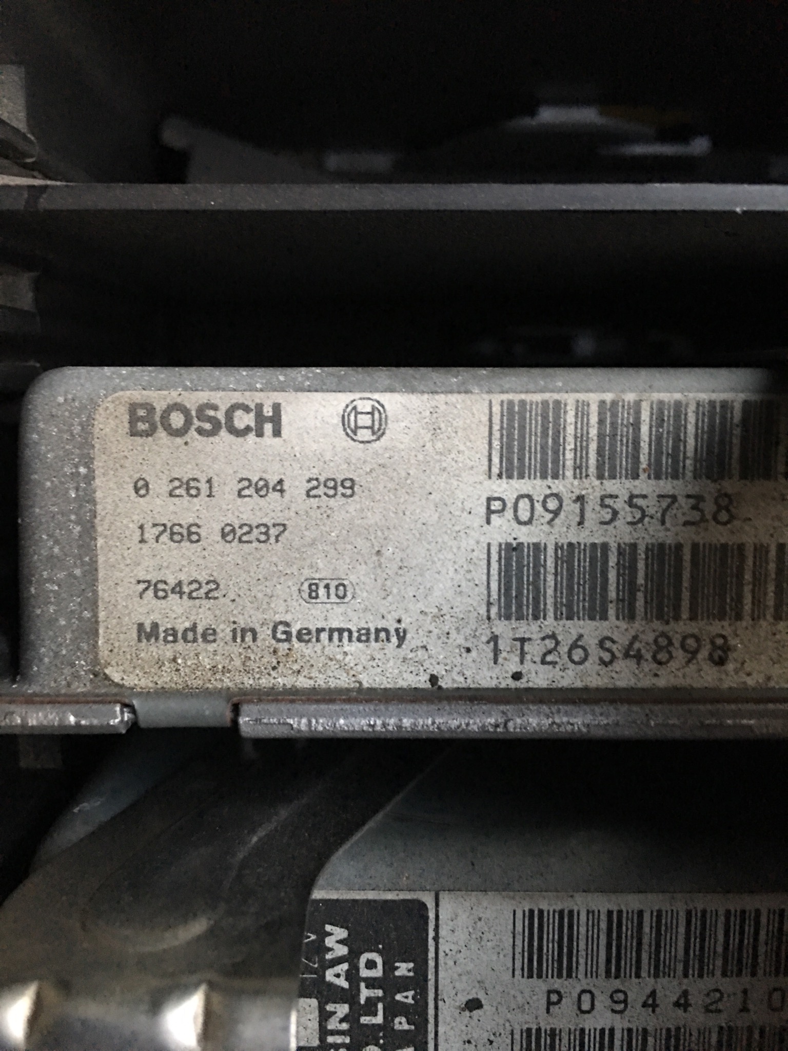

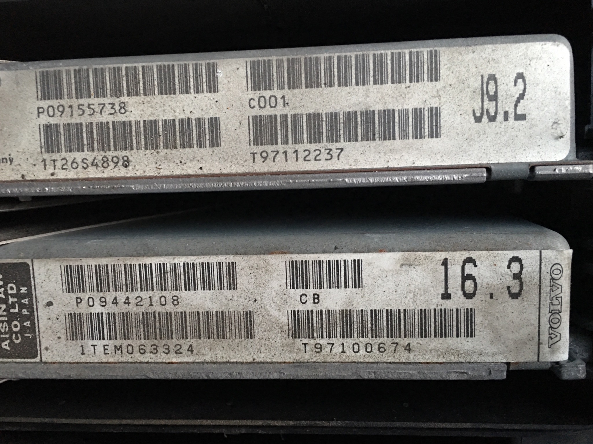

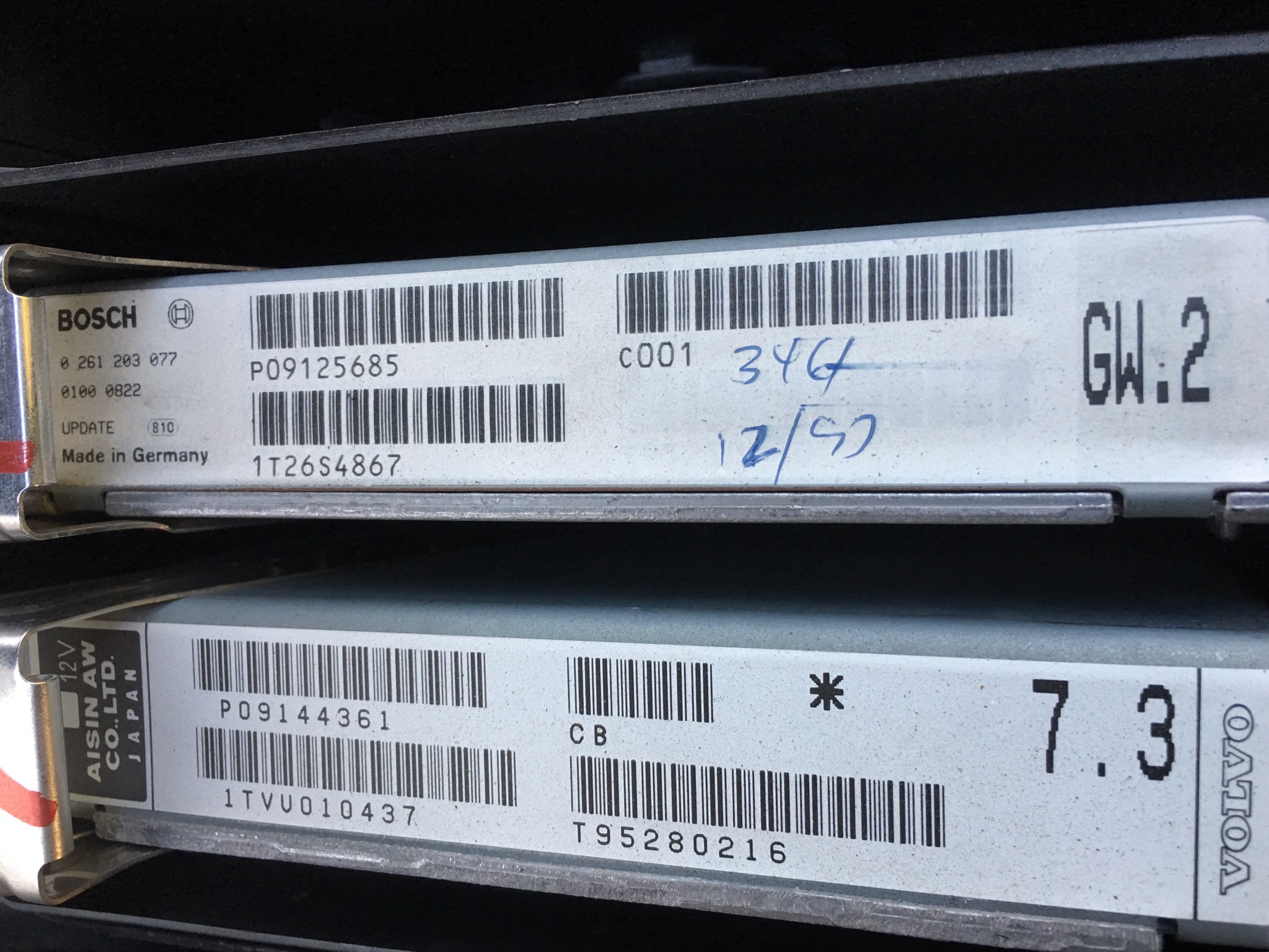

Hi everyone, I’m a little confused about the ECMs in these two cars. Photos attached.
The 98 has Bosch 261-204-299 and the 96 has 261-203-077. Interestingly the 96’s has the word “update 810” under the part number and then someone hand wrote “346, 12/97” on another part of the label.
According to the VIN comparison site provided by another user a few weeks ago, both of these base model engines “with air pump” should be running Motronic 4.4
Can anyone explain the difference between these two units and are they interchangeable? I’m parting out the 98 and I’m taking both the ECU and the transmission module, but just trying to understand what is going on here. Thanks.

So, I can't give you any definite info but the '96 NA ECU is M4.4.
One thing that may be an issue is control of the AC.
The TL;DR version is that while both the ECUs are M4.4, the AC routines are different due to the different ECC modules between the 850 and V70's. You may wind up with non-working AC in the '98 if you try and use the '96 ECU in it.

Yes, both of those are m4.4. I also don't know what the "update" . means.
OP didn't ask about the swap in this direction but it is important to clarify: Actually, using the 96 ECU in the 98 could be catastrophic, it shouldn't be done, it can be much worse than no AC if they are incompatible. An ECU for the 4.3 (or "older") wiring setup when put into 98, then the AC compressor does not turn off, and overheats, and is ruined. The 97 GLT is somewhere in between and it is not clear what is going on with the AC there.
On the other hand, the 98 ECU in the 96 (or a 97, for that matter) should be fine to test - the AC will either work normally, or not at all.

Ok so just a couple of follow up questions related to my original pictures:
The consensus is that even though the part numbers are different they are both 4.4 systems. How can you tell? What is the deciding factor to determine this?
The 98 is the one going to the junkyard, the 96 is the keeper. I’m keeping the ECU and the trans computer from the 98 regardless, but trying to determine that if I really ever needed to use either ECU or trans modules from the 98 in the 96 that I would generally be Ok. Is that a reasonable assumption?

SonicAdventure wrote: 15 Jul 2019, 23:26 ... The consensus is that even though the part numbers are different they are both 4.4 systems. How can you tell? What is the deciding factor to determine this?...
All P80 cars with air pumps run Motronic 4.4
All 1998 P80 cars run Motronic 4.4
SonicAdventure wrote: 15 Jul 2019, 23:26... The 98 is the one going to the junkyard, the 96 is the keeper. I’m keeping the ECU and the trans computer from the 98 regardless, but trying to determine that if I really ever needed to use either ECU or trans modules from the 98 in the 96 that I would generally be Ok. Is that a reasonable assumption?
Yes, reasonable. Keep in mind it is extremely rare to need to swap either ECU or TCU, they basically never go bad. But i'd probably keep them too.
