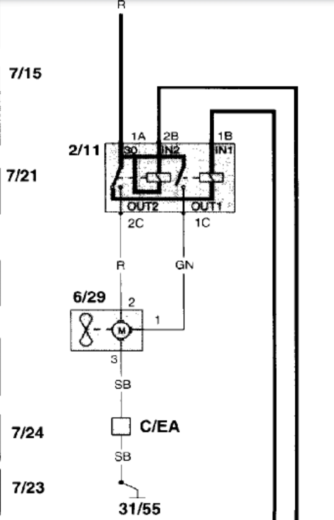

lets try to find the 1996 electrical diagram and post it up and hash it through.

All data shows this diagram for the fan cooling relay. I appears that 1 line comes directly from the positive battery terminal and 2 lines make their way to the ECU and it looks like there is a a bypass in the relay itself to the ecu. Picture from all data.

Full pdf print out

Monitor yellow wire on ECM, pin 22, to see if 12V is broken when you key off. I don't see how that could happen, but thats how you diagnose, one step at a time

Well the plot thickens. Backprobed the yellow and yellow white wires on the cooling fan relay and got 12v with key off. Pulled the ecu and found pin A22 and measured 12volts with key in all positions and off. So the ECU has power at all times. I have no idea why it has alzheimers.

You got B+ voltage right? Battery voltage to nearest 0.1V ?
- Posts: 36153
- Been thanked: 4068 times
Check voltage at Fuse 11/1 and then at pin A12 on the ECU for same voltage reading, to nearest 0,1V
Check pin A26 for battery voltage to nearest 0.1V
