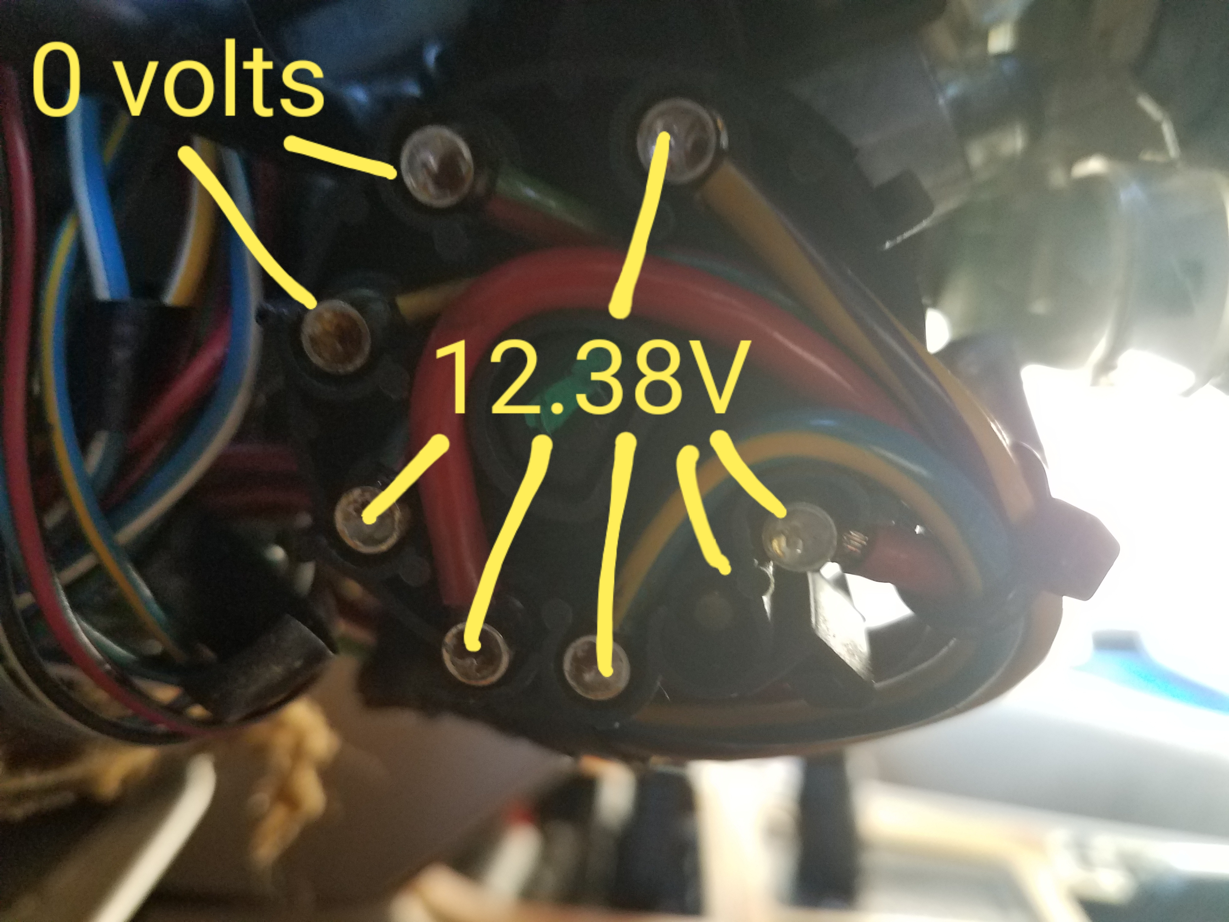

So took apart the ignition wire cover. Of course the plastic sorting piece come off and I enjoyed a little panicking since there are 7 wires and 8 pins. But I seem to have that sorted out. I'm getting battery voltage to within 0.01V at all but two of these wires. I tried to put an ohm meter between fuse number 1 and all of these wires at key off and pos II. I could not get any continuity so I suspect a relay is involved.
